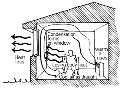

So it seems the heater has a built in thermostat. Again same with my central heating, all my radiators have TRV heads which control the radiators, the whole idea is natural thermals in a room will mean air returning to the radiator is a true indication as to room temperature. circulation3.jpg As to if that's what we want is another matter, my TRV says the room is at 17ºC and 16.3ºC, but in real terms it is more like 19ºC as I have an old TRV on the mantle place which is still reporting. Try moving a thermometer around a room and one can get many different readings depending on height and position, I know my mothers house the living room caught the sun with a bay window, and have recorded 32ºC near window and 16ºC at the back of the room at same height.

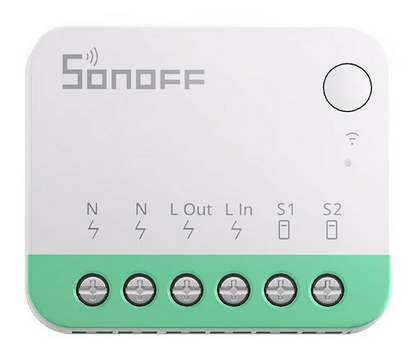

So you can get a geofencing relay, I note Energenie do one, the MIHO015, but to be frank I have turned off the geofencing on my TRV's and wall thermostat, as the room does not heat up fast enough. Using a Sonoff relay to turn the heating up/down remotely may be a good idea, these 1705111383287.pngmay well work, but clearly it needs to be put in a box some where, as it has live terminals. The data sheet is not that plain as to how the trigger wire is powered, it states 230 volt, but it seems the unit has 4 modes, off, frost, eco, comfort, and it not clear how it works all 4 with a single wire, it does say if not connected it defaults to comfort, but not how the other three are selected if not using the PW E4ZC.

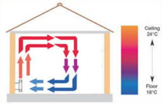

So not until I went to look after mother with a house with internal doors down stairs, did I come across a heating which did not heat the house as wanted, some rooms hot and some rooms cool. And I started to look at how a home should be heated. Pictures like this circulation2.jpgare not really helpful as today most windows are double glazed, however it does show how the heat should be on the internal wall, not next to window, and for some reason we have traditionally fitted heaters under the window, maybe because can't put furniture there? This one circulation3.jpg tries to show how it circulates and how under the heater is a good place to monitor air temperature, however the building regulations stipulate the height of the thermostat on the wall at a position where we can both see it and access it, and say it should be on opposite wall to heater, mainly one assumes as placed so high, but today the wall thermostat is more like a hub, taking demands for heat from the electronic TRV heads, but this is because we have a central heating boiler which has a minimum and maximum output, with electric panel heaters it should be simple, the thermostat is built into the heater, no need to mess around, I had something similar with my Myson fan assisted heater on my old central heating.
