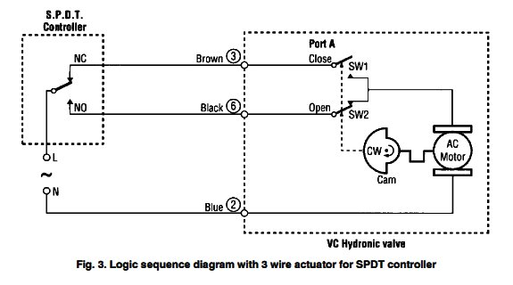

In any event, I'd forgotten this from early in the thread - an example of Honeywell using NC/NO in relation to a "SPDT Controller", which would usually/often be a stat ....

In that diagram, what does switch 1 do?
When, with the stat in the "NO" position (calling for heat), the motor has fully opened the valve, that 'switch' closes, thereby connecting the motor to the "NC" contact of the stat. That means that when the stat no longer requires heat, and returns to the "NC" position, the motor is activated to close the valve (switch 1 remaining closed until the valve is closed).
As I've said, that's more 'sophisticated' than a 'standard' motorised valve, which is simply closed ('passively') by a spring when the voltage (switched by a SPST stat) is removed.
Kind Regards, John
The switches are not rigidly connected as it looks in the diagram, then?
They have a separate cam each.
The switches are not rigidly connected as it looks in the diagram, then? They have a separate cam each.
No, they have a single cam and switch together.
When the motor has fully opened the valve, the cam operates both switches. SW2 then switches off the supply to the motor and, as per previous post, SW21 connects the motor to the "NC" contact on the stat., waiting for that contact to become live when the thermostat is 'satisfied' and therefore the motor has to run again to close the valve.
Kind Regards, John
Edit: typo corrected
Ah, like the door lock motors in Fords.
I was confused by the dotted line which looks like it is pulling both switches at once, like a diagram of a relay.
... I was confused by the dotted line which looks like it is pulling both switches at once, like a diagram of a relay.

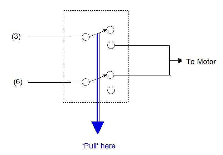

It IS 'pulling both switches at once' - when the motor has fully opened the valve, the cam 'pulls' both switches simultaneously, opening SW2 and closing SW1 (as per the 'non-pulled' switch positions shown in the diagram).
Are you sure?
Surely, the switches must be opened by oposite sides of the cam.

Are you sure?
Pretty sure, yes - otherwise it wouldn't work!
Not necessarily - it just depends on where the fixed contact is relative the the movable one which the cam 'pulls' (more likley 'pushes', I would have thought!).
Anyway, sticking with 'pulling', if the cam pulled both movable contacts towards it when 'activated', it could (if the fixed contacts were in the appropriate places) pull the movable contact of SW12 away from its fixed contact ('opening' it) whilst pulling the movable contact of SW21 towards its fixed contact ('closing' it).

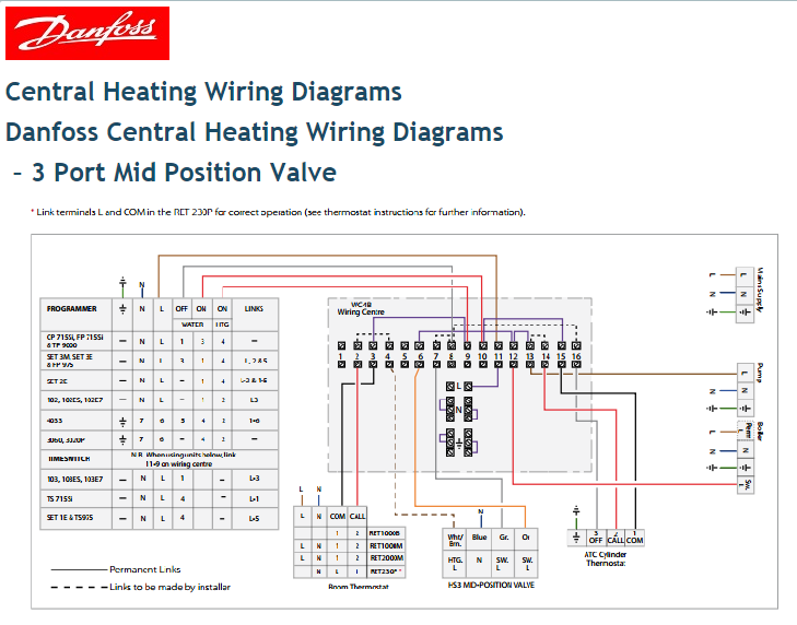

I assume that's a 2-port valve, so am I right thinking it has an additional limit switch, not shown, to start the pump and boiler only when the valve is fully open? To avoid risk of them starting when dead-headed if the valve should fail to open. Of course that's not needed with a 3-port valve (mid-position or not) as there's no way both ports can be closed at the same time.

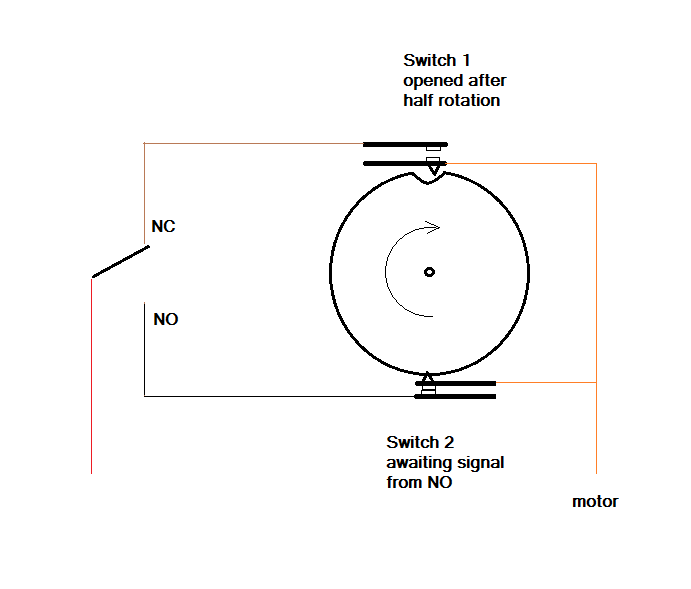

It can't be like that or switch 2 would open (as well) as soon as the cam moved.
I think something like this as clearly the diagram does not allow reversal of the motor:
