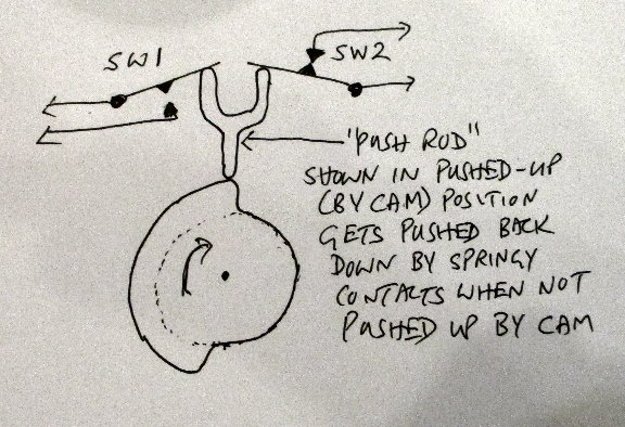

John, your diagram. It can't be like that or switch 2 would open (as well) as soon as the cam moved.
The 'pull' (as I said, I presume actually 'push') surely doesn't happen (doesn't start) until the cam has moved all the way to the 'fully open' position, at which point both switches will change state.
I think something like this as clearly the diagram does not allow reversal of the motor:...
I'm not sure what you mean - the motor never 'reverses'. Nor do I understand why you have put the two sets of contacts on the opposite sides of the cam - for it to work as I described, they both need to be 'at the same place', so that the cam operates both simultaneously.
I'll try to produce a more realistic diagram, but I might have to hand-draw (scribble) it!
Kind Regards, John
The motor cannot reverse as per that diagram, therefore the valve has to operate by the motor rotating in the same direction.
They could be at the same place, but that would need 180° offset notches, otherwise they would be both on or off at the same time.
Not if one pair of contacts was 'push for on" and the other "push for off".
As I said, I'll try to draw what I mean. Watch this space.

I don't pretend that it would be engineered quite like this, but this should illustrate the concept (with apologies for drawing and photography!) ....
Kind Regards, John
I think you are right - but it doesn't seem to me the best way to do it.
What happens when the thermostat (controller) changes half way between an operation?
Also, I've just noticed that the valve works by pushing a plunger, not rotating the valve as is usual.
They also have a spring; does this affect anything?
Oh, does hydronic mean anything in relation to the valve?
I do see downsides, and I think it is only a minority of motorised valves which use this method.
I wondered about that, although I imagine it is an extremely unlikely scenario - the 'operation' (i.e. whilst the MV motor runs) is initiated by the thermostat/controller changing state and lasts for a few seconds and I know of few, if any, thermostats which would change state for a second time within seconds. However, nothing is impossible, and should that happen (or should there be a power cut at a critical time), it looks as if the MV motor would stop, and might not start again if one did not manually contrive for the thermostat state to change. However, maybe ...
