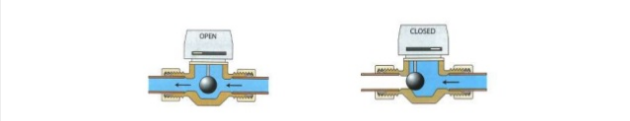

I thought the fully motorised one you described was 2-port, change from Open-close every 1/4 turn. Ball type, like you get with magnetic filters. I can envisage a 3-port valve with a similar design, it could be designed for both ports open during transition, so no need for auxiliary switch. Called transflow valves, used eg to give idiot-proof changeover between duty/standby pressure & vacuum relief valves on tanks.
Every half-turn - but, yes, that's what we've been talking about - but I personally haven't ever 'met' one of them!

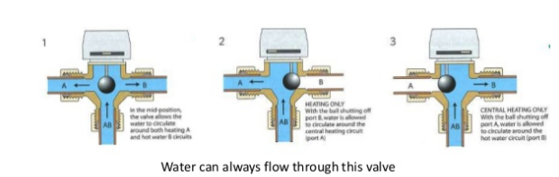

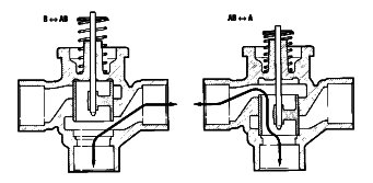

The one of which I posted a diagram seems to fall into that category - it looks as if (although not a 'ball' mechanism), both ports would be (partially) open during the transition.

Those (that one) doesn't turn; it plunges.
Ones which do turn would surely be every quarter turn.
Half a turn for the likes of a ball valve (with hole through) would be the same - either open again or closed again.
Some have balls as fixitflav mentioned
The balls themseves do not rotate but the lever control does but it moves very little.

Some have balls as fixitflav mentioned ... The balls themseves do not rotate but the lever control does but it moves very little.
With those such as in your photo, as you say, there will be relatively little 'rotation' of the control spindle. The exact angular movement will depend on the length of the control arm, the diameter of the ball and the distance between ports, but it will certainly be less than half a turn, and quite possibly less than quarter of a turn.
I haven't yet taken it apart, but the manual control lever of the 2-port one I've just tested (which has a 'moving ball' that can be seen through the ports) moves by about 30°, maybe less, but it may well be geared.

...but, for the usual 3 port valves, the ball has to be held in the middle position for both ports to be open, so they do have an additional switch.
Just noticed this post. That's right for the mid-position valve, but the additional switch is to stop the motor at mid-position. I meant a switch to start the pump and boiler, for safety reasons. The either/or valve, with body style as your #70, doesn't have either switch.
