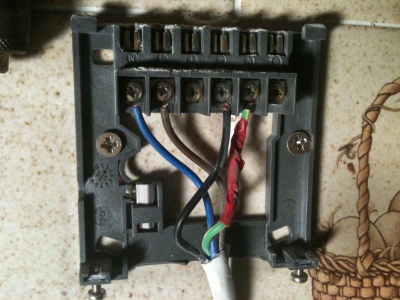

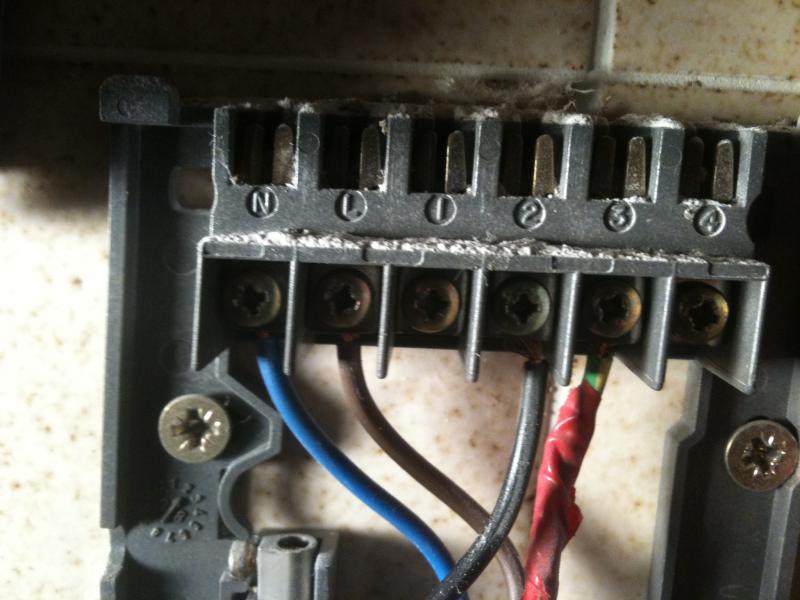

Hi
I have a Baxi Bahama combi boiler that is wired to a frame for a wireless receiver for CH that has been removed an binned along with the thermostat, as picture shows. N blue, L brown, 2 Black (what is this?) and assuming 3 switch. Can anyone advise on what type of wireless thermostat/receiver I can replace it with? I'm a little confused by the 3 wire/4 wire/volt free descriptions on a lot of them. Any help would be great as I'm loath to pay someone to wire this up for me.
It looks (horribly) to me that some cowboy has used the earth conductor as one of the signalling conductors.
If so this is very, very wrong and it needs sorting out before your wireless stat is installed.
Needs a picture of how many cables are providing those wires (cannot see from the picture) and also what is on the other end.

Wow thanks for quick response although not quite what I wanted to hear. Its a single 4 core cable.

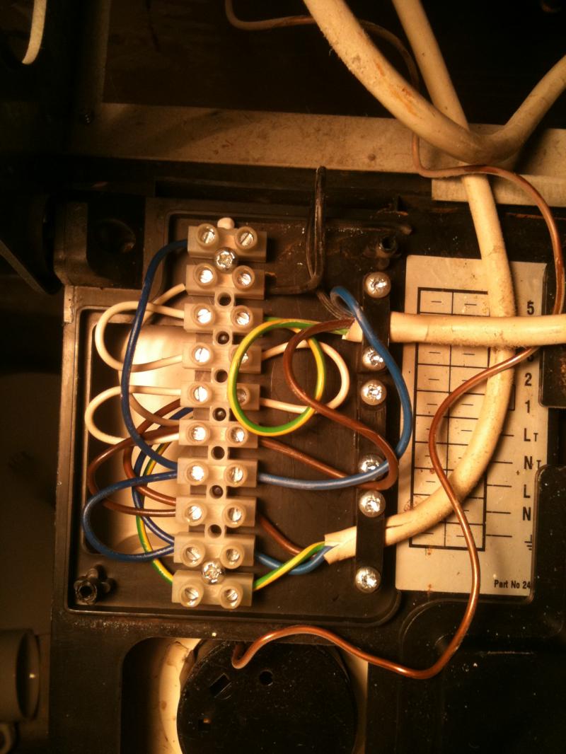

Here's t'other end. Top is same, bottom is from boiler.
There are different ways to connect different stats for different applications. You will get a wiring diagram with the new stat. This should give you an option to use your exsisting cable without any problem. You may have to sleeve the earth core properly.
Just to reinforce the above.
If you use the existing cable, the earth conductor must be connected only to earth. That gives you 3 cores to connect your wireless stat. That may be enough for your system depending on your heating plan and the stat type.
If you mount the wireless receiver will be close to the wiring connection centre there will be nothing to stop you running in an additional cable, if needed.
EDIT: I just had a look at your picture of the wiring centre. The earth wire has been used to carry the permanent live to the stat location.
This is not necessary as it can be looped in the stat backplate. That will leave the green/yellow to do the job it is intended for (EARTH).

You can use that 4 core cable with any wireless thermostat.
At the boiler end remove the green/yellow and put it with the other green/yellow (presumably from a spur or plugtop).
Remove the green/yellow at the backplate, remove the sleeving, and terminate it in a small connector block.
