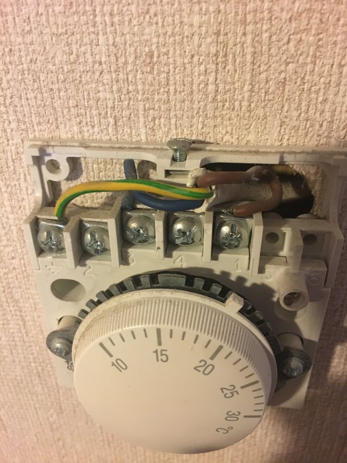

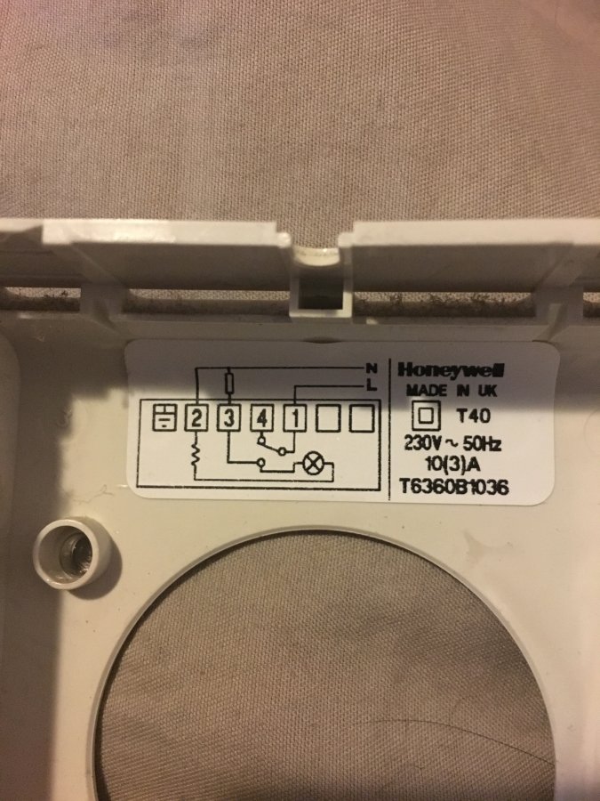

I have a Honweywell Thermostat in my Static Caravan. I would like to install a smart Stat that can change the temp at different times of the day. See photos, it looks to me that the current Stat has L, N and Earth all the smart ones seem to be dry contact. Can anyone offer some guidance?

Dry contact is exactly what you need.
Make sure your JB25 is not the Modairflow or system ET variants; otherwise a unique J*S thermistastat is required.
Thanks, so silly question is, how do I check what variant it is. I just took the details from the front of the unit,
If it doesn't list either on the data plate/front panel, then it isn't that version.
I'd recommend a stat from the Honeywell connected range.
