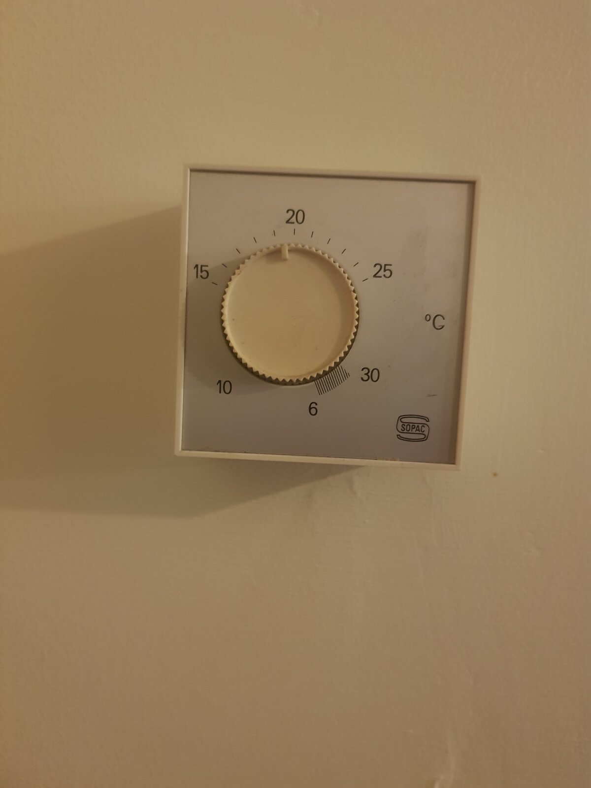

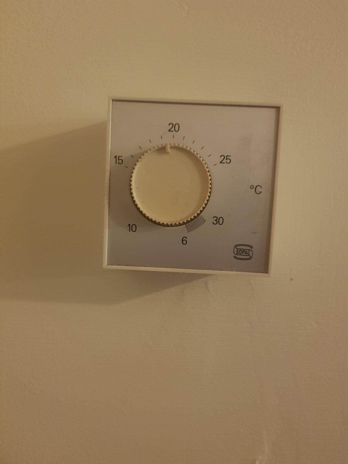

Hi,
So we have a traditional heating system still with the attached thermostat .
our gas engineer thinks the boiler is 25Yrs + old so im guessing the thermostat is original to the heating system when first installed .
Whilst the boiler is still in good working order (touch wood) we wont be changing it out yet.
But my question is Would it be worth getting a new Thermostat ?This one seems to click on and off when turning the dial always around the 17-18 degrees mark.
Not sure if its working as it should /
Any advice would be welcome and which one should i get if i had to change it out .
Regards
Martin
Mechanical thermostats do wear with age and become less accurate. There are several types you can replace it with.
1. Mechanical dial type as you have now (eg Honeywell T6360) - Ideally there should be a neutral connection made to most dial thermostats to improve accuracy but it's not always installed. If you go down this route, best to check this first.
2. Battery operated type with a digital display (eg Honeywell DT90E)
3. Mains powered thermostat.
This would necessitate a neutral connection being available at the thermostat
4. A programmable thermostat. This allows different temperatures to be set at different times. However the existing heating timeswitch becomes redundant and would need to be set to be 'on' permanently. (eg Dayton Digistat+3) Battery and mains versions are available.
5. Smart thermostat; allows control of the heating from an app (eg Tado wired thermostat)
You do not want a wireless thermostat. They are for installations that don't have erm....existing wiring
It you were to search online and find a thermostat you like and then post back someone will be able to advise if it will be suitable or not. You may have to check the existing thermostat to see if the neutral connection is present or not. Analogue thermostats will work without a neutral, but not as well as they could.
As with most things you get what you pay for so I would avoid cheap devices.

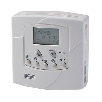

@stem has given a really good answer, much depends on what the thermostat is used for, old house central heating went in around 1985, few tweaks since, and I used a battery power thermostat like this ae235.jpg for years, the first one was easier to use, but had a problem after around 10 years with poor battery contacts, so changed to one shown, which I will admit I some times need to read box again to work out how to alter temperature, batteries last around 2 years, I replace once a year to be on safe side. Just two wires, so no real problem changing. Cost around £35 and programmable so I tended to set and forget.

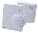

I must admit the Nest Hot water boost.jpg is easy to use, it is intuitive, never need to read the book, want it warmer turn the dial, simple, and the Nest e is about the only smart thermostat which is 2 wire connection, plus USB I think for the remote bit. But the old Honeywell 84067_P.jpg does need a neutral but is also simple to use, it has fail safe, i.e. if battery goes flat it turns off, the batteries last around 3 years, and it uses a mark/space system to stop over shooting, i.e. as the target temperature is approached it starts to turn boiler off/on slowly increasing off time, and works well with old boilers, useless with new modulating boilers as that mark/space system results in boiler running inefficient, but with old boilers it increases efficiency.
