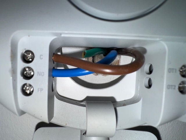

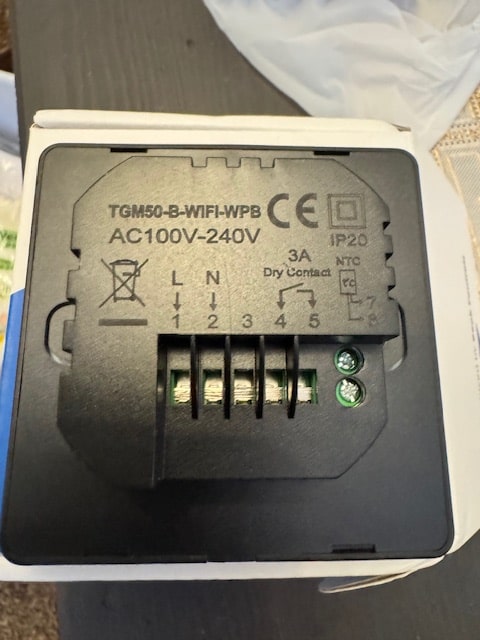

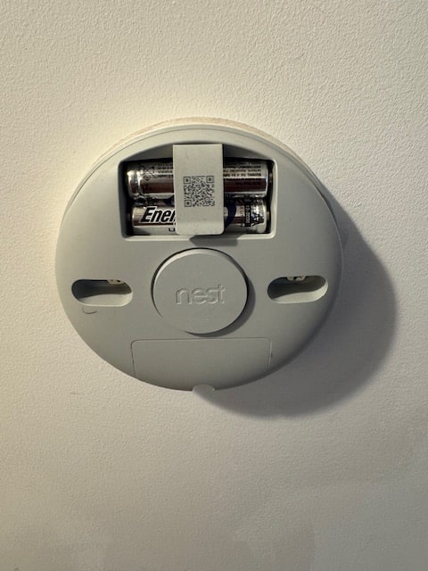

Thermostat starting acting up and switching on/off randomly so I ordered one off ebay but without doing any research :) Can someone please let me know if its possible to install the new one given my set up? Images below
Current one is just this switch which connects to the Google nest hub
No, unless you have extra wires behind that con connect elsewhere or can run new cable. You’d need a permanent live and permanent neutral plus those 2 switch wires. Better with just another battery operated one tbh.
Does that mean only battery operated units will work with this set up? Unless I want to do additional wiring? What is the third wire for in the current set up? I see its not connected to anything

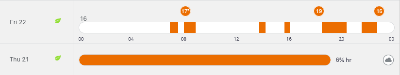

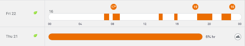

I found Nest Gen 3 had a load of extras which could be turned off, it was supposed to learn, I found it built up a silly schedule so turned it off, it was also supposed to have geofencing, again it did not allow you to set distance, so turned it off, also anti legionaries which Nest e will not have.

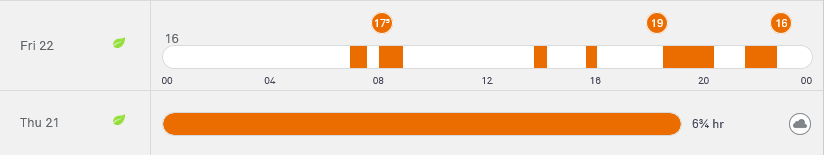

It can show when and how long it ran for 1732369189394.png Friday, showing when and Thursday how long. In my case useless, as running Wiser in parallel, but should be easy enough to find out what it is doing wrong. And likely can be corrected.

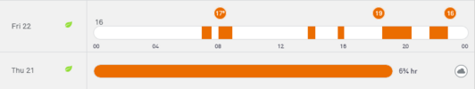

It can show when and how long it ran for View attachment 363818 Friday, showing when and Thursday how long. In my case useless, as running Wiser in parallel, but should be easy enough to find out what it is doing wrong. And likely can be corrected.

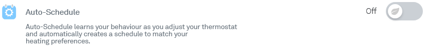

View attachment 363820 Here is an example of the bits you can turn off.
