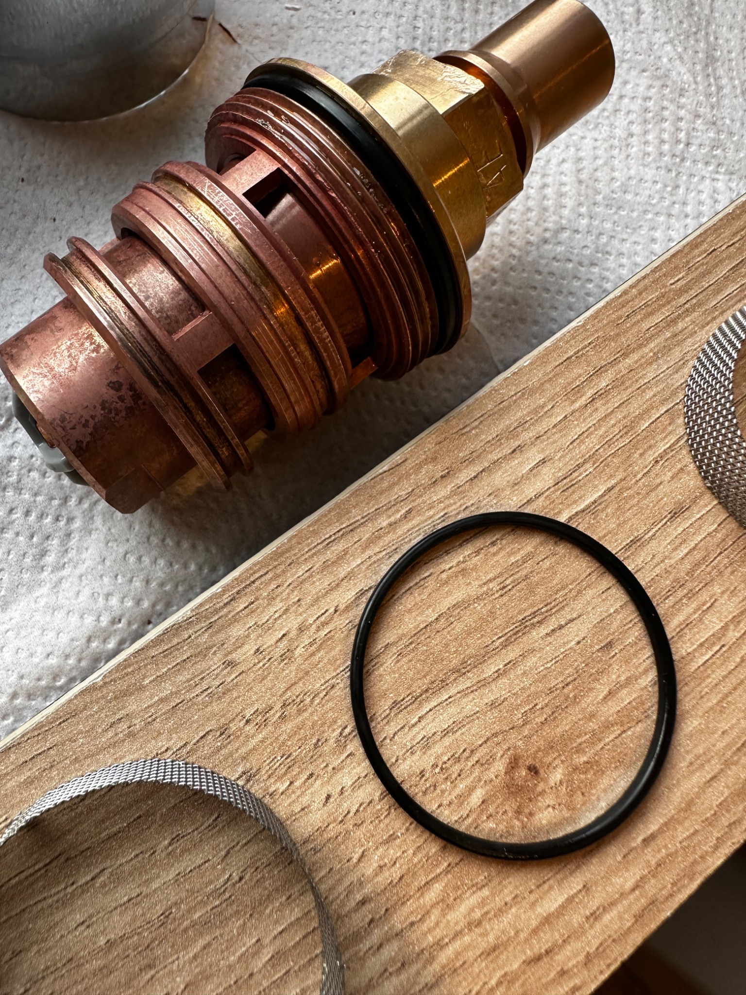

Hi there - I’ve been having some trouble with a mixer shower; no hot water.
The shower has not been used for a while - I’ve removed the thermo-cartridge and cleaned out the gritty bits.
I’ve soaked cartridge for couple of hours in a citric acid solution.
I’m now getting hot through but as I adjust the temperature it thumps (like a single water hammer) as the hot comes in.
I’m guessing it’s now moving but sticking - is there anyway I can free it off ?
I believe it’s a Trevi 300 shower.
Thanks in advance D

@denso13 - I’ve changed the thermo-cartridge (for a genuine new part) with mixed results.
The good; it’s smoother and the hot/cold transition ’thump’ has gone.
The not so good; the max temperature is notably cooler (tepid/warm at best).
If I turn off the cold isolation valve when shower on - the hot comes through at the v.hot temperature you’d expect.
But when I switch the cold in again, it quickly brings the temperature down to tepid again.

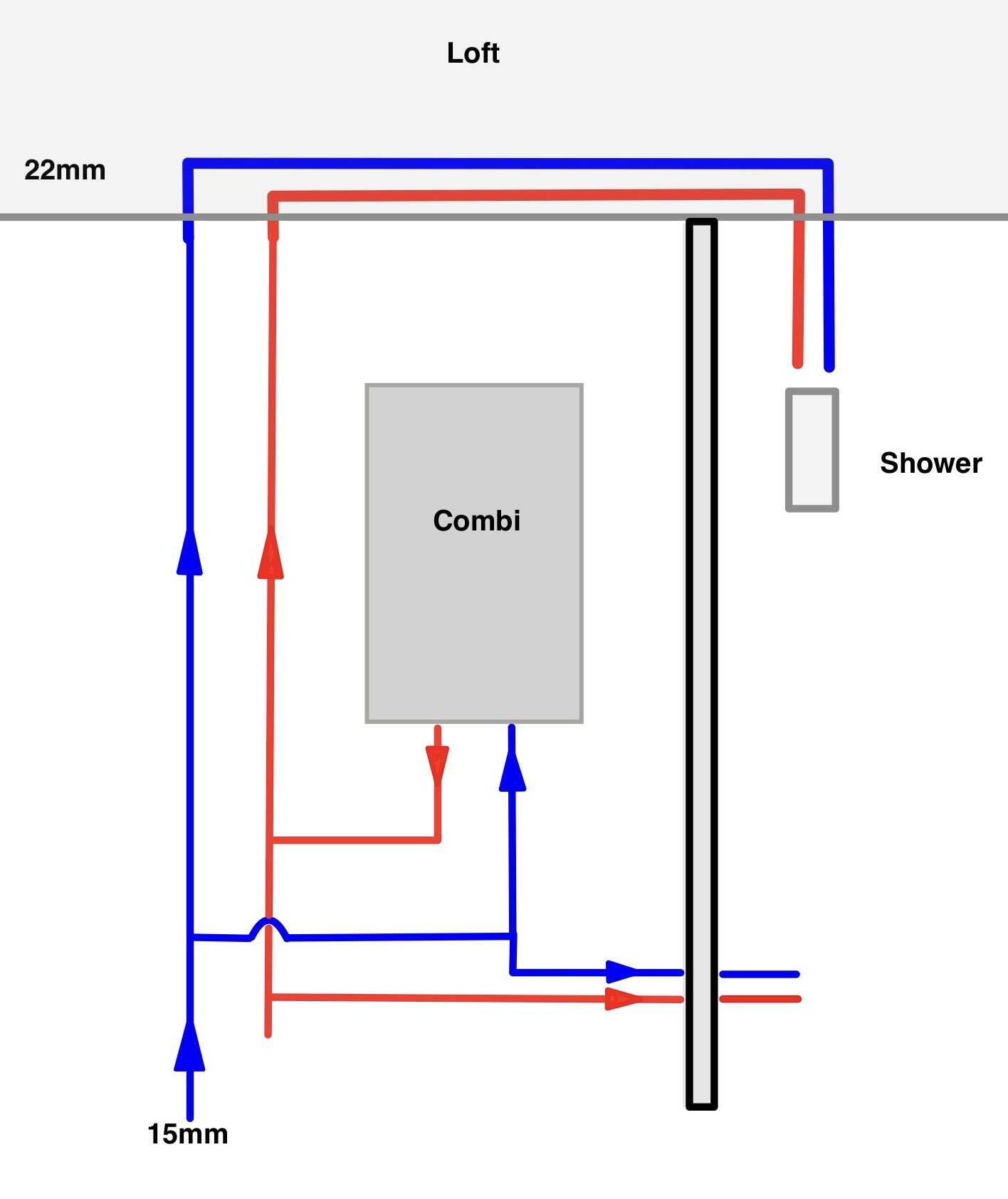

I’m still wondering if this is a balance issue.
When the shower was previously connected to old vented boiler it had a Monsoon pump so would have had a balanced supply.
If I look at my new COMBI boiler pipework in adjacent airing cupboard, the cold feed to shower is noticeably more direct.
The instructions recommend a ‘reasonably balanced’ supply but then go on to say it can cope with 5:1.
Might this be causing an issue / could I try PRVs or similar on the 22mm supply pipes.
I’m probably going to cut into them to add some back flow check valves.
Thanks D
A combi has balanced supplies, both mains fed, doubt it's that. Do you know what pressure the mains is?

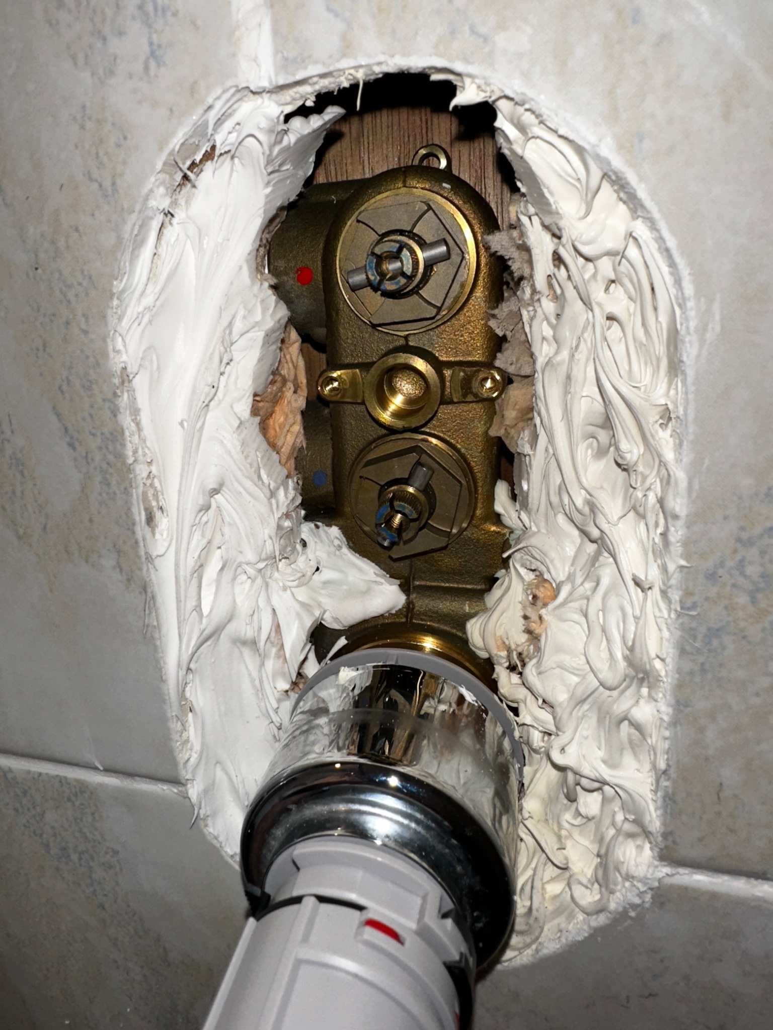

I may have figured this out…….
I removed the gear/clutch wheels - everything looked fine.
I didn’t go as far as removing the H/C cartridges because I needed a deep (22mm ?) socket.
One cartridge feels a tad tighter to rotate than the other but I could still turn the gear wheel with my fingers so it wasn’t that bad.
To get the gearbox cover off I needed to remove the goops of silicone sealant - this exposed the red a blue manifold dots.
I opened the hot isolation (airing cupboard) valve and gave the (red) hot gear wheel a twiddle - nothing happened.
So I gave the (blue) cold gear wheel a twiddle and hot water came out !
I think that during the installation of my new Combi boiler - the shower has been hooked up back to front.
