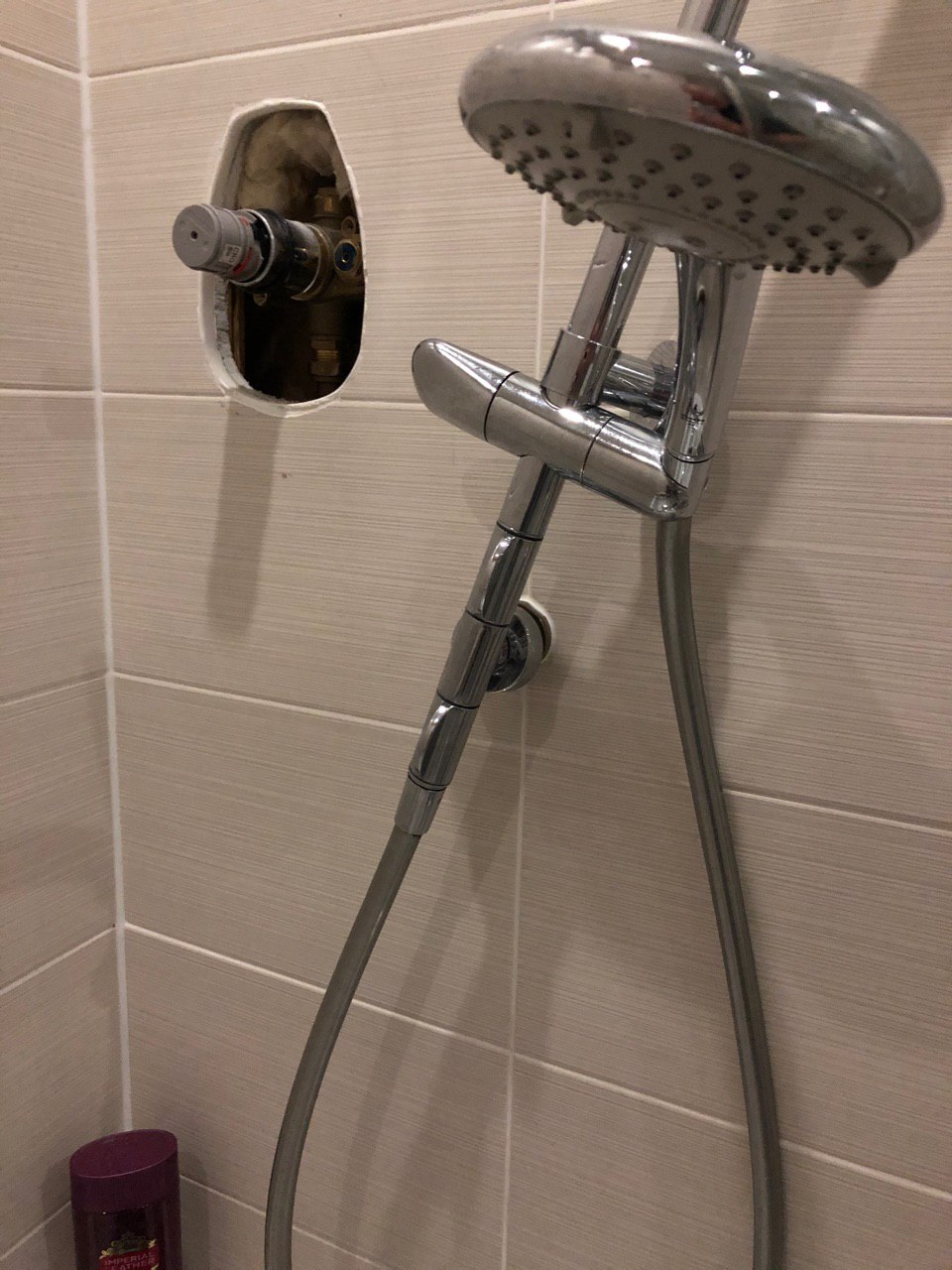

I hope someone can offer me some advice.
Currently in our bathroom we have an Ideal Trevi Moonshadow shower (
https://www.showerdoc.com/ideal-tre...shower-kit-l7064aa/question/new-shower-204916)

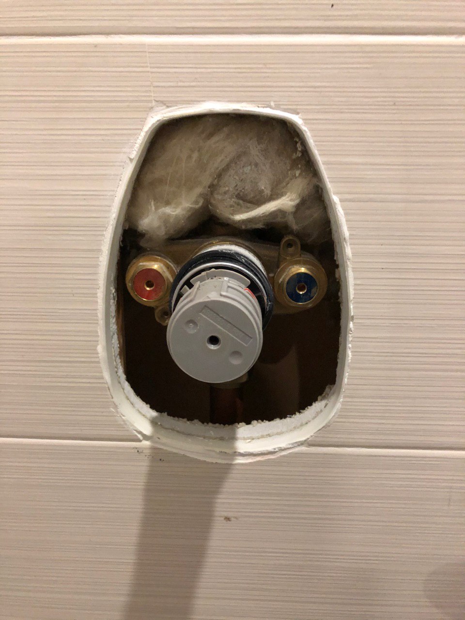

Now the shower in question controls the flow of water but has a separate concealed temperature control valve which I've included images of.
Problem we have is the the flow controls on the shower are seizing (
https://www.showerdoc.com/trevi-t-valve-complete-for-l7064aa-e960738aa#frequently_asked_questions) and there's no way to replace the individual part anymore. Ideal Standard have a new shower which looks the same (
https://www.ideal-standard.co.uk/product-details/dual-rainshower-m1/A5689.html) but it expects the flow controls to be concealed alongside the temperature.
Question is, can I buy a shower that matches what I had previously or am I looking at a situation where I have to install a concealed flow/temperature valve and a new shower? That would be a nightmare as I'd have to find one that matches the existing hole.
Any advice is more than welcome.
Thanks very much!

Thanks folks.
Just incase someone else comes across this thread with a similar problem. Ideal Standard confirmed that they don't make a comparable shower anymore but that they stock the part above and replacement handles.
That said, I decided to see if I'd have any luck in just taking it apart. When I did it was quickly apparent limescale build up was the problem. I bathed the parts in remover, cleaned with a tooth brush, then used some copper grease when putting it all back together. Bit of a faff but happy to say everything is working as expected.

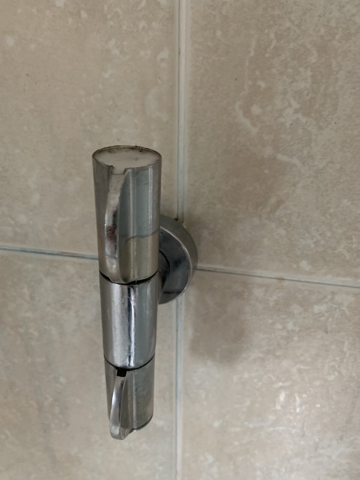

Thanks for your reply Chris. Please see attached image. So I first I would try and clear limescale without taking the fixture off the wall, and avoid having to turn mains water off and drain system. I can do this tmw but first wanted to check whether this piece broke down any further than this please (do the actual turning flow control parts come off for instance).
Grand. So you’re talking about taking that part off the wall? If so just pull the cover at the wall forward and it’ll reveal a brass fitting. I used a large adjustable wrench to remove it. The top and bottom flippers should also just pull up/down and off. The limescale may be given resistance.
Though if memory serves me you might be able to just twist it counter clockwise.
