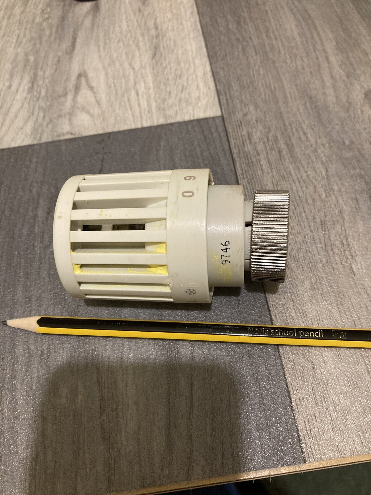

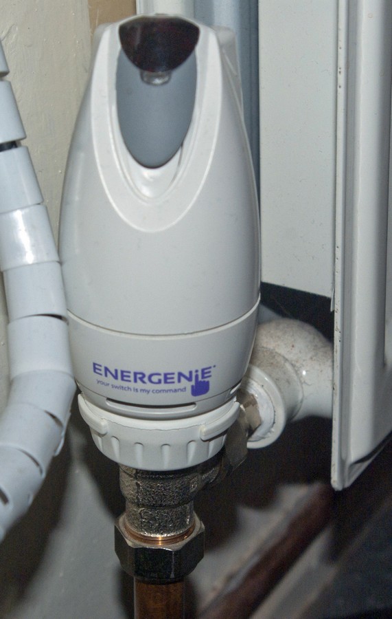

Could you tell me if these TRV tops can be changed for any modern version ... are they a universal fitting or is it that the valves need changing as well
Thank you for your help
Ray

They should be interchangeable with most. Whether you need to change the valve depends on whether the pin is sticking or not
Thank you … just thinking of changing them from a cosmetic point of view, half the radiators have had new valves fitted.

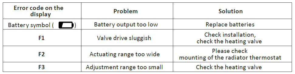

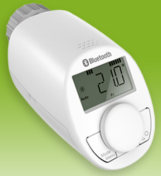

I have most which are M30 x 1.5 mm which I have fitted eQ-3 heads on them so programmed for times of day in use, but I have 4 odd ones which seem to be a larger thread. They are designed to adjust for different pin travel and have a fault display if there is a problem.
But with non electronic the pin travel needs to be correct, mine cost £15 each in 2019, pre-brexit, I had to buy on internet, and got the bluetooth version. 61dmtMm13BL.jpg There is also the Terrier i30 which is non linked, but most of the electronic versions are more expensive, and link to a hub or wall thermostat to tell boiler to fire up when required.

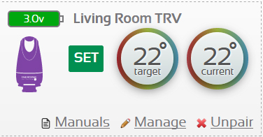

Batteries last around 2 years, I change every year to be on the safe side. I also use these IMGP8035.jpg also not electrical connected to boiler, but are internet connected, also they don't report if pin travel is OK, and you can't manually set them, yes they have geofencing, but the anti hysteresis software is OTT so don't really work very well with geofencing, and far more expensive, think I paid £75 for a pair, they had two screw threads, I used the M30 1.5mm and also needed a hub, so another £50 only advantage over the other one was they show both current and target temperatures so this TRV_report.jpg makes it easy to set lock shield valve. And I look at the temperature of the room in summer when out to decide if to turn on AC before I return. But all in all the cheap one is better. The cheap one even has window open detection, so when we unload food in the kitchen, it turns off heating in kitchen while we do it.
Ray
That’s a Honeywell TRV head and I think you will need to change to a more aesthetically pleasing Honeywell head or change the head and valve to another manufacturers.
