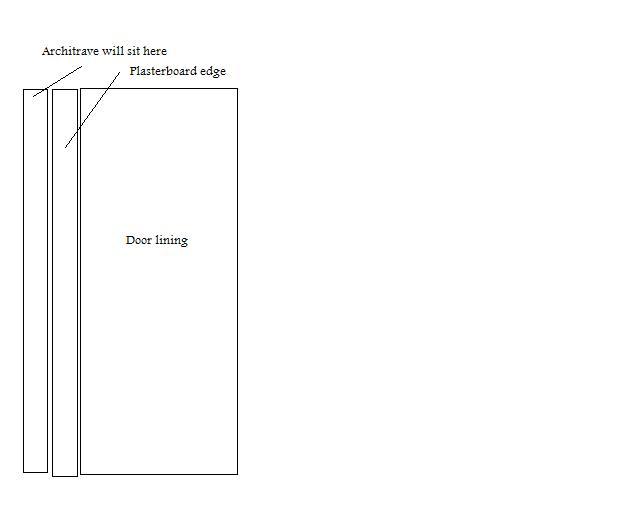

I've just removed all the old lime and horsehair plaster from most of my house, back to bare walls and was persuaded that dot and dab would be the best way of making good (although I was and still am not 100% convinced). Anyway, I removed all of the architraves from doorways expecting the boards to be put flush to the door linings so that I could then place the architraves back.
When I looked at what the plaster boarder had done I was surprised and am not sure if he is being honest with me. He has placed the board on top of the door lining and screwed it so that if the architrave is placed back on, there will be plasterboard forming part of the door lining - difficult for me to explain in words, hopefully image will be better.
He said that he had no other option as the distance between the brick and door lining was not big enough. I've measure the skirting and the gap would have been approx 25mm - he has used 12.5mm board.
Please can someone tell me if he is correct.[/img]
By the sound of it he has put the architrave on top of the plaster board!! He should have cut it level with the outside of the door casing and put a piece of dressed timber on the side of the casing level with the p/board and put the architrave on to the frame and then it would have rested on the p/board. This way you would only see the wood on the side of the frame not the edge of the p/board. Usually it would be a joiner or a good DIYer that would fit the wood!!!!!
If I’ve understood correctly, the distance between the bare brick/block wall & the edge of the door lining is around 25mm; unless the walls are really uneven, this should be more than enough to D&D 12.5mm boards & allow a 3mm plaster skim flush with the door lining; are you not getting it skimmed?
You can even drop to 9.5mm boards to give a bit more room if it’s tight but using thinner boards is not ideal. Don’t know why he’s not been able to accommodate it & those boards must have upwards of 25mm gap behind them; I always fit boards as tight to the wall as circumstances allow.
Not only is it going to look rather odd, an unprotected plasterboard edge over the door lining will be vulnerable & very easily damaged.

Where the distance from wall to board edge has to be 25mm your way would be the way to go. But the brick walls were really very straight from top to bottom with no extruding bits. I prepared the walls myself, wire brushed them and pva'd them. They were in that good condition including the pointing that many people told me to leave them brick.

Can't really think what the "plasterer" was thinking of! No way should he have overboarded the door linings. Salvage what you can, but rip down the boards over the doors and either bond/skim or re-d&d boards correctly.

Typically, a dry lining cavity will vary between around 3 to 10mm but I like to fit boards as tight as the condition of the wall allows specifically to avoid the “hollow” sound. I’ve no idea why he would fit boards with such a huge gap behind; it’s not quicker & certainly more expensive in terms of materials.

D&D boarding is not difficult if your methodical & think about what your doing; the skill comes in the plastering. There should not be large gaps around the sockets & they should not be below the back face of the board
Some of the boards rest on the floorboards which I'm sure is not correct and where they meet the ceiling there are large wonky gaps - some filled with adhesive and some not. On the bay window wall he has attached the board to the lathe but only on the sides so the top and bottom are not screwed to anything, this means that the board has alot of movement.
Leaving a small gap at the bottom of the boards is standard practice but it’s not critical on suspended timber floors. Some small gaps where they meet the cieling are almost inevitable but are easily filled as part of the prep/plastering process; there should not be large wonky gaps. The boards must be securely fixed & should definitely not move or they will inevitably fall down!

One 25kg bag of Drywall should be sufficient to fix between 2-4 boards but this obviously depending on the size of the adhesive “dabs”. The initial quantity he made you buy seems about right but he seems to have skimped on what he’s actually used & if there’s a 30mm cavity behind the boards I would have expected him to use more rather than less; what is he going to do with the rest? Some use strips of adhesive, some (including myself) use a close dot pattern but the important thing is there should be a minimum 20% of the board must in contact with the wall & the edges of the boards have additional dabs so they are fully supported; if the adhesive has been skimped, there is a risk the boards may fall off the wall!
The plan was to have the boards skimmed but I may revert back to my original plan, rip the lot down and have it all bonded (think that is the term) and plastered. A loss now may save me money in the long term I think.
All things considered I would take them down & start again & go for a proper float & set finish if you can; it will be more expensive but will outlast you & be worth it in the long run.
