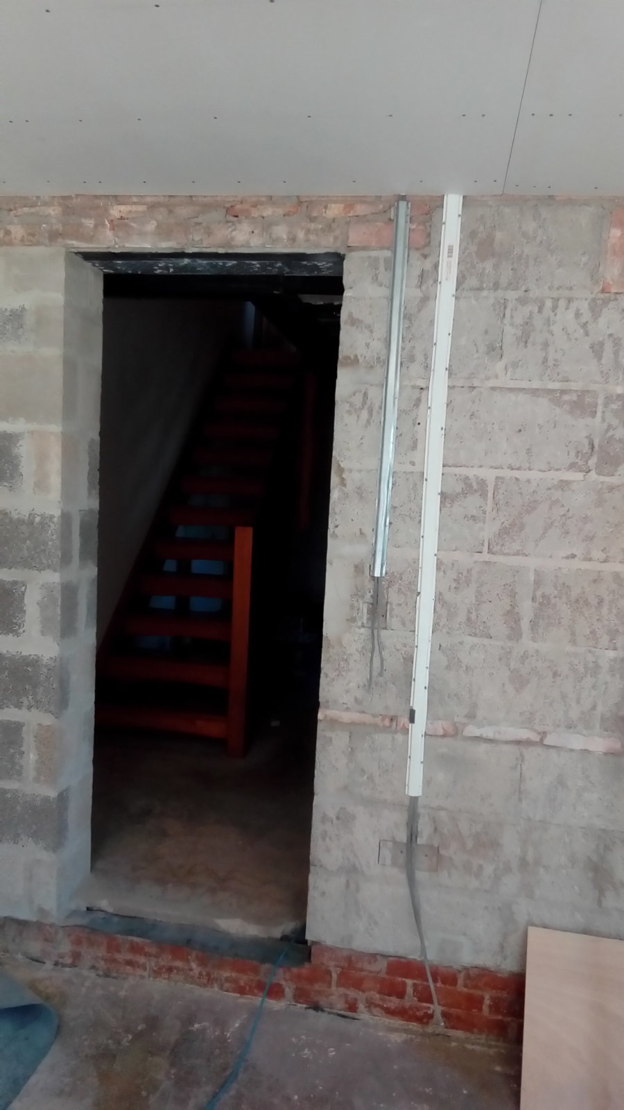

I need to fit a door lining where a wall is to be dry lined (presuming that spread would want the door lining fitted before dry lining the wall).
10mm deep cable capping to accommodate, plus 12.5mm board and 3mm skim?
I was thinking of setting the door lining maybe 30mm proud, giving approx 15mm plasterboard adhesive?
Thank you

yep, maybe a few mm more, better slightly over than under
