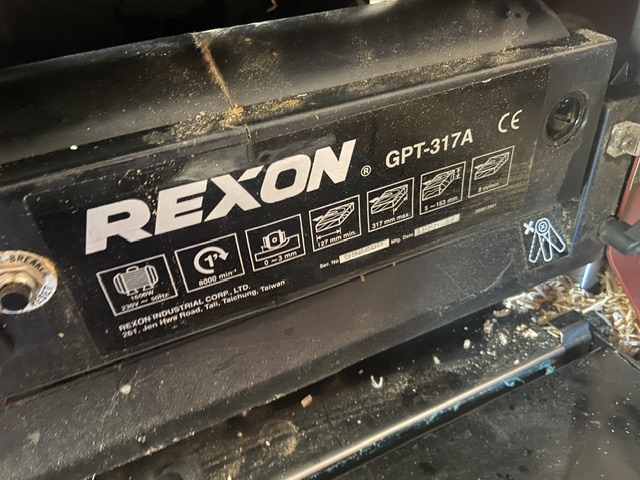

Hi does the Rexon GPT-317a have locking system. When I turn the handle to adjust the height or lower. It’s not moving the cutting planer up or down. It has been standing in my father in laws workshop for sometime and guess what I don’t have any instructions or manual, so any help would be gratefully appreciated
Regards
Graeme
