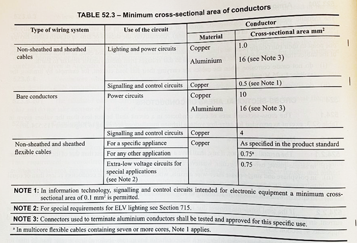

My lighting wiring is all singles in steel conduit. I would like to replace a single switch with a double or possibly triple switch, giving more control of individual lights. A challenge will be pulling more wires through the existing conduit. (There are of course other options for routing the wires if necessary.)
My question is: what do the regs say about the wires that can be used in steel conduit? With modern lamps the current is tiny, and there is plenty of choice of >230V-rated flexible thin wire available - but is it permitted? (With suitable protection of course.) And is anything thinner than 1mm^2 ever actually used?
Thanks.
Who knows?

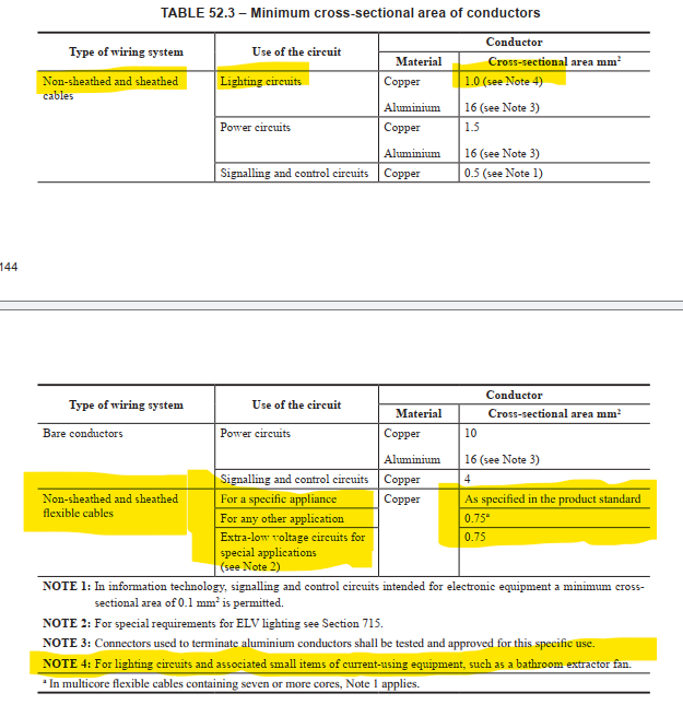

Thanks! From what you've posed, being in steel conduit doesn't make any difference, and flexible (i.e. stranded) 0.75 is allowed. But no smaller, unless it's for "signalling and control".
Who knows?
I presume that you know that what you posted comes from the pre-Amd2 version of BS7671:2018? As I'm sure you know, with the advent of Amd2, the distinction between "Lighting circuits" and "Power circuits" disappeared (thankfully :-) ).
..... not that any of this makes any difference to the OP's question relating to a lighting circuit.
I presume that you know that what you posted comes from the pre-Amd2 version of BS7671:2018? As I'm sure you know, with the advent of Amd2, the distinction between "Lighting circuits" and "Power circuits" disappeared (thankfully :) ).
Yes.
Is there a new table?

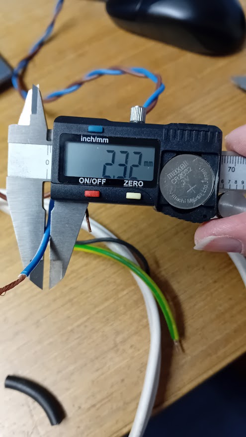

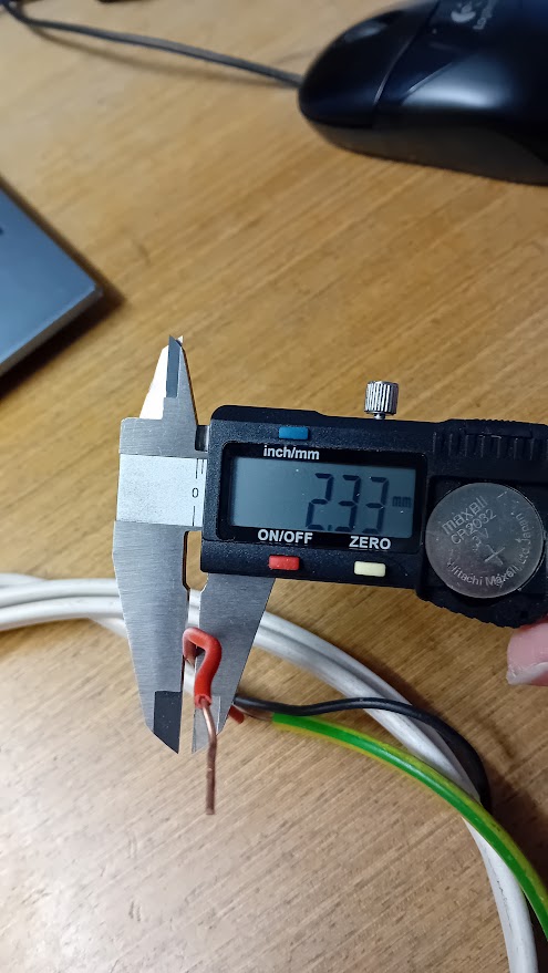

I was trying to imagine the difference between 0.75mm² flex and 1.0mm² solid conduit singles, according to Harry Hill there is only one way to find out... F I G H T. Actually there is a better way:
