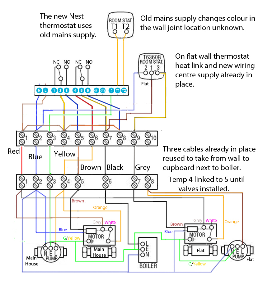

I went for Nest Gen 3, in hind sight, and hind sight is easy, likely Hive would have been better. But the first stage was to make a plan, I ended up with this, C_Plan_My_HouseD.jpgand there are errors, but at least once laid out, I can work out where the errors are, since mine is heating two dwellings I had to add relays, but once the layout was made out, I could see the errors.

I will admit not easy for DIY, but if you learn how to do it, you can also fix when it goes wrong. However you have a huge advantage, you know what boiler and can download the installation instructions.
So step one name of boiler followed by installation instructions in google, and find how wired.

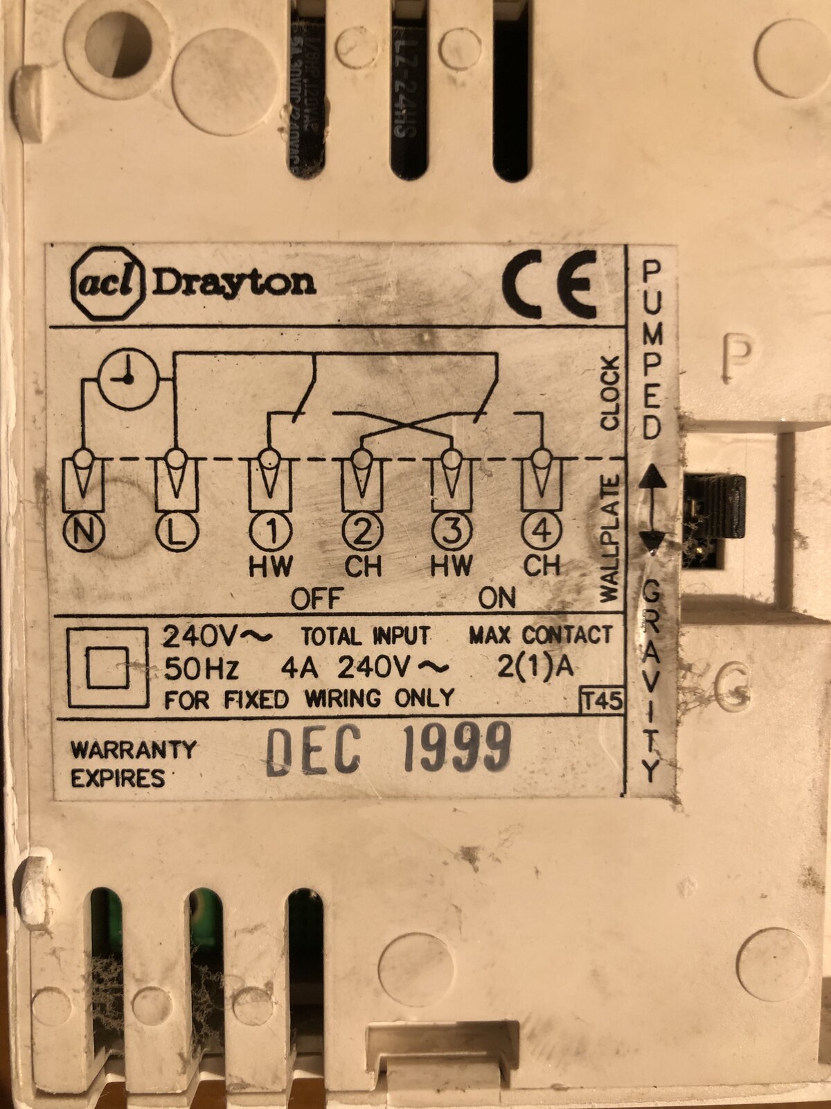

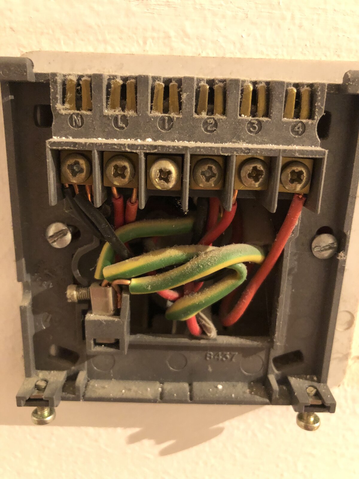

Thanks for all the help so far. I have taken the unit off to examine the back plate and the wiring is as suspected missing the key element of heating triggering the boiler unless the water is set to on.
Oddly that back of the unit is set to "pump" rather than gravity mode.
So I assume I replicate the wiring but set the Hive to gravity mode which will automatically kick both off at the same time?

Not sure what you mean by that. If your LP722 only has wires in terminals N, L, 3 and 4 that may be all your system needs. Is one of those missing? Don't take the drawing of his system that @ericmark has posted as being gospel, it is unlikely to be exactly the same as yours.
This setting is normally used by systems that have a hot water cylinder that is heated by the natural (gravity) circulation of hot water rising and cooler water falling. It automatically switches the hot water 'on' whenever the heating is switched 'on'. Although from your description, it maybe an operating restriction of your boiler that the hot water has to be heated up before the heating will work. In which case the gravity setting would be correct.

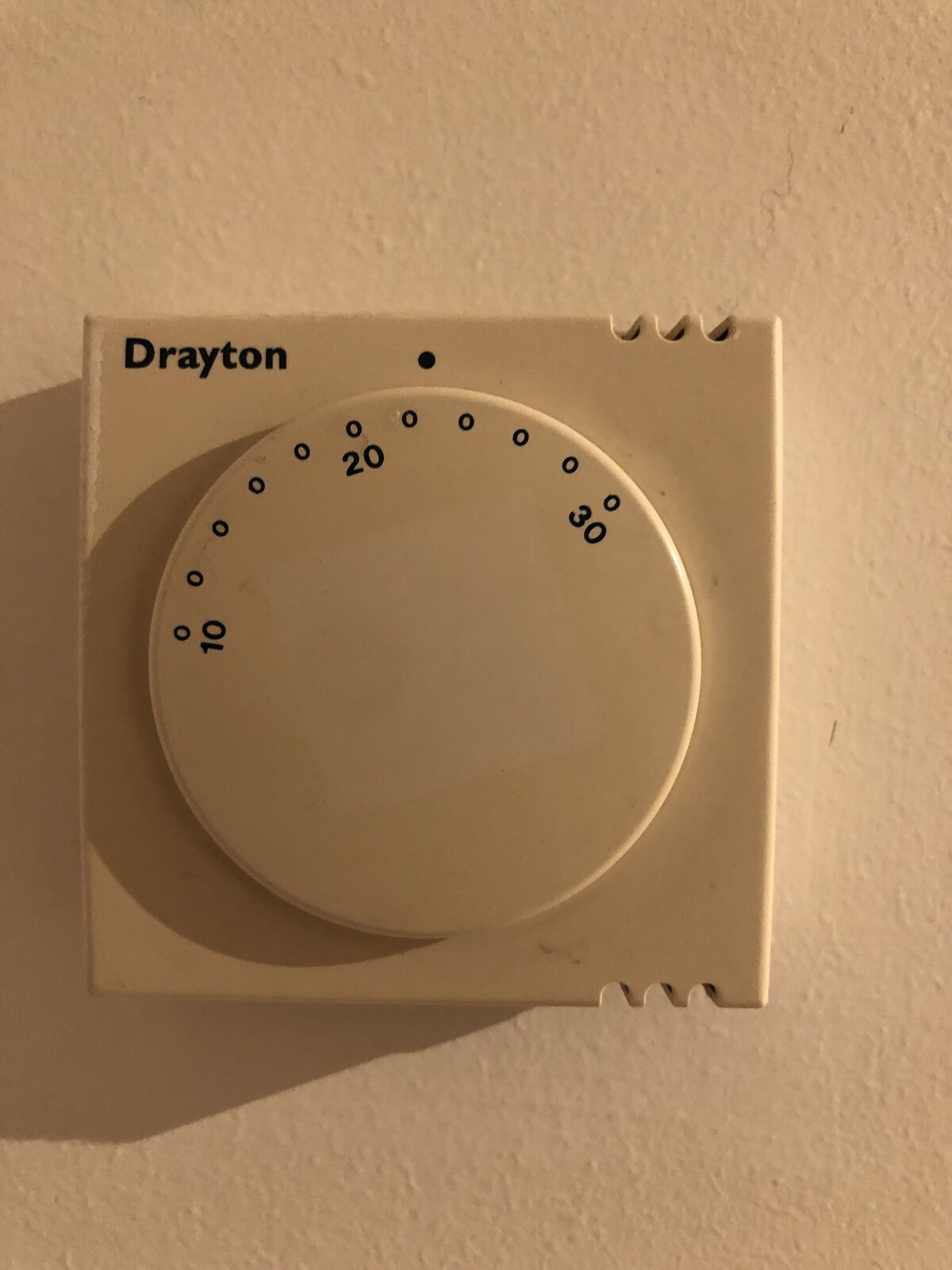

Thankyou - here are the pictures. What I meant was from my limited understanding. The wiring means that the heating call only operates the pump, but the hot water has to be on to produce the heat to be pumped. So assuming my assumption is correct, then gravity mode will in effect replicate this. So as you say its only 3/4 that are needed.
The thermostat has 3 wires. From what I understand if I loop the call and constant wires then it will create a constant call which means the Nest wont get interfered with. I can do this at the thermostat and just put a blanking plate over it just in case there is a need for it in the future.
Sounds good to me. (y)
It looks like a Drayton RTS1 thermostat. If so, there should be wires in its terminals N, L and 3, in which case, the wires in L and 3 should be joined together, and the wire in N isolated safely out of the way. There rarely is a backbox behind a thermostat, so you might not be able to fit a blanking plate, and may need to replace the thermostat with a junction box to make the connections. Alternatively, leave the thermostat in situ and move the wire from terminal 3 to the L terminal with the wire that is already there. This will effectively take the old thermostat out of the control circuit. If you do this, I suggest you still isolate the neutral as otherwise the old thermostat will be consuming a very small amount of electricity unnecessarily.
A third option is to trace the thermostat cable back to its origin. Note where the 3 wires are connected at their origin and then remove them. Then add a link between the terminals that the wires connected to the thermostat L and 3 have just been removed from to complete the circuit.
So just to finish this off mostly. It came today after a few delays. The wiring was like for like but the back plates still needed swapping.
Got that done and switched to gravity mode - works perfectly.
