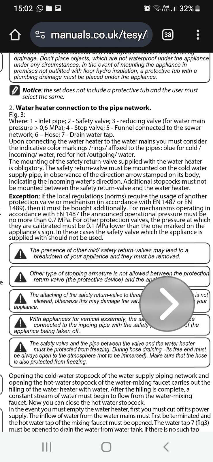

From looking at that it says if the incoming pressure exceeds 6 bar a pressure reducing valve should be fitted.​
Then something about not using the pressure relief valve supplied.
Having looked through that it seems to me that the problem is that the pressure relief valve should be 6 bar instead of the 3 bar one that's fitted.
I've messaged the plumber about that.
Thanks for the link to the manual.
It is designed to rely on its built-in pressure relief valve passing when it heats up. This isn’t allowed in the UK - hence the various bits saying “If the local regulations (norms) require the usage of another protection valve or mechanism (in accordance with EN 1487 or EN 1489), then it must be bought additionally.” One such mechanism they’re referring to is the expansion vessel. Another would be an over-temperature relief valve.
They want it to be installed in a room with a waterproof floor with a drain, i.e. a wet room. Failing that, I think “protective tub” should be “tundish” but I’ll need to check that.

I found and downloaded the manual about a week ago and had a quick look, mainly for installation diagrams as I'm not into reading 3000, badly translated words. I was unable to read the diagrams as they were bitmaps and would not scale up. That's as far as I went.
