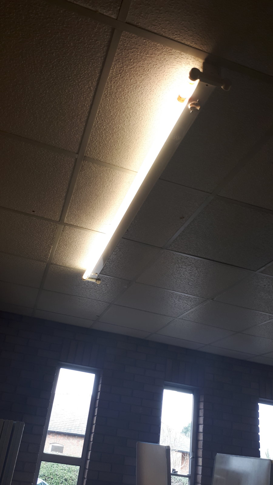

Thorn 6ft twin ballast wiring
They use 70w greenstock shatterproof tubes. I have a 6ft t12 which didnt work either.
Sounds like that Cap, need to see inside 1 really, if that cap can be cut off and the 2 wires joined it will prove the chokes are good, and then you can just get new Caps.

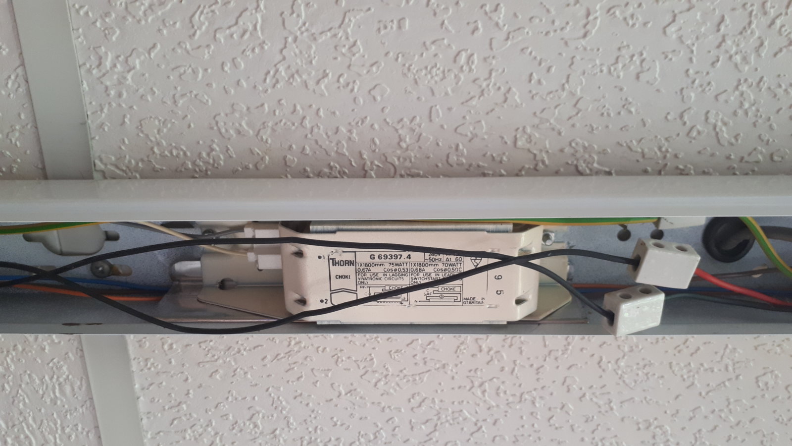

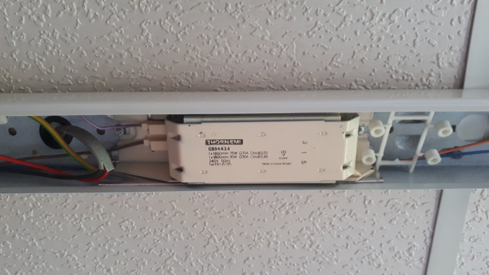

Both those ballasts will be fine for a single 6’ tube in conjunction with a switch or electronic starter, as per the drawing from fluorescence earlier in this thread.
I think you are over complicating things and confusing yourself with talk of triple and series ballasts.

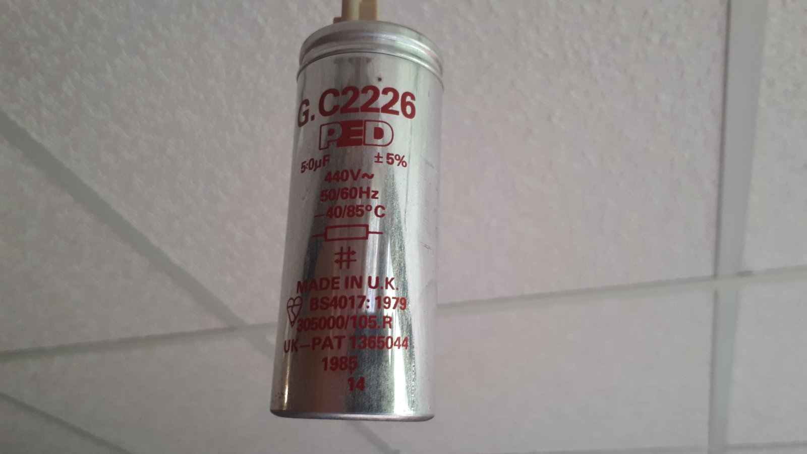

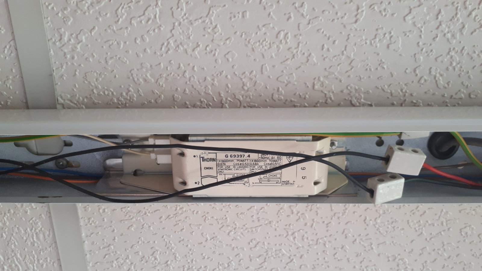

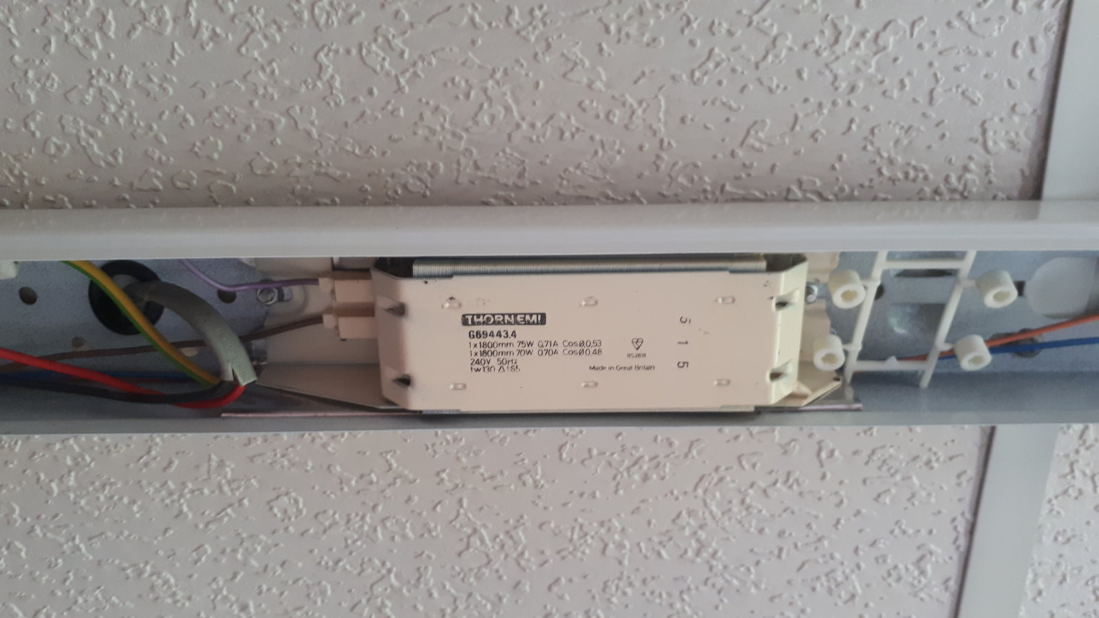

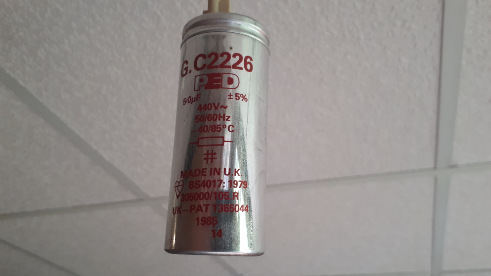

I've had a look inside and it is a lead lag circuit. I didnt bypass the capacitor but I'll order one and see if it does the trick. The battens aren't quite as old as I thought, ie they are 2x70w t8 thorn emi.

The capacitor was manufactured week 19 of 1985 so 35 years old now. Do the fittings have Vivatronic starters fitted (rectangular beige plastic boxes) or normal replaceable cylindrical types? Also them ballasts are the ones that are probably the best ballasts ever made, they seem to last pretty much forever.

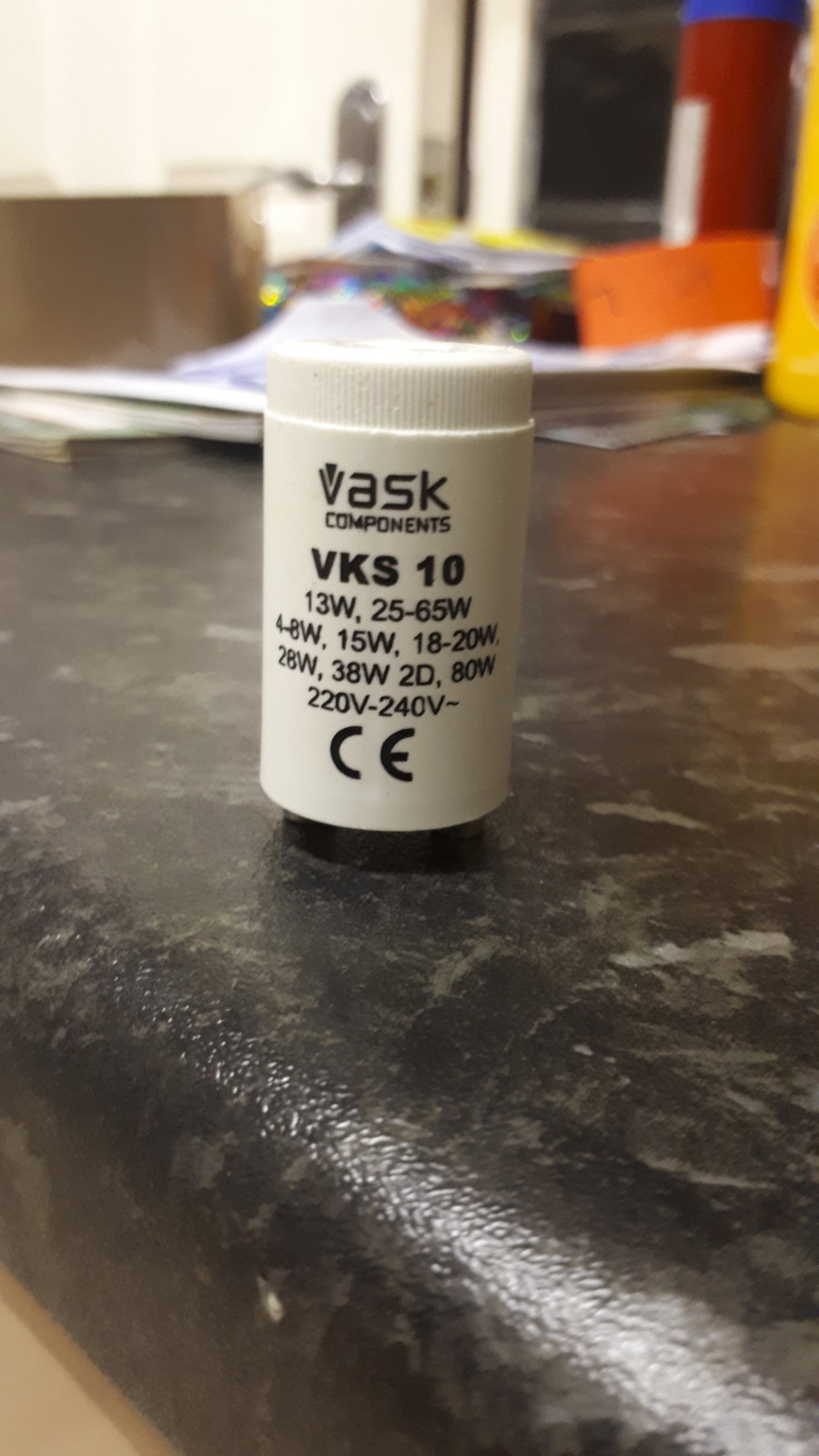

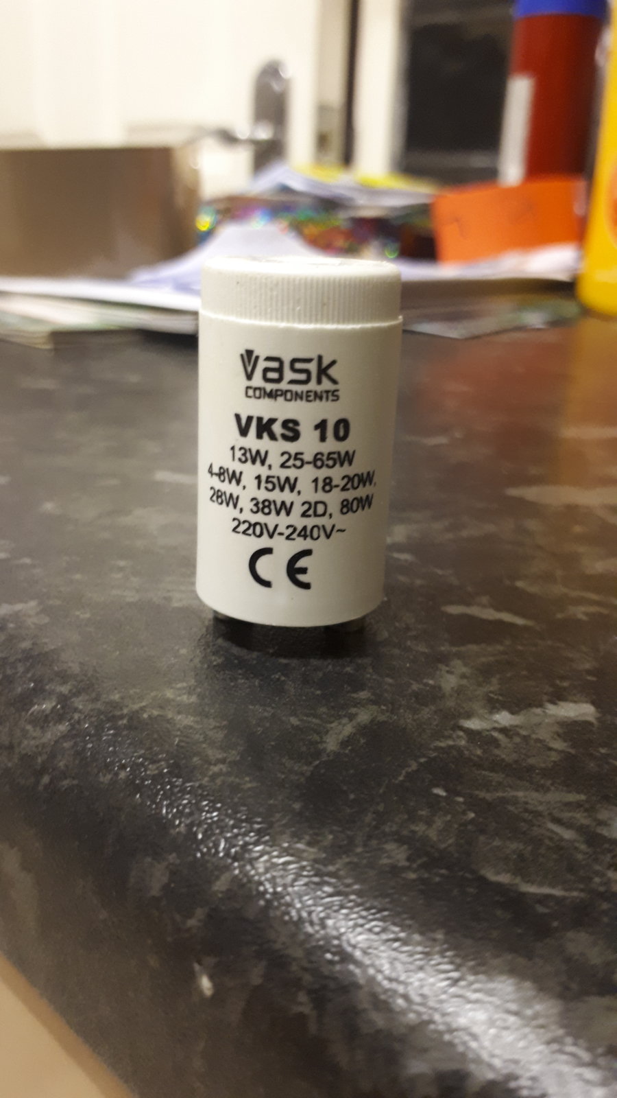

Glow bottle starters. I changed about 7 that didnt work, most of them the wrong type for a 6ft like the one shown, although that one still works. I think people see 80w and think it'll work for a 70w which it does for a short time and then seizes.

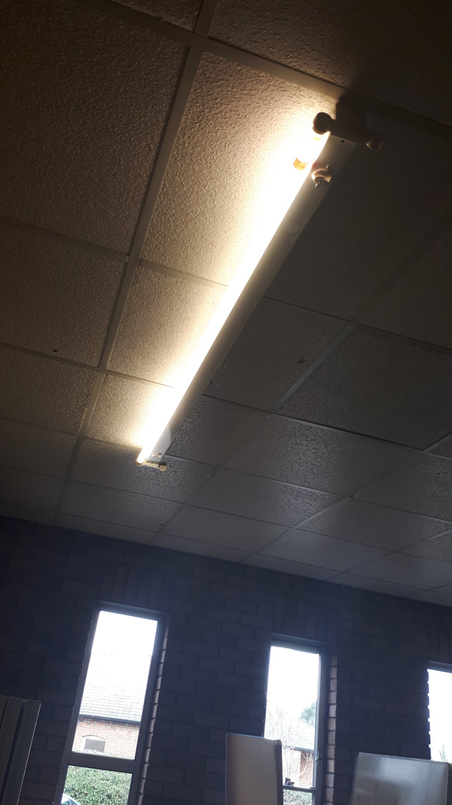

Heres one of the battens with a dead cap. The tube that's on only works if you jiggle it. I genuinely thought these were t12 battens and got hold of some t12 bulb holders but they are too big. Cost more in delivery charges so no point sending them back.

What do you mean by T12 lamp holders and how were you going to make them fit? The fittings you pictured have what's known as 'oval' lamp holders which are proprietary to this fitting and will already accept T12 or T8 tubes. The starters you've pictured are cheap rubbish and will fail prematurely even when used correctly, I recommend using electronic starters which are much more reliable, can double lamp life and will strike the tube first time every time. I recommend removing the tube and making sure the pins are in good condition, if you're having to wiggle the tube to start it, it's possible one of the pins is loose and is not making a good connection in the lamp holder.
Starter: https://www.ebay.co.uk/itm/ELECTRON...947627?hash=item23ba916aeb:g:-9AAAOSw-EBZp9vj
Can you still buy oval shaped lamp holders?
There are 2 fixtures there with bad connections, one has a noticeable burn mark if you take the tube out. I just made an error and bought the wrong bulbholder without checking. Lesson learned.
