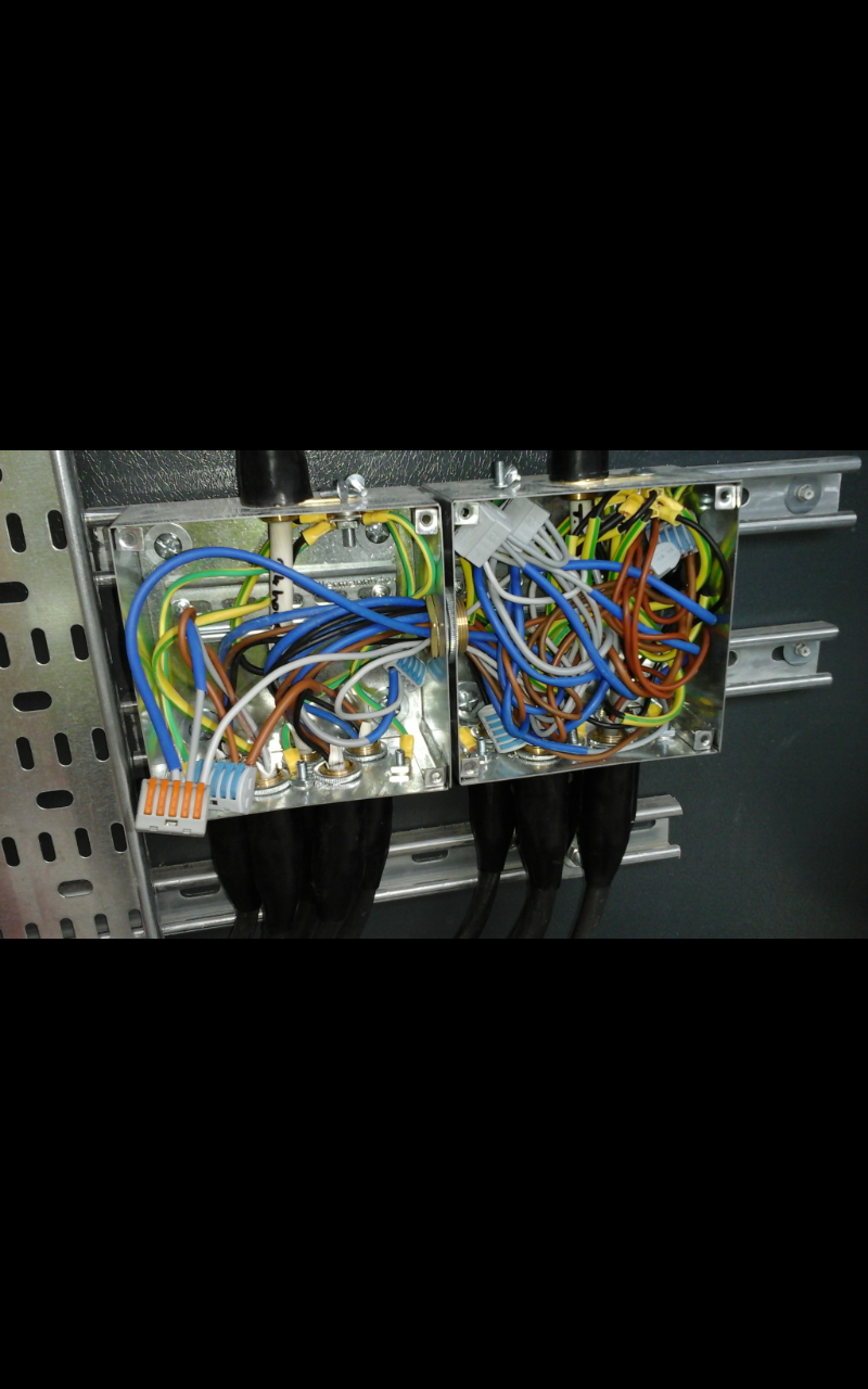

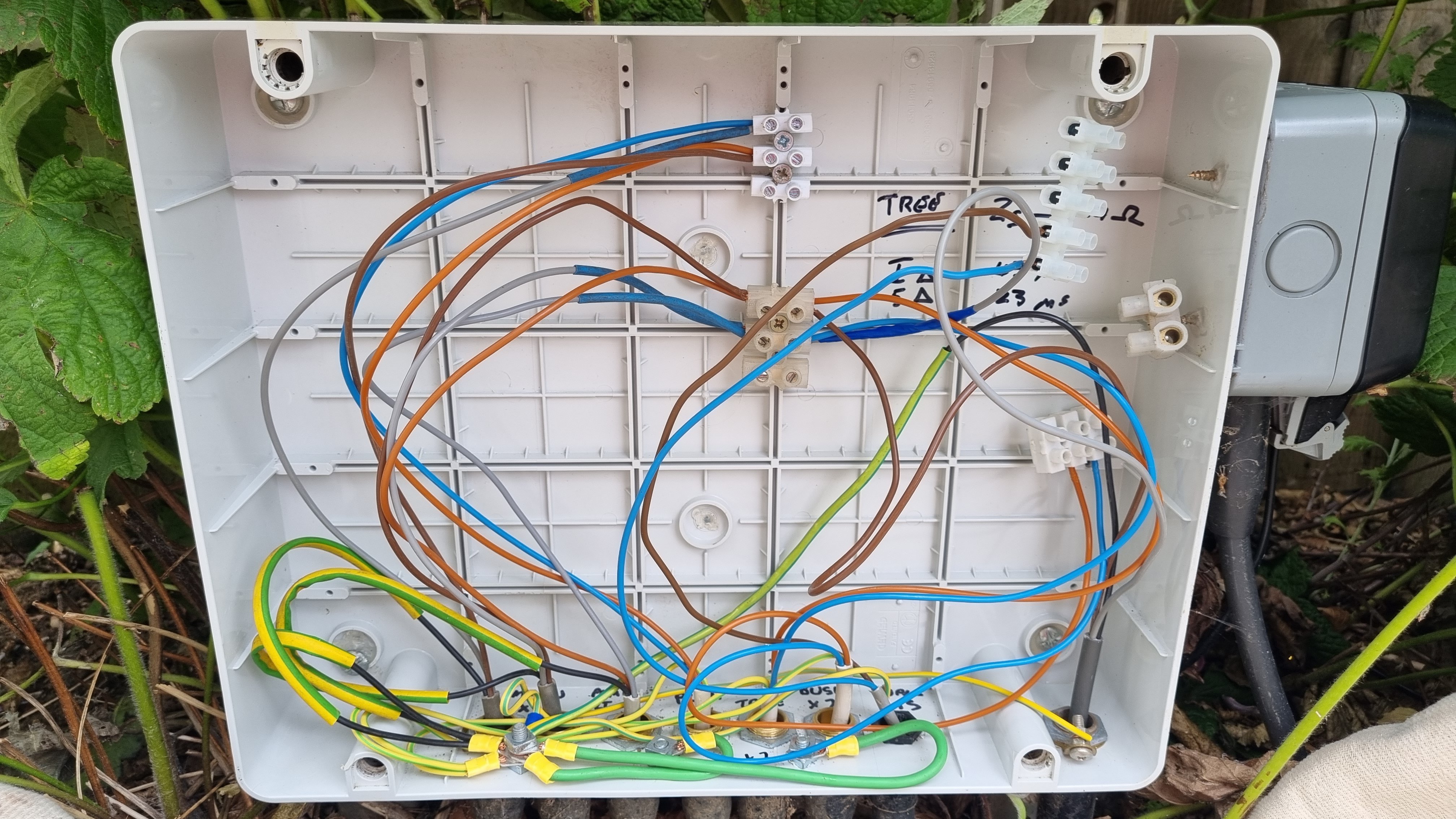

Around 9 years ago as part of a garden makeover, an electrician installed a number of SWA cables and light fittings and connected them up in a large plastic "junction" box in the garden. Here's a "clean" photo showing the full interior of the box, however, as this is a little old, it doesn't include the additional socket cable so I've added the 2nd photo to show this cable (at the far right):
Please note: some of the wires are currently disconnected for testing so the photos are really to show the spaghetti state of the wiring.
What may not be clear from the photo is that the banjo earth rings for each SWA (except the far right SWA) are all installed underneath the box i.e. outside it, and earthed to the inside using brass screws, fitted through holes drilled through the box.
I would like to tidy up this wiring and would appreciate your thoughts on how best to do this.
As you can see, currently, a couple of terminal blocks are used; one for the lights and the other for the water feature pump.
There are two SWA cables feeding power into the box (left most SWA cables), with each connected to a double pole switch in the house. One of these SWA cables is (normally) connected to 5 other cables in the box (4 SWA and 1 cable). The other SWA cable is connected to the water feature pump SWA. So, in terms of connections required:
Lights (switch 1):
Live 1 in and 5 out = 6 live wires on switch 1
Neutral 1 in and 5 out = 6 neutral wires on switch 1
Earth 2 in (earth and SWA metal) and 9 out (5 earth + 4 SWA metal) = 11 earth wires on switch 1
Water Feature Pump (switch 2):
Live 1 in and 1 out = 2 live wires on switch 2
Neutral 1 in and 1 out = 2 neutral wires on switch 2
Earth 2 in (earth and SWA metal) and 2 out (earth and SWA metal) = 4 earth wires on switch 2
I notice the existing wiring connects all the earth cables together, regardless of switch. Are there any advantages to separately the earths by switch?
My thoughts:
I could use wago connectors for the water feature pump but this doesn't really tidy up the cable, just replaces the terminal block with wagos. Using wagos for the lights is a little more difficult due to the 11 earth wires. Also, the standard wago connectors don't have any method of fixing them to the plastic box.
I was wondering if a DIN rail could be used to tidy up the wiring and appropriate connectors purchased. I see that wago make a TOPJOB S series product, but there are so many types of connectors etc. I'm not exactly sure how these work other than the required connectors are added to the rail and jumper bars used to combine these connectors into groups of connected wires e.g. switch 1 live, switch 1 neutral etc.
I could als replace the banjo earth rings with piranha earth nuts to bring all the earth connections inside the box. The screw holes would then need to be filled (electrical putty?). This doesn't really help tidy up the wiring, but in my opinion is a better way to connect the SWA protection to earth.
I would appreciate your thoughts/ideas.
There's nothing much worth tidying up
Do a few tests earth continuity and IR - fix your problem
Any box where the wires are fixed
makes testing easier, sometimes called a wiring centre
but there is no real need.

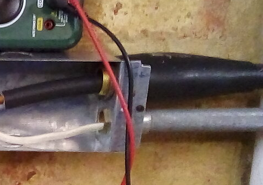

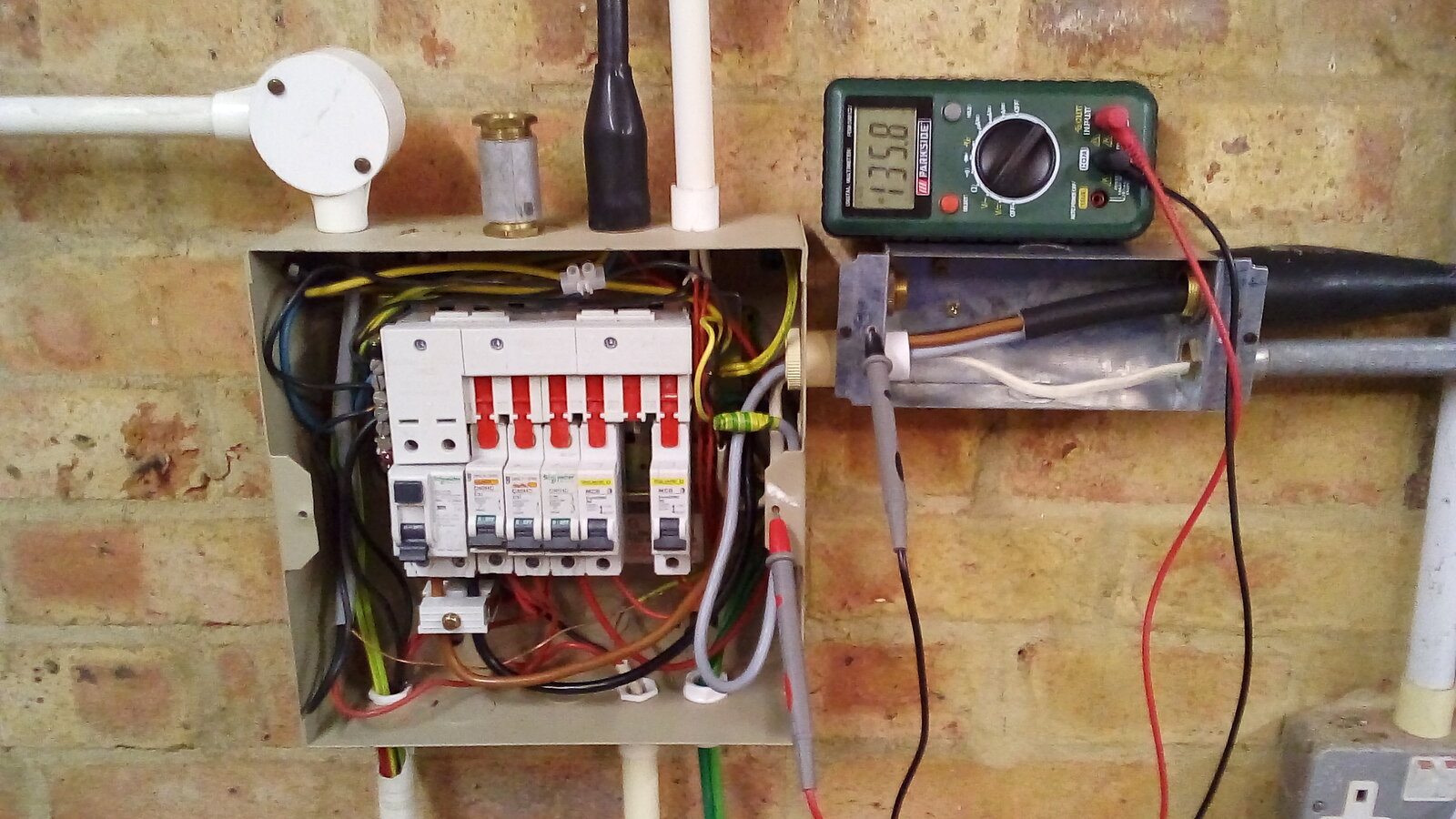

was a classic example of incorrect earthing, in this instance it was an outbuilding which started it's life as a telephone exchange with an amazing local earth system (TT).
The black SWA is the incoming sub main from the house, the armour and grey core were connected to the incoming DNO earth which I never did establish the full provenance of.
I have no idea why it was installed into the metal box which was originally joined using a metal coupler and that was changed to the white plastic and the grey earth disconnected in a bid to stop the tripping some dozen or so electricians visits before.
The two green wires at the bottom are the bonding to the earth GPO earth and a water pipe.
The actual problem was loss of DNO earth due to metal theft and it seemed the only earth on the system for about a dozen rural properties was via the small T&E in that steel box by the SWA which was a late addition and bypassed the isolation between the 2 earth systems.

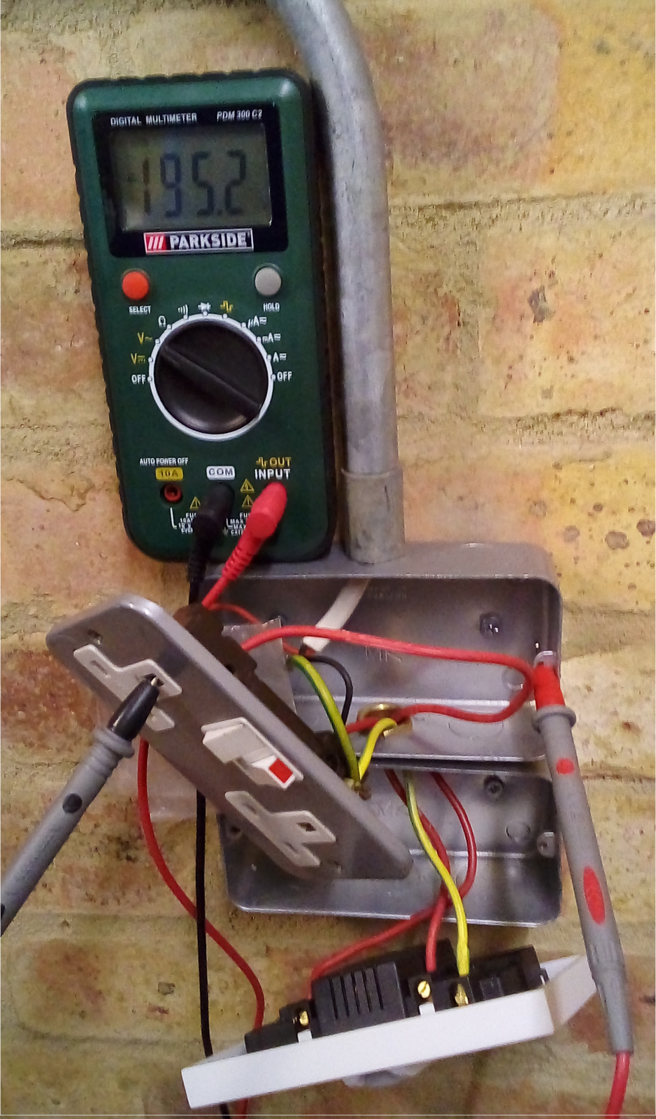

The danger I found occurred with everything in that CU turned off and checked for dead, I removed the 2 sockets fed by that T&E and found 200V between the 2 earths.
I connected the L & N of the socket to CPC and earth terminal in back box to power a 60W bulb to double check this isn't a high impedance meter issue.
As shown in the various pictures the voltage changed significantly, I assume as things in the other properties cycled such as immersion heaters.
Getting back to your OP; My comment in the other thread is it's a bit untidy or scruffy but in all honesty it's not a horrible mess and not bad enough that it makes it difficult to work on.
Unlike this one:
Courtesy of 333rocky333.
Although it's nice to se an immaculate piece of artwork I'd much prefer it to be safe, secure, work properly and be able to see what's there and work on it.
You can connect the earth's to a terminal block take them off the banjo
The piranha nut takes away the problem of earth continuity depending on compression against the plastic or use Sunrays suggestion of the compression gland and earthing inside the box
Real-world experience with me is it’s better to separate L-N-E conductors and tape them . Leave them free at a high level in the box . Gives you a secondary protection against moisture ingress and nuisance tripping
I agree with all of that... except I don't think it's worth the effort making major changes to it.
If there are concerns about the efficacy of the earthing arrangements as it stands simply adding piranha nuts to the existing would be easiest fix.
Wow, that really is spaghetti junction!!!!
I agree that my garden wiring box isn't that bad and chances are I will forget about it in a couple of weeks when other projects take priority, like changing some radiators in the house before the cold weather hits and repointing a valley on a low roof!!!!
However, I will definitely be getting quotes for upgrading the consumer unit and troubleshooting the garden trip issue and it feels like "improving" the wiring in the garden wiring box is probably better done before the electrician starts, since he would then be testing the "new" wiring layout.

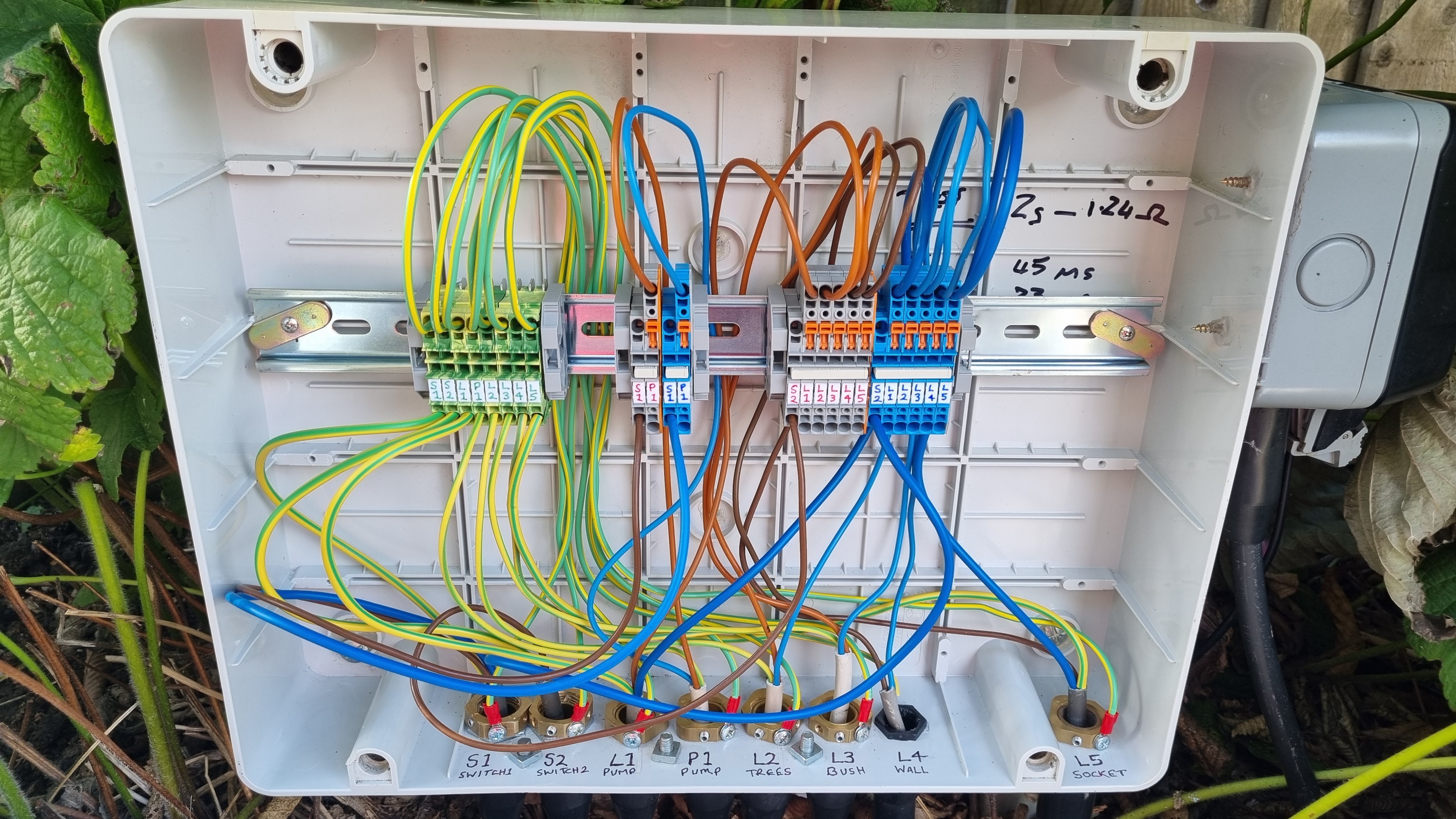

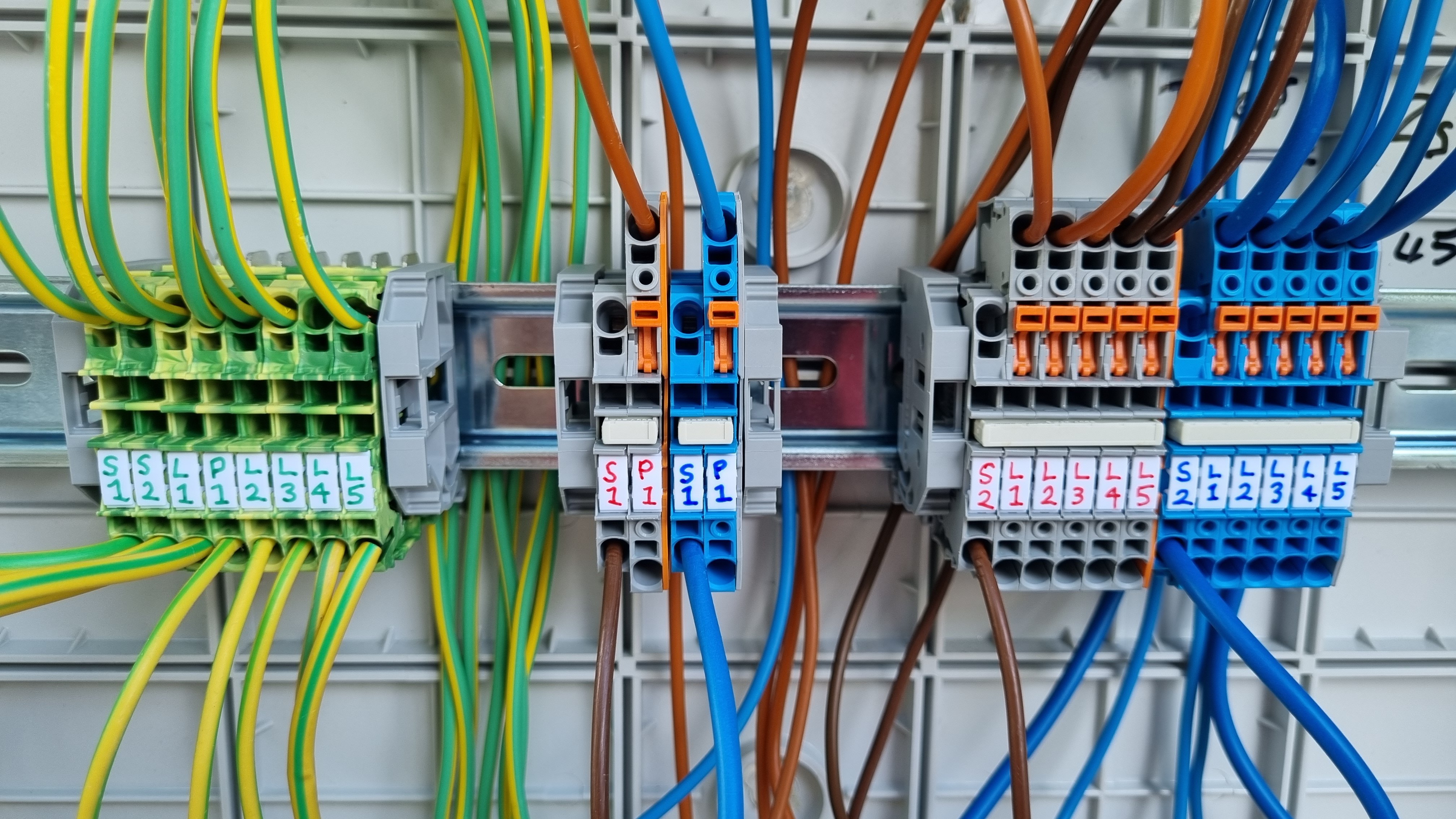

I've been looking at the Wago TOPJOBS 2 DIN rail terminals and Google Gemini has helped me identify the required components. It would definitely improve the layout of the cabling and make it much easier to test the various garden circuits. Decisions, decisions. Why do I create unnecessary work for myself?
If you've already got ordinary Wagos, Plan B could be to get some Din rail carriers for them. But either way you'll need to change the box or fix a rail into the existing one.
There's a lot of space in the box, and slack in the cables - I would have thought you could do a lot by just dressing them neatly.
So, I decided to go ahead after Googling and reading about Wagos Topjob S series terminal blocks. With some help from Gemini AI, purchased a DIN rail and the relevant terminal blocks and installed them into the garden wiring box.
Before Image:
After Image:
It still looks a little fussy but I'm happier with the cable organisation and those disconnect blocks should make testing the individual garden circuits easier, since rather than disconnecting cables, the orange tabs can be pulled out to disconnect the circuit.

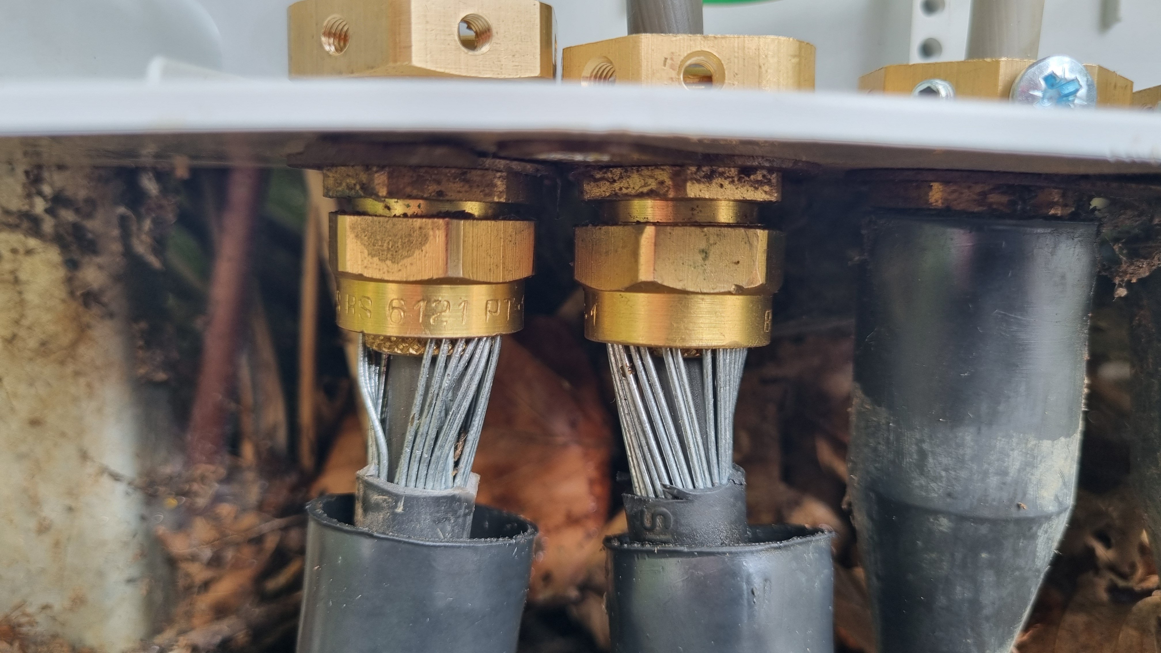

I added piranha earth nuts to replace the banjos connected on the outside of the box, although the entry holes for the two switch SWA's were drilled much too close together by the electrician, making it difficult to remove the original nuts and add new ones. Clearly a lack of planning on his part!

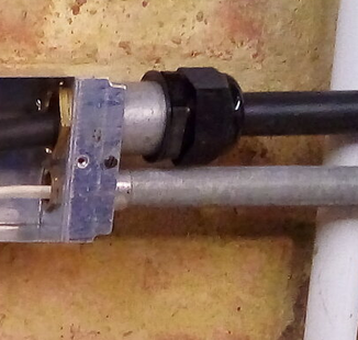

I also noticed the SWA glands are unlike anything I've used, since they don't seem to protect the cable. Are these standard versions:
They look like standard indoor BW glands installed by someone who stripped the sheath back too far.
