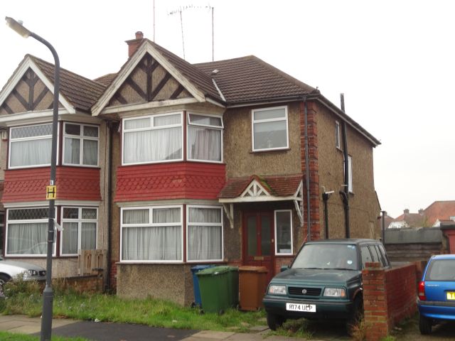

This is how it looked before the renovations started. When finished, it had better look a hell of a lot nicer lol. The intention is to have light-coloured rendered walls (instead of brick), and Marley/Redland natural red (roof, skirting and canopy) tiles.

As you say anything would look better there lol.
Look into the design options for the windows (where you have openers, Transoms and mullions etc) and also consider having Dummy sash's, Maybe even flush sash windows.
Take a look up and down the street at other houses for inspiration. No offense to builders but I would recommend getting in a proper window company for the windows.
I have never seen a house that didn't look good with Golden Oak windows (hides the dirt too) but the options nowadays are pretty much limitless.
Frame profile has an equal if not greater influence on appearance than colour.
