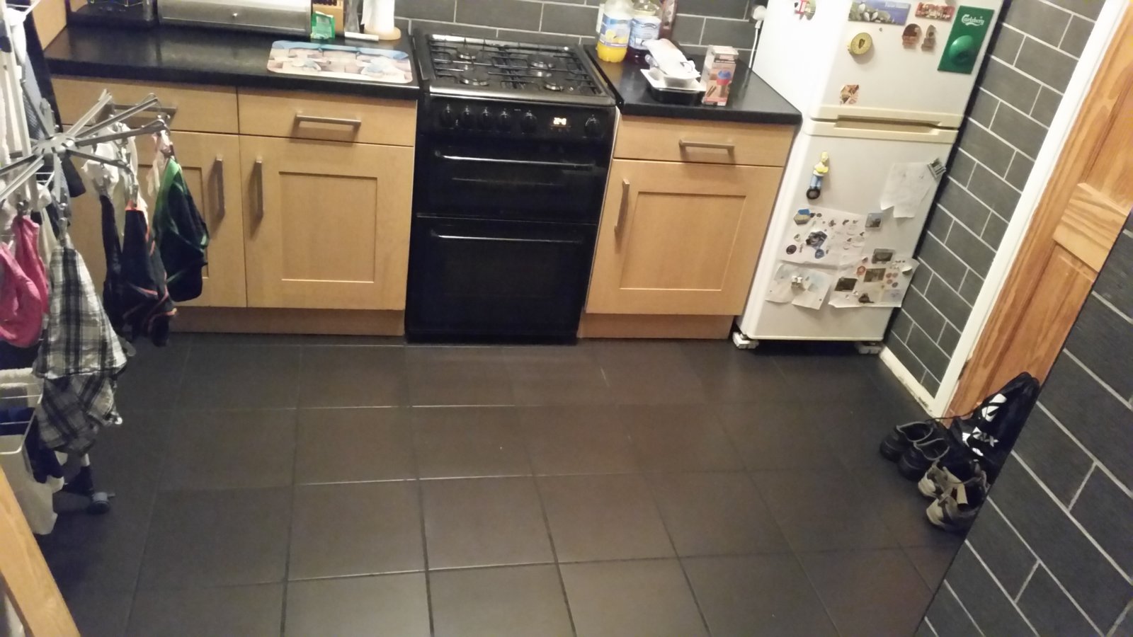

I leveled as I went with the tiles, hard work but it's come out perfect (hand mixed 200kg of tile adhesive in a small tub so it wouldn't go off/ to waste).
Also used 5mm grout lines, black tiles and black grout!. Our 11 year old lad drags his muddy bike throught the kitchen so no chance of keeping it clean with light grout!.
Took a week of nights after work and a weekend to sort it out.
I lifted some units out but some got jacked up and tiles under legs.
