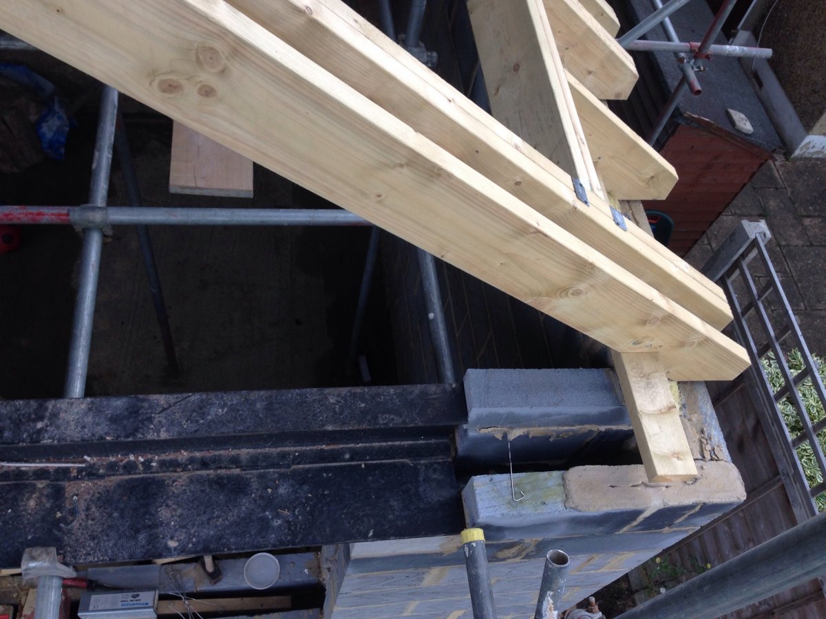

Hi . I have a gable end on the back of my extension. I am going to bring the cavity walls to the same height as the rafters. So I need a tie between the cavity wall and the rafter? Thanks
I have included a picture
Galv restraint straps are the norm and they must cross three rafters, usually 1.8m apart. Put them either side of the Velux trim. I take it there is no barge on this gable hence the absence of a gable ladder or noggs?
