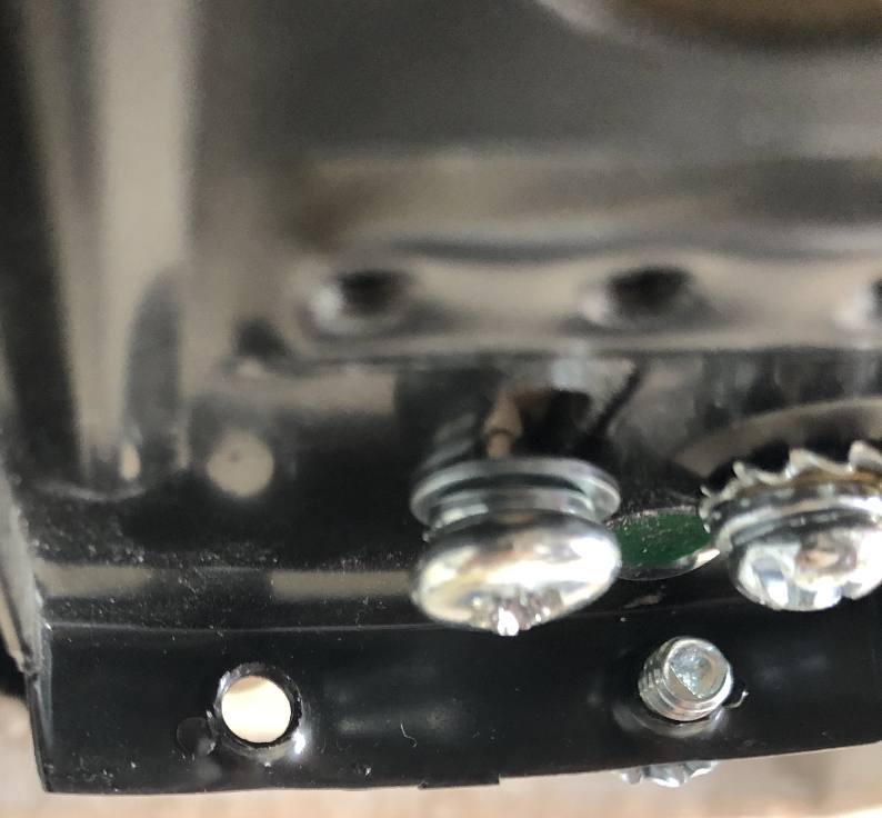

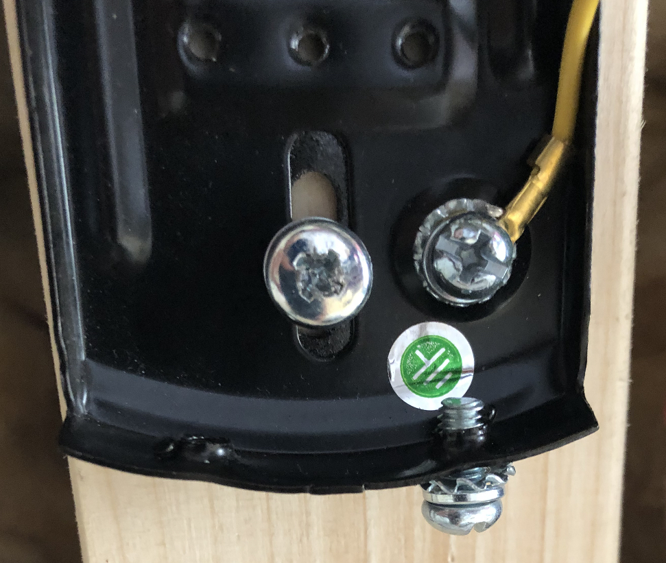

I’m hanging a ceiling fan & have put the bracket on with the two screws. One of them is almost screwed in fully but has stripped before I could how can I tighten the rest of this up it was quite tight as I was screwing hence the reason it stripped.

Find a flathead screwdriver that fits diagonally in the crosshead.
Also, to stop it happening again, make sure you use the right sized screw bit, and take it slowly
Just fit a new screw in the upper end of the slot and ignore the existing one.
Pre-drill a pilot hole first though, to make it easier to drive the new screw in.
