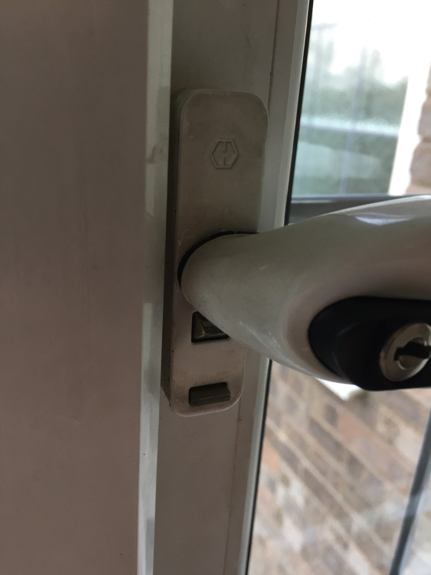

Tightening UVPC Window Handle
The bit with the hexagon which is the makers logo 'hoppe' is a plate that rotates, poke the sprung latch in with a screwdriver while turning the plate to any side revealing the screws, then just rotate it back till it clicks in place, opening the window will give you more room
