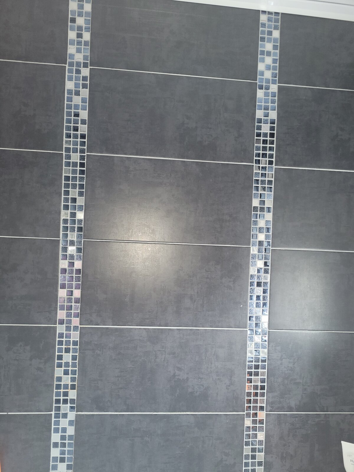

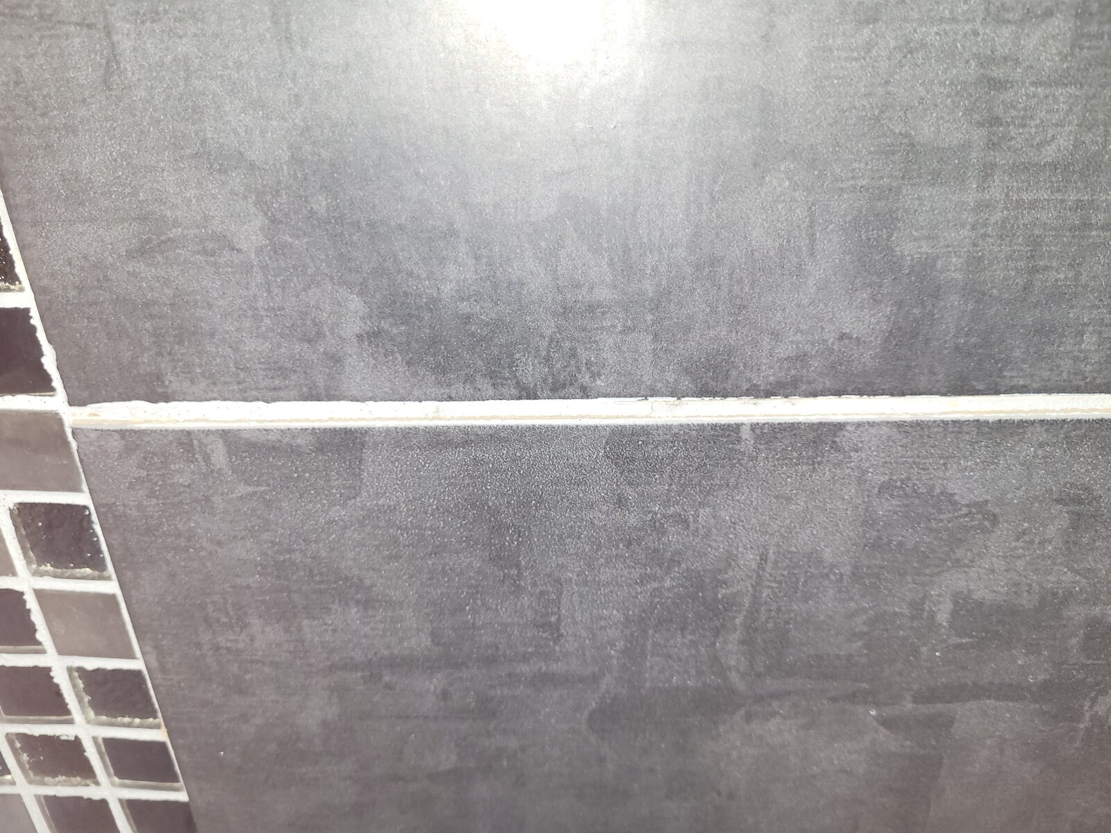

I have a council house and got a new bathroom fitted 8 years ago about a year after it was fitted my ex partner decided he didn't like the white grout and regrouted it with a grey glitter grout the only problem is the council don't repair any damage done If we have had our own work done to them can I paint over the grout white again if so with what or am I better paying someone to come and regrout the whole bathroom

TBH, from your 2 photos, I cannot see what the problem is.
My ex did a regrout so wasn't a pen used and I have a few loose tiles meaning the council will not repair anything as the grout is not the white colour that they used

Ahhh... I see what your problem is.
Are they aware of the regrout? Assuming that it was done properly, it should not have caused any problems. That said, when re-grouting you need to remove the silicone first, and then grout and resilicone.

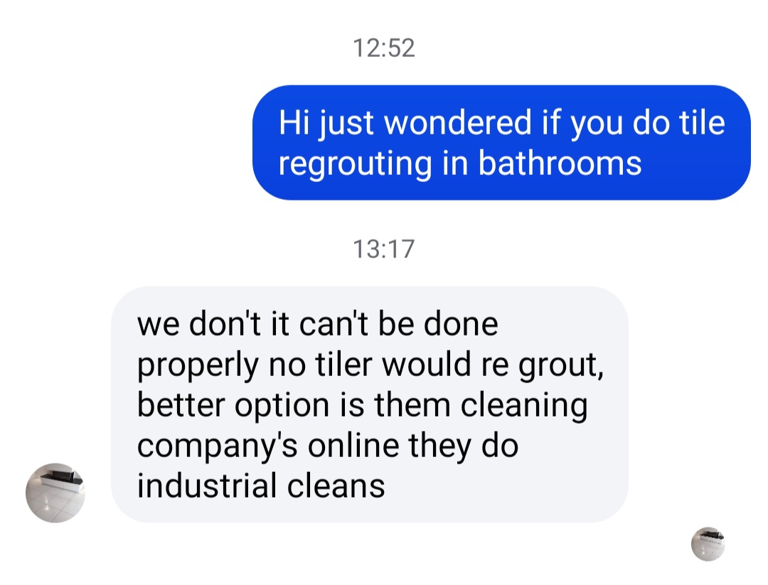

It has to be approved my a maintenance officer 1st before the job is issued this is a reply I got from a tiler is this correct o do you think he just doesn't want the job

I have regrouted bathrooms for customers...
I am primarily a decorator, but I tile. I only regrout for A grade customers and I do it on an hourly rate.
Let's assume it takes 4 hours to re-groute a room it will take 6-8 hours to remove all of the grout, plus the time to re-grout. That said, you don't always need to remove all of the old grout.
Why don't you just ask them to do the job and see if they even notice the grout colour?
Or just regrout it yourself? We could tell you how to do it, it's not that hard.
