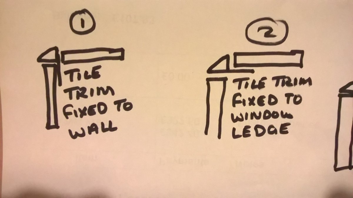

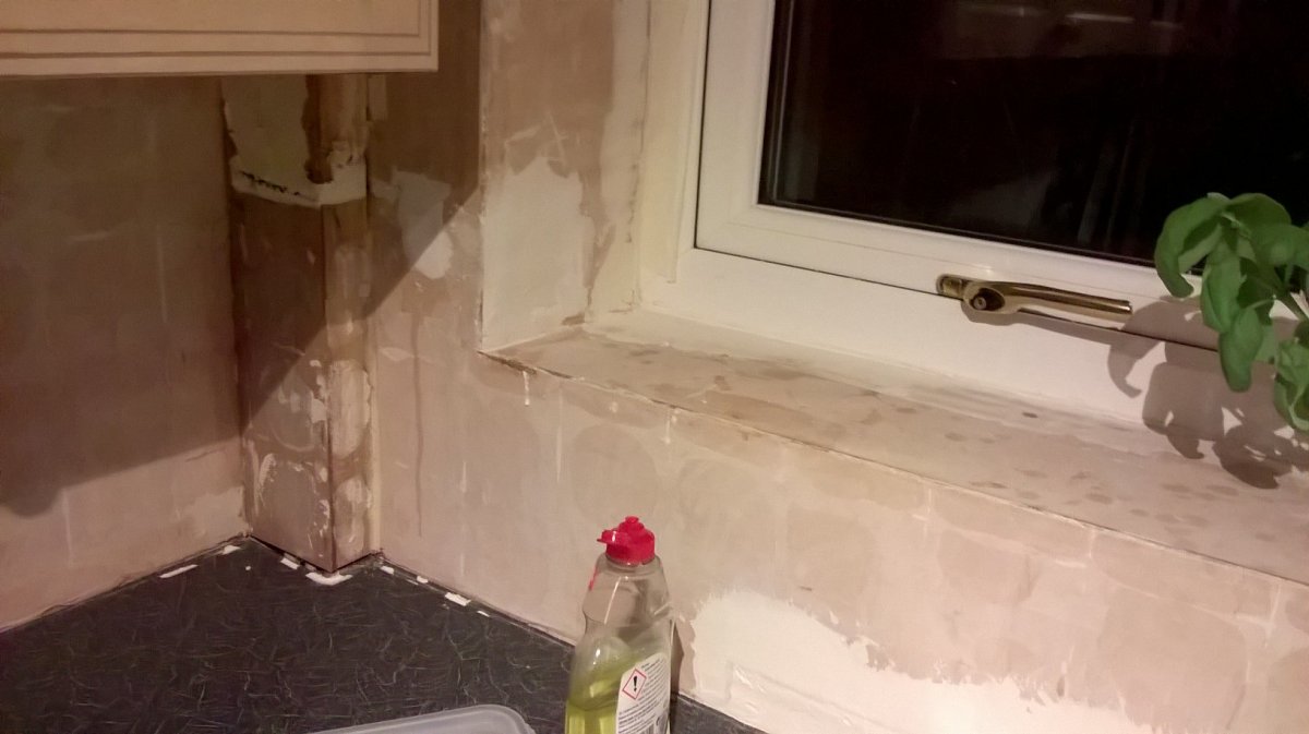

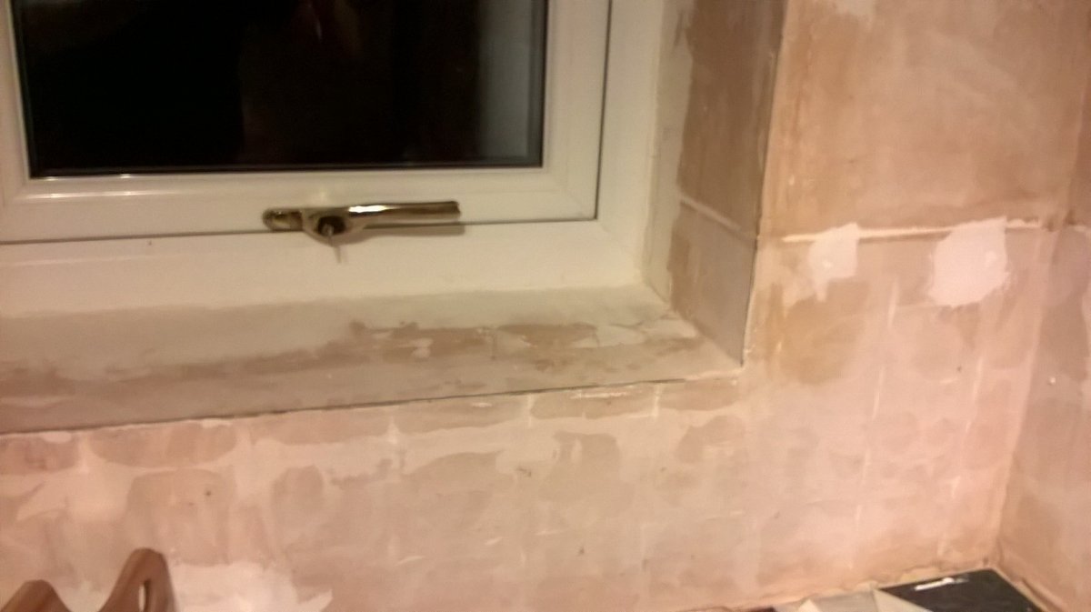

Hi All ,
I hope you can advise which is the best way top proceed with some tiling I have to do.
I have tiled before but just straight walls with no window reveals and I am not sure which way to attach the tile trim.
If I were to use the inverted J shape trim (channelled ,where the tile fits into the groove) would anything change?
option 1 , attach the tile trim (quadrant) to the vertical wall
option 2 , attach the tile trim (quadrant) to the window ledge , horizontally.
also in the corners of the window reveal I take it they are mitred ?
I have attached some pics and a quick sketch in case that helps .
Many Thanks in advance for any help, advice given
Glenn

If I understand your post: then the leg or fin of the trim always stays inside the reveal and the trim itself overshoots the wall tiles..
Set all the trim the same way.
If trim or mitring is not used then the reveal tile always comes out proud and overshoots the wall tile.
Tile up the wall to within a few mill from the window reveal - thus allowing the grout to go in the joint. Then put the quadrant on the reveal, and tile the flat part of the reveal; a grout line here isn't so desperate as you've got a straight line on the tile. Instead of trying to mitre the corners of the reveal, having tiled up to the side wall of the reveal, use a spacer, and then tile up the side of the reveal.
