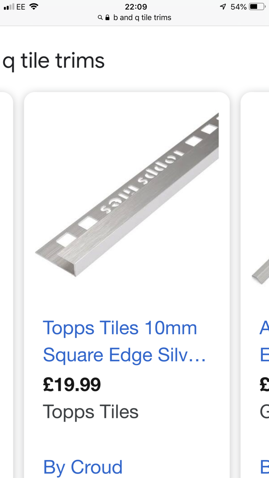

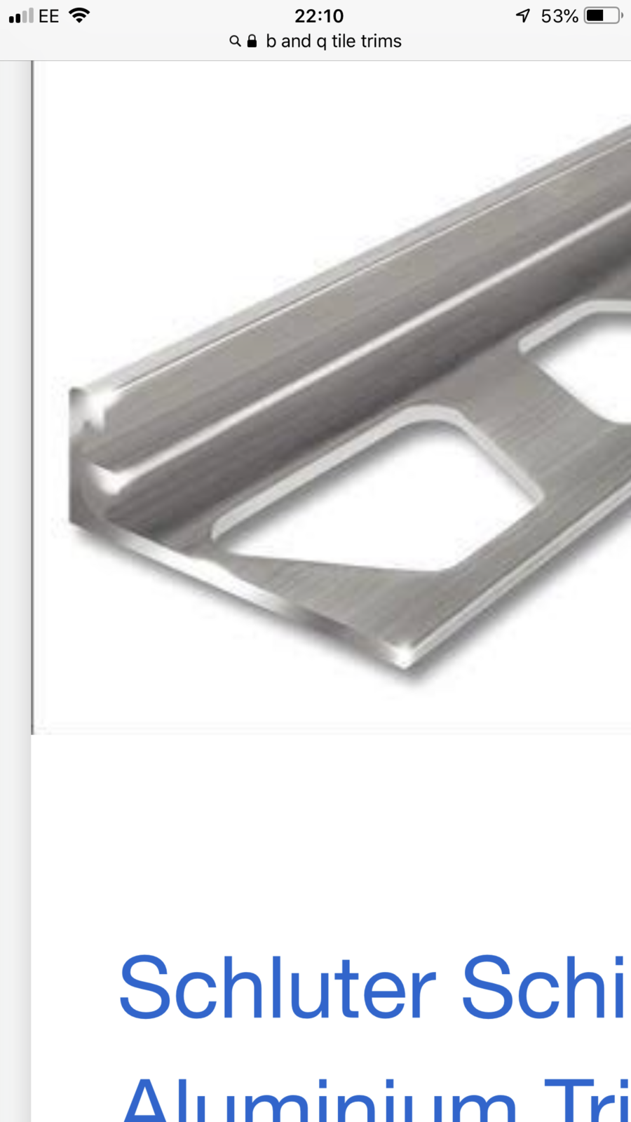

i am looking for a tile trim which covers both edges of tiles and looks good around a window reveal please.
Let me elaborate. My tiles are unlikely to be dead straight around the window edge and my cutter usually leaves small chips on the edge. I am after a tile trim which wraps over this edge and the inside edge too. The metal trims (I prefer white plastic) appear to reveal the tile edges.
How can I achieve this?
I think they will look awful. I’m surprised that there isn’t a trim which has a “lip” across both sides...
It’s not just chips, but my tile edge is also unlikely to be dead straight as some may be a mm or 2 larger or smaller than others. Such a trim would finish this off nicely.
I’ve seen lots with a single lip but haven’t come across one which does both sides.
I’d really appreciate any suggestions
