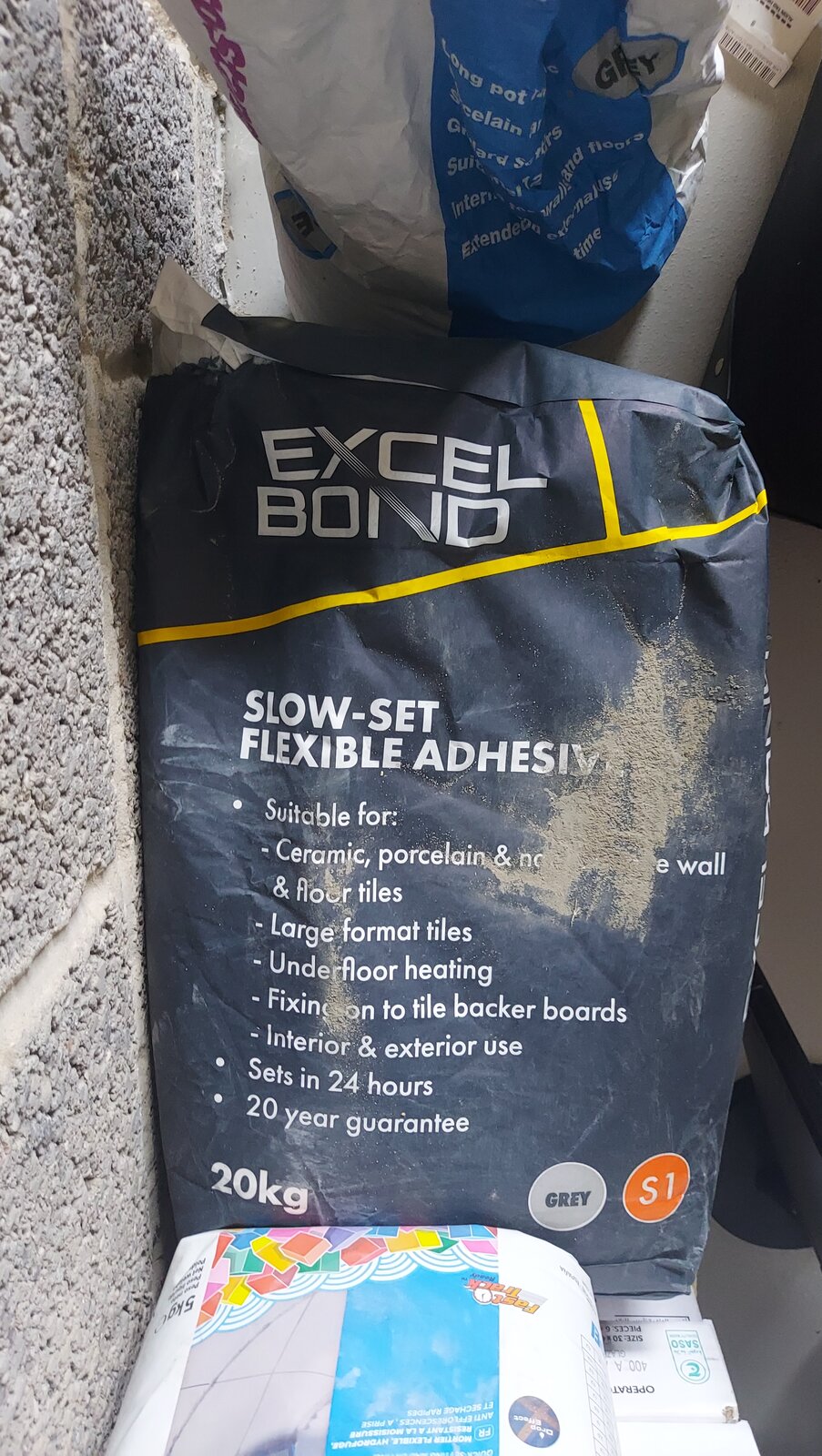

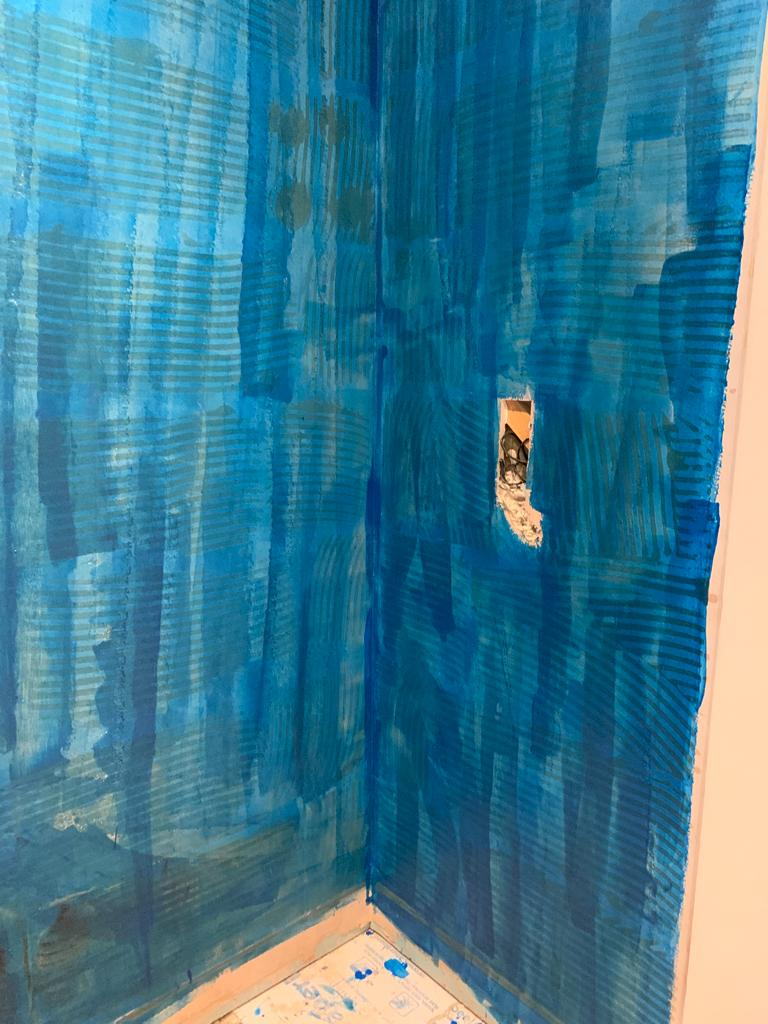

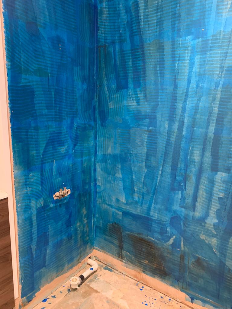

Really? She nearly lost her legs? That's all of a bit of exaggeration isn't it?A previous long term girlfriend nearly lost her legs to a badly built shower wall.. The shower tiling had been applied to plasterboard on studding, then grouted. Getting out of the shower one evening she knocked the wall and it collapsed completely in shards not complete tiles; luckily her reactions were extremely good and she leapt out of the shower when she saw the first tile move.
That one occurrence put me off tiles in a shower for life! I much prefer Shower panelling.
Despite what developers would have you believe, NHBC is really more of a warranty that covers a mortgage providers (the real owners) assets and from something that actually affects the property's value eg subsidence or another major defect. They are not there to provide the homeowner with anything meaningful for cosmetic problems and in any case the excess would typically exceed the value of any works required.Would anyone like NHBC etc be interested in taking action or are they as useless as I keep hearing?
No, the NHBC won't be interested as the builder is rectifying the work under their warranty.Just a quick update on this....
Thanks for all the advice, the tiles are now back on - no evidence of tanking but at least the tiles are actually stuck to the wall so I guess it should last long enough until we decide to replace ourselves.
Anyway, in the mean time it's come to light that another house on the same road has the same issue, which was only found out as they needed their shower tray replaced, so we can safely assume that none of the 14 houses have been tiled correctly in either of their two bathrooms - and possibly the other hundred or so houses on the develpoment.
Bearing in mind the disgusting way weve been treated by the developers/builders over the past year I'd love to cause them some real consequences for handing over houses in a dangerous condition. Would anyone like NHBC etc be interested in taking action or are they as useless as I keep hearing?
