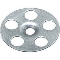

If I’m screwing them to floorboards I tend to get a thin sheet of hardboard down first then put backer board down screwed down but I use these with the screws, designed for plasterboard but never had a issue
