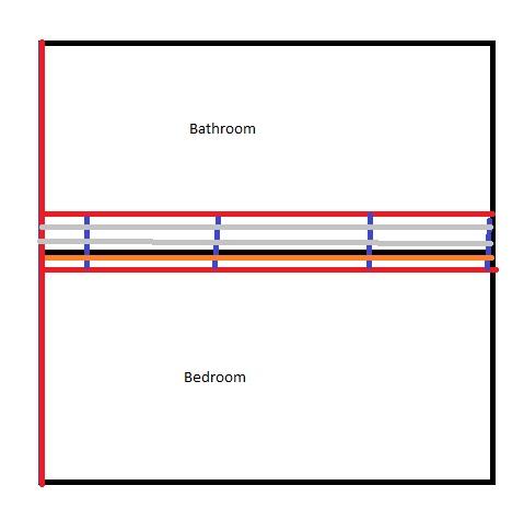

ok, thanks for your advice but it would seem i'm going to have to remove the floor boards anyway. After some more investigation to cure some of the squeaking in the floor boards it turns out there are a few boards that have been cut in half that's not resting on a joist - it's just the T&G that's holding it in place. :shock: :(
Going back to my original problem, if i was to lay noggins going under the wall to the other floor what size would i need to be able to cut two 1 inch notches out of them (for the two 22mm pipes)?
I then intend to cut another 1x1 inch notch out on the side of the noggin that's in the other room to fit a piece of wood 1x1 going 90 degrees to the noggin so that the bedroom floor boards can then lay on this. Please let me know if this sounds ok?
Please see the image attached for clarification.
Red indicated the current joists.
Blue indicates the noggins i intend to put in place
Grey indicated the pipes
Orange indicates the 1x1 piece of wood for the floor boards to lay on
How are the joists supported either side of the room? Why cant you just stick in another full with joist supported on joist hangers instead of all the noggins & 1 x 1 bearer which won’t offer much support anyway. As it’s so close to the wall, it will only be lightly loaded unless it’s where one of the bath feet ends up so doesn’t necessarily have to be the same size as the rest of the joists.
On the left side of the picture there is a wooden support going down the length of wall that supports the joists. I'm not sure where the other support is - it's not in the room. The room however is only 1.7 x 2.1 so i imagine the other support would be a distance from this room.
As for why i can't put a joist in, it mainly down to the joist would have to go where the pipes are currently running and also i'm not sure where the other support is. I don't want to have to pull up the landing to find it.
As for the 1x1 bit of wood not offering much support - there will be a joist 5cm away from it so i imagine that will offer most of the support. The 1x1 was just intended to nail the end of bedroom floor board in to.
Please let me know what you think.
You could fit a noggin between the joists at the unsupported end to take a joist hanger, fit a joist hanger to the support on the left hand side of the room & fit a new joist.

Once again thanks for your reply. Can i just check though if the idea that i came up with is not an acceptable/safe way to do this or if improvements can be made to it to make it suitable e.g. if 1x1 bit of wood isn't ok, to use further noggins going along the length instead?
Your idea does certainly sound like the best way of doing it if i had the budget but i haven't got the budget to get the pros in to move pipe work etc. I'm also not sure how the wall would be supported while this work is being done as i'm going to have to remove all the floorboards at once rather than just doing sections if i was to use noggins. I'd also have an issue (that i missed on my diagram) in that the soil stack is in the way of the support on the left so i'd have to implement another set of noggins there.
Please note that i will be using 25mm ply if the noggin method is acceptable.
I'm also not trying to get out of doing the job properly - it's more a case of deciding if i can go ahead with the project or not.
For the amount of hassle you are going to be up against, I would lay a vinyl floor such as karndean or Amtico.
