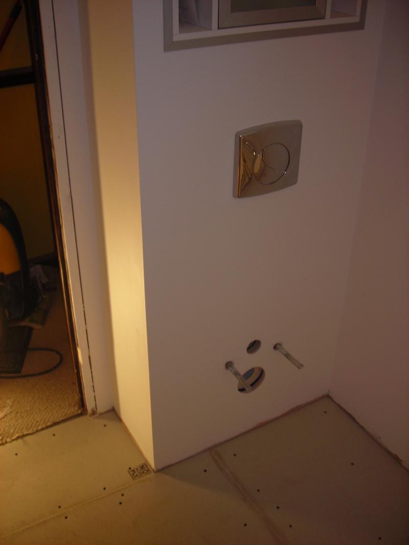

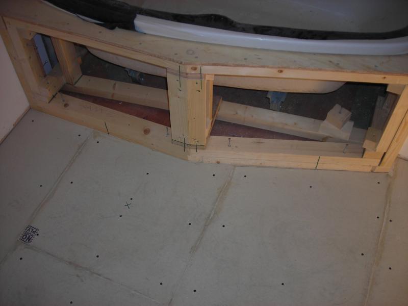

I also made the same mistake by laying 22mm MR caberboard after ripping up the rotten chipboard floor in my bathroom and kitchen. :(
I did consider ripping it up and replacing with 25mm ply after taking advice from gcol, but i had already replaced all the pipework and waste and due to the many popups through my floor and the small size of my house (maneuvering large sheets of ply) I opted to get nomoreply delivered to overlay. This product is 6mm thick is glued and screwed down, is water resistant (not water proof) so if you are laying on chipboard the supplier recommend 2 coats of BAL APD. As you can see from the pics I am not in a position to tell you if this is a good product yet but here is hopin.
PS the screws nomoreply supply are self drilling and in chipboard they tend to chew it up and not pull down enough. I had better success with gyprock screws. :)
I did a lot of research after discovering my mistake and the general concensus seems to be. don't lay tiles directly on to chipboard. Apart from the grout cracking, tiles and grout are water resistant not water proof, so there is a chance the chipboard will get wet. :(
There are other manufacturers of similar boards but when you read the instructions, this one seemed more straight forward to me.
