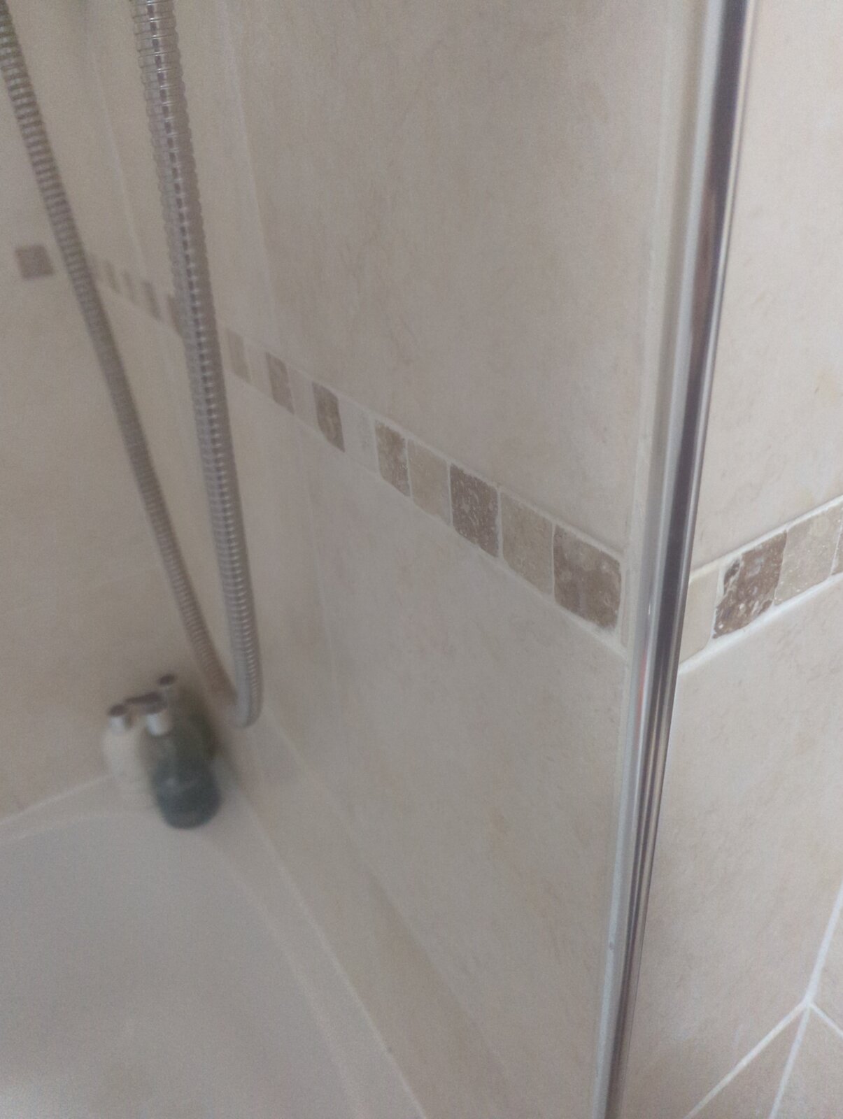

I just used tile sealer on plasterboard in my shower 20 years ago and still good.
I didn't know any different at the time..
I just filled joints with whatever I had. Sealed with BAL sealer and white star adhesive.

Bal tile seal the plasterboard.
Tile
Grout
I never sealed tile grout
2008 Ish I guess.
This picture is today
2008 Ish I guess.
