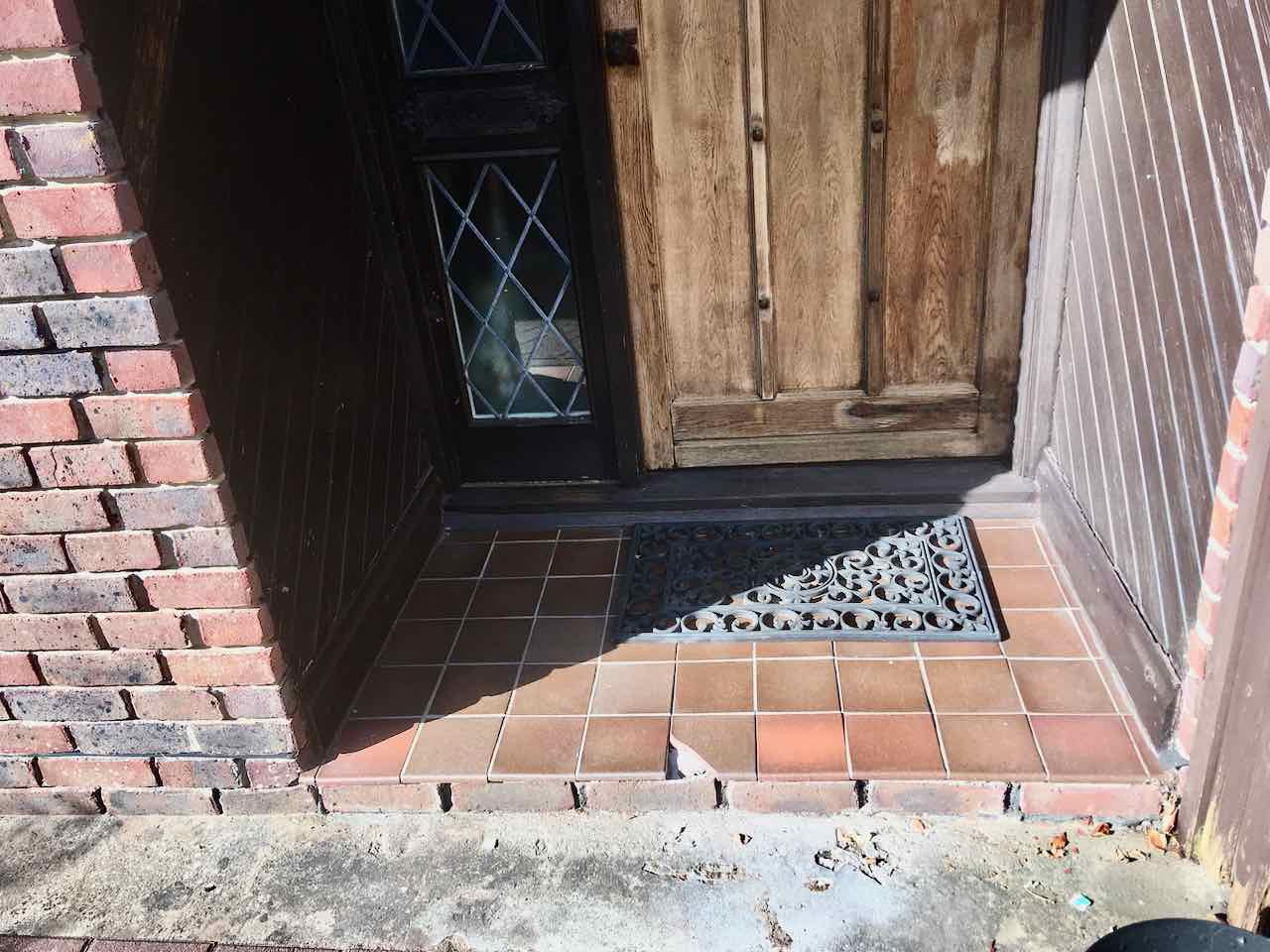

Our outside porch tiling, which has been in place for over 25years (mother-in-law lived here before we purchased)
When it rains water always stays in the top right corner , quite a pool, brother-in-law sealed it all up years ago, so now I'm about to rip it all out , start again and also lay the tiles so they slope toward the path and not towards the door.
been a long while since i bothered to tile anything
The porch is West facing , and fills with leaves and rain all the time.

Tiles are 145mm across the top , so probably 150mm with a taper
I broke the tile yesterday hoping they may all come up and i could just relay, so now the jobs changed to a complete strip and start again, for the entire thing!!!!!

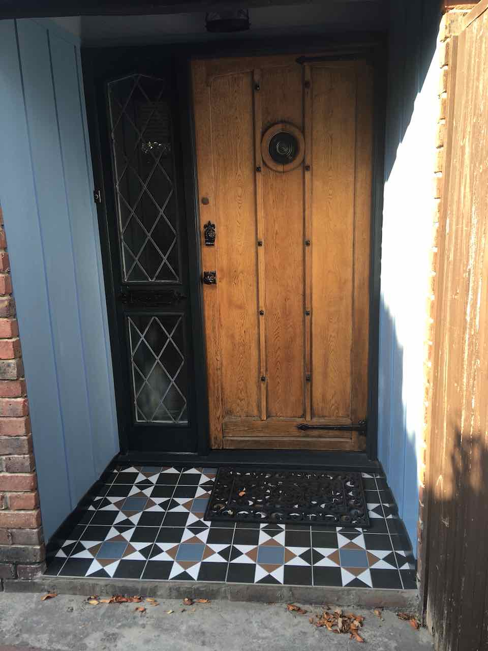

image as promised
It looks good, bright and welcoming, and pattern matching the glazing cames.
Thing is, just a possibility but you've left a raw unprotected edge, and there's various kinds of protective metal edge trim for just that finish.
all the edges had 3 coats of dulux opaque paint and also I sealed with hyppo Pro3 all along the brickwork. so i hope i didnt miss any
whereabouts in case i have
Or do you mean the front of the tiles
We did not know what to do about that edge.

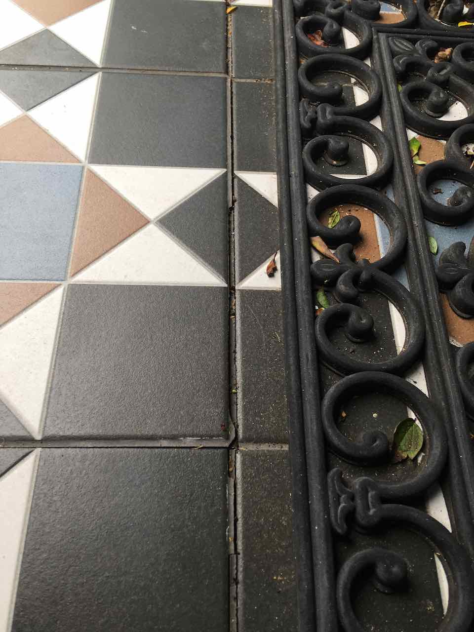

bad news tiles are lifting, noticed in Sept that the grout had cracked, and now today the tiles move!!!!!!
no idea what went wrong
I'll lift in spring and see if i can see anything, meanwhile any ideas
