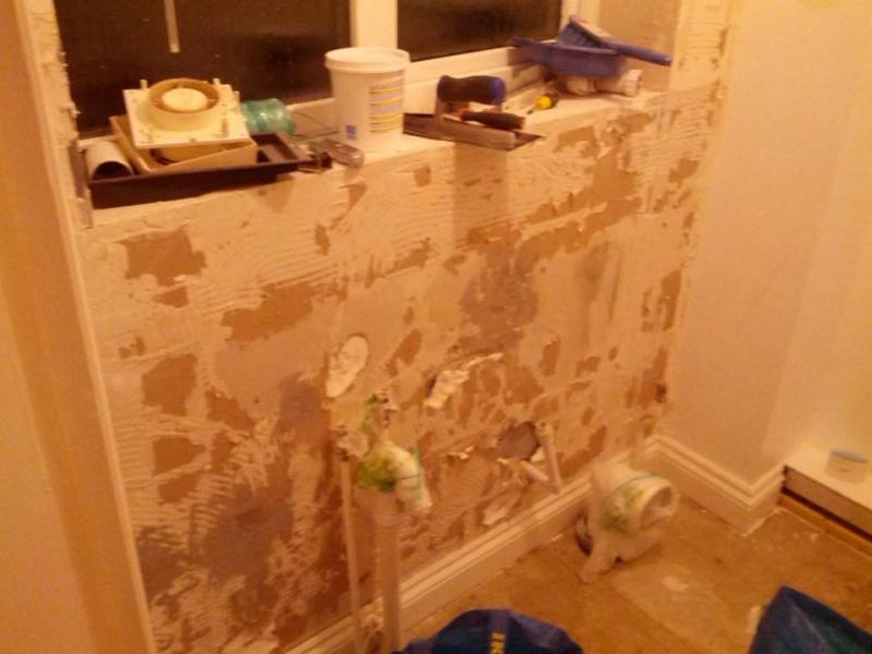

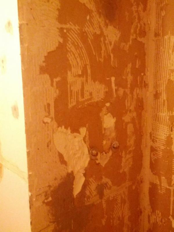

The first baffling problem I have come across happened when I removed the tiles in the en-suite. There were tiles on a large splash back area and in the shower cubicle. Where the tiles had been split to fit badly around pipework coming through the walls I think they had been adhered with an insane amount of tile adhesive. After 15 years these few tiles were very difficult to remove from the wall and left some damage to the plasterboard. There is a patch on the splash back where there is a football-sized hole. In the tile area there is an area where the paper cover on the plasterboard had pulled away and some of the plasterboard has crumbled.
So I have a couple of questions. I've looked on the internet for answers and there are plenty. Unfortunately they're sometimes contradictory and I'm left a bit baffled.
So my first question is this: for the hole in the splashback plaster board, can I just cut a new square, and fit some wood battens behind it and tile over the lot? Is this a good idea or will it not be strong enough? These will be standard 30cm glazed ceramic tiles, so not too heavy.
My second question is: Can I just fill the crumbled section in the plasterboard with some deep filler? Will the tiles adhere okay to this? And will it be waterproof enough? Or is it better to bite the bullet and pull off the plasterboard in the shower and replace it with aquaboard? Of course this will inevitably lead to some more questions . I want to do a good job and not have it leak or go mouldy in a few years.
Here are some pictures. I would really appreciate any advice you have to offer on preparing these walls for tiling?
