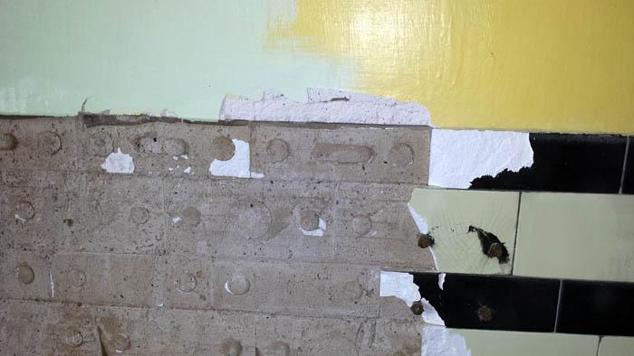

I am about to start tiling my bathroom. It hasn't been done for many years and has tiles half way up the walls. The current tiles must be 40-50 years old and are rock solid and very flat. They are stuck to old fashioned plastered brick walls.
I have given one of the tiles a decent whack and it wasn't for shifting. Is it possible to tile floor to ceiling over the old tiles. How would I overcome the step half way up. The step is around 7mm.

The tiles were ceramic and I have taken a section out to have a better look. Looks like the wall will have to be replastered in some shape or form as there is no a step the other way between where I took the tiles off and the plastered wall above.
Any hints and tips and what to do next. Get plasterer in to skim or put some new plasterboard on. Here is a photo to give a better idea.
Looks exactly the same as my bathroom. I ripped the whole thing off and replaced with tile backer board. The raised cement render that the tiles were on was very well stuck to the walls but the plaster above was old, blown and almost fell off - no good for tiling on at all.
Depending on the weight of tiles, you might be able to dot and dab moisture resistant plasterboard. If they're too heavy (>32kg per m2 incl. adhesive) then you'll need tile backer boards not plasterboard.
Two of my bathroom walls are external, one solid, one cavity so I've added internal Celotex to help with insulation. Tile backer is fixed to battens and with the Celotex between the battens.
