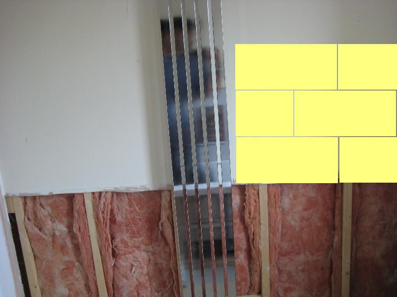

Sorry I should have made myself clearer, ok let me start again...Pictures always help don't they? Let me try explain by pictures:
So this is what I call wall number 1, I think this is the wall I should start with. As you can see I have placed my digital tiles onto it so you can see what I mean :D note the cut tile in the bottom right run.:
This is wall number 2, note you can see the rad from wall 1 in this picture so you hopefully understand where this wall is. The cut tile offcut is the one I continue with on this wall, is that the right way to do it? Or do I have to start from the middle of this wall like I did on wall 1? (PS you were right! Drawing it out helped me to see I'm doing something wrong here as the patter isn't working right :LOL: :
This is wall 3, this wall follows on from wall 2 and is opposite wall 1:

i very rarely start from the middle of any walls to be honest, but i guess its each to his own, i measure the wall work out how many tiles go across then see if the edge tiles are an acceptable size, i.e. not 3 cm i like to make sure its going to be there or there abouts half a tile if poss.
also looking at windows to see if your going to get a sliver there too, easily avoided with a few mins ground work. then whack em up.
using the bal 1 meter up is more than adequate around the bath area, where the shower is just go up a meter or so, no need to go right to the shower unit, if you think about it you dont face the unit to hit the wall directly 5mm under the shower nozzle do you?? im sure im making sense if not let me know ill try again!!!

Sorry, I started the tiles in the middle of the wall because I didn't want to digital-tile over my rad that digital adhesive is a** ache to get off shiny surfaces :LOL: I'll start in the bottom left corner. So if I understand you right all I do is complete one wall, then carry on the pattern round to the next wall? When I'm measuring up what'll happen if I end up with a sliver tile on the next wall, should I just shift it all along a bit from the first wall?
treat each wall as an individual, so dont follow round with the tiles.
do wall 1, then start on wall 2 afresh.
You’ve already got good advice on the tile layout but, personally, I think them’s rather large tile to be “brick weaving” & get to look right. Whatever; always do what looks right &, as jefoss says, treat each wall as individual. Get them to match as best you can but concentrate on the wall everyone will see as the walk into the room; get that right & no one will notice the rest unless they are either lying in the bath or sitting on the bog without a news paper & nothing better to do.
