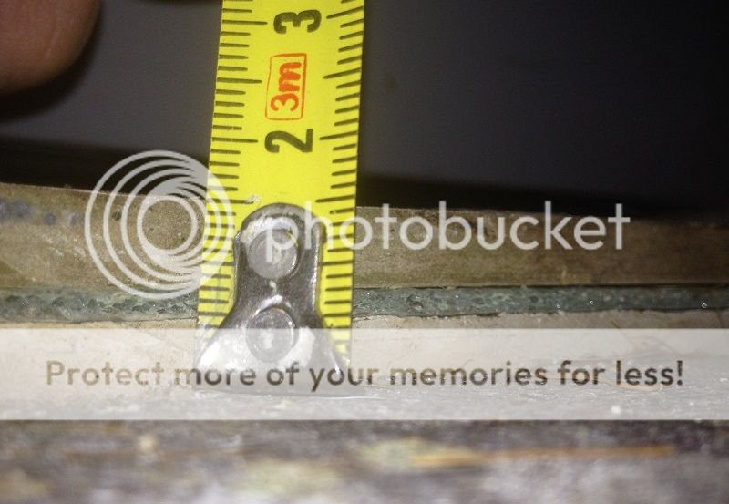

The base floor appears to be chipboard floorboards (with a brown painted layer on it) above a concrete base with insulation between as per photo below:

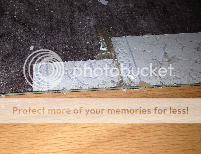

Laid on top is two (yes two) layers of vinyl tiles and then laminate wood flooring on top of that as follows:
Total height of all these current floors on top of the chipboard is 15mm as below (and roughly aligns with adjacent carpeted rooms.

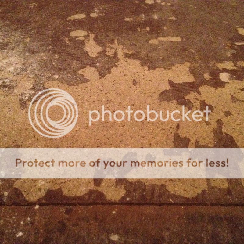

Pulling up the vinyl tiles takes the brown 'surface' of the chipboard as follows:

My initial thoughts are:
6mm insulated tile backer board nailed onto the chipboard to provide a flat insulated surface.
3mm for the Warmup underfloor heating system
That gives me 6mm for the flexible adhesive and tiles without raising the height above current level.
Does this sound sensible?
Questions/thoughts in my head:
Do I need the insulated tile backing boards as floor is already insulated?
If I do use the tile backing boards should they be stuck to chipboard with adhesive (depending on manufacturer some suggest adhesive others say to nail to existing wood floorboards) - don't want to add anymore height?
Any clever ideas to lift the existing vinyl tiles easily (its been a complete **** to do a small trial area?
