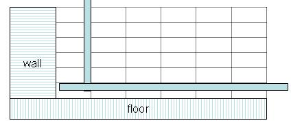

Another question... re. baton placement.
Below is a crude view of how i intend to place the batons. I will start tiling at the bottom left hand corner...moving outwards.
From the many sources/how to guides, i'm a lil confused. Some guides suggest having the verticle baton in the centre of the area to be tiled. Some suggest having both the horizontal and verticle batons in the centre.
Is there anything wrong with my approach?
I don’t usually bother with the vertical batten; starting in the corner can throw you out as you move up the wall if it’s not been set to a dead 90 degrees from the horizontal batten. I set the 1st tile row from a centre datum & then tile out subsequent rows from the centre using the spacers to keep it all true. Similar principle to fixing the battens in the centre as it effectively divides any likely error build up in half but it depends on the size of the wall & tiles you use; cheap tiles can also be a problem & throw you out. Ensure your battens are perfectly straight or, again, it’ll throw you out as you move up the wall; I use a couple of sturdy aluminium billet strips + a selection of power planed hardwood battens I know are accurate.
