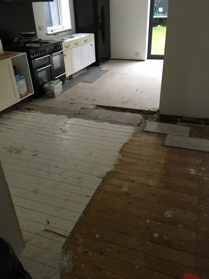

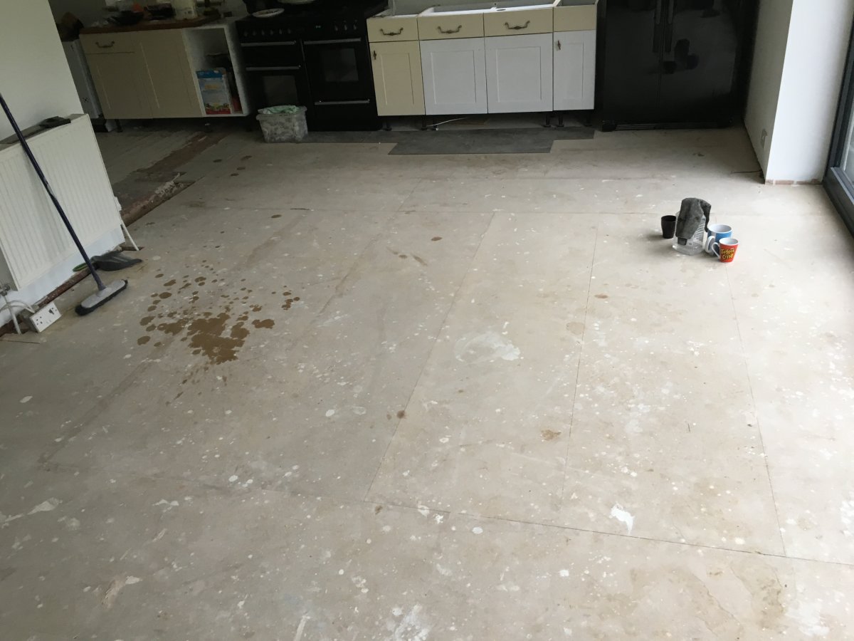

Hi people really need some help I have just done a extension on my house and wanting to tile the floor, the extension has a floating flooring with 80mm celotex and them 22mm tg then when it meets the old house the floor is suspended with normal 18mm floorboards my worrys is I can't tile straight onto the floorboards? The floor levels are the same so no room to overboard the floorboards. Any input would really help me.

Hi thanks for your reply yes that's all correct and the celotex was laid on to concrete.
My concerns are the old floor will have to much movement in it and over time tiles will pop. My plan is to tear up the old floorboards and replace it with 18mm tg glued and then add some noggins between the joist.

If laid on celotex, the T&G boards - any boards or sheets of c/board or ply - will move.
You cannot tile over a moving surface.

The floor was set out this way in my building plans the floor is solid on top of the celotex. The 22mm is tg and all glued together making it one.
What's my best options from here?
I would be more concerned about the movement in your new floor, and personally wouldn't take the chance of tiling over that, even with fastflex or tilemaster ultimate.
Extra noggins will have very limited effect on any flex in the old floor.
The floor structure you have in your extension is becoming more common as its cheaper to install, but is far less solid
Thanks for your input I think my only option is to go for a laminate floor the set up I have in the house just doesn't suit a tiled floor.
Don't understand why you dismiss over-boarding, if floors are same level then it's ideal.
The room in total it's a near 90m2 so was thinking about the cost and also the step it would create to the other rooms leading off it
