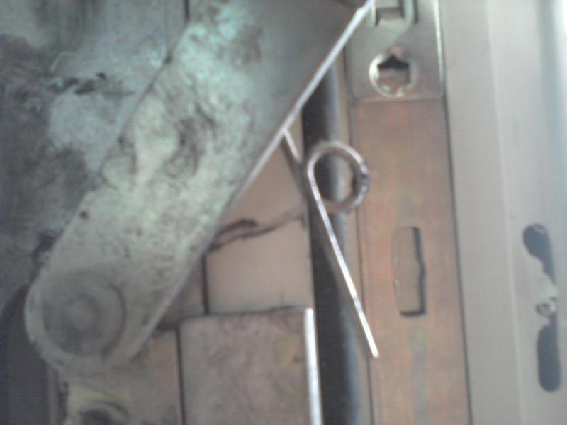

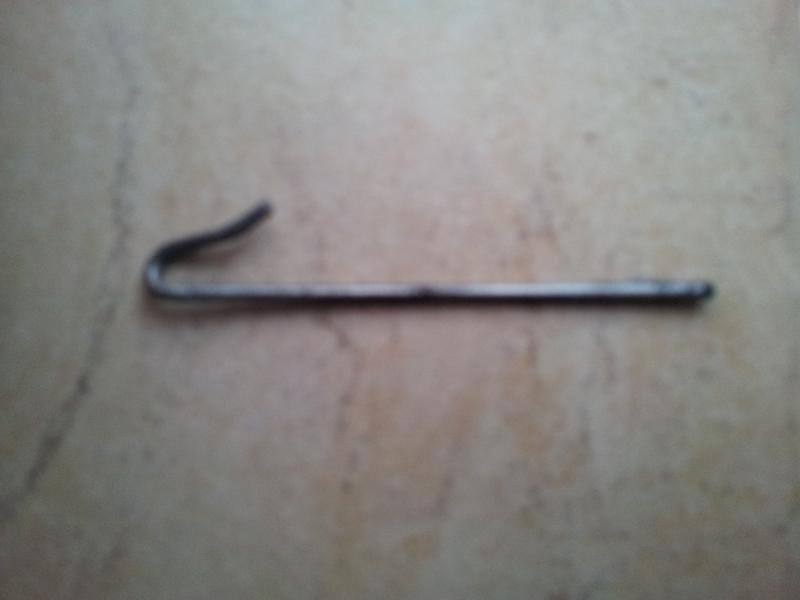

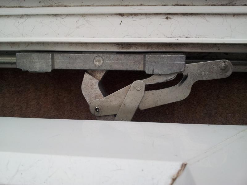

I have had a tilt and slide door for a number of years now but a bit seems to have fallen out and the door doesnt catch when you pull it open and so can be a pain to close it especially as the kids are in and out through it all the time.
As you can see from the photos, there is the pin, the spring that must have something to do with it and the mechanism being held open.

Don't tell me, the door flops back against the frame and won't click and stay open, tell me i'm right? :D
Inherrant problem with tilt n slides, the spring has snapped, you'll need the make of the locking mechanism, a common one is SI Siegenia but there are others, look for markings on handles or on the lock mech itself, then you'll have somewhere to start, you can buy the springs off the net as i've done one before but i said i'd never ever do one again.
To get access to the spring and bogey wheel set up just slide the 2 end caps up and prize off the aluminium cover plate, once on your knees you will see wheels, levers, springs (or lack of ;) ) and all sorts of other gubbins
Good luck, you'll need loads :confused:
It is a 10p part that has failed, to understand what where why and how just kneel down on the outside of the door and gently slide it shut pushing it inwards with a tiny bit of force, just as it would of been if still working, when nearly shut you'll notice in the bottom corner there is like a cupped striker plate which should be right at the end of the runner, when the door gets to this striker and connects it releases a lever on the bogey wheels and the door, under its own weight flops into the opening, this is the lever that the springs joins to and it holds the lever under tension in a certain place, in a little cut out, when its held there the door will glide sideways all day long but if the spring snaps (and you have bits to say it has) the lever is no longer held under tension, comes out of its little cut out and allows the door to flop against the frame as it thinks its in the right position to do so
