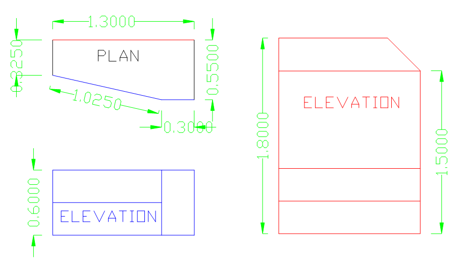

b) a corner unit, bottom 900mm c. 1.3m x 0.7m above that l shaped shelves 300mm deep probably 3 shelves for books and nik naks.
similar to the image but with straight front

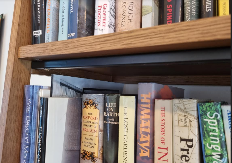

What I do quite often is reinforce the front edge of a thin shelf with 1/2" square steel tube. Painted colour to match or even recessed it is virtually unnoticeable
