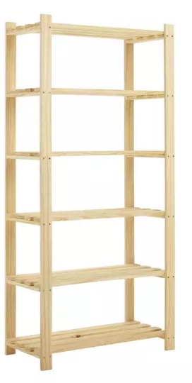

Neither are cupboards. Neither are larder units. Both are just open bookcase/storage units with shelves supported of vertical timbers and occasional horizontal supports a bit similar to the attached but strong without overkill.

Thanks still don't know what size timber would be suitable for uprights and top, middle, bottom horizontal supports
what you saw in ikea will work for the uprights; it is strong in the direction that matters for the forces it will experience. For the horizontals you'll need a thicker section to go the proposed 1300mm or reinforce with metal bar as proposed. Personally I'd use thinner section and have an interim slim vertical support

Thank you. What size sections would you suggest
30mm+, depending on the weight of what you plan to load on them

Thanks. More interested in the bow of uprights
for a given timber size used for a shelf the sag is proportional to the cube of the distance between supports, so going from 1 metre to 1.3 metre spacing gives (1.3)cubed extra sag. So would give more than twice the sag. Mr Rustys answer would help you use a thinner shelf without the sag. Even just reinforcing at the back would make quite a difference.
