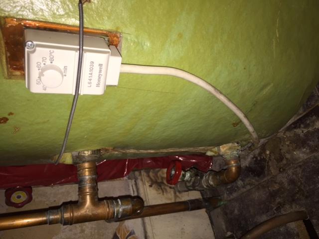

The HW tank was completely emptied this morning so I thought I'd check it's progress on heating up again this afternoon. After 105 mins of the boiler on at 70c flow temp, the copper cylinder measured around 40c under the tank thermostat. Pretty slow huh, or is that about right?
I expected more contact between tank and stat to be honest but it's just conducted through the metal frame that the stat is mounted to, held in place with the tensioned chord around the tank.
I'm guessing as it's copper that the temp of the tank will be as near as damn it to the temp of the water inside? If not, should the tank thermostat compensate for the difference?

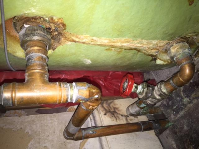

Post a pic of the cyl stat position and the flow/return pipes position.

There is an appreciable difference in temp on the flow and return when the HW heating cycle first starts but after around 10 mins they are fairly close. I've managed to get a bit more of a temp drop by closing the return valve to 1/4 turn open (it was jammed fully open before).

Some photos, dunno why they are all in landscape view after I upload them:
Cylinder stat
Flow (top) and return (bottom) pipes)
Stat and pipes so you can see the relative positions
