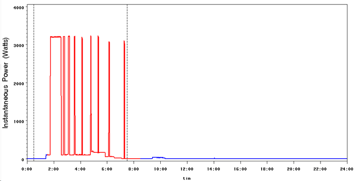

I assumed it would heat overnight "for however long is set on the timer'. I'm guessing this one just maintains a temperature and turns on/off as required but not sure if that is efficient.
As I said, it can't heat continuously for the whole night, since the water would then boil -that's why there is a thermostat to switch it off when it gets to the desired temp (and back on again if/when the temp of the water falls). The following shows a typical day of my immersion. Power to the immersion is switched on (by a timer, just like your one) for the 7 'cheap' night-time hours (the red parts of the graph). However, as you can see, after about one hour, when the water vis 'up to temp', the thermostat switches it off, followed by just occasional brief bursts of re-heating as the water cools down.
Kind Regards, John
That's what I assumed this one worked like, but seems to be on without the timer so I guess it just maintains the heat throughout the day controlled by thermostat..

Would have preferred your system to keep costs down.
It ought to be easy enough to have it changed so that its does behave like mine - basically just a case of feeding the water heater from the same (timer-controlled) supply as the storage heaters.
In another flat I just had the timer set for two hours in the night and it gave enough hot water in the day.
As you can see from my graph, two hours is probably enough on most days - although it might take a bit longer than that if a lot of hot water was used during the previous day. However, as I've said, there is nothing much to be lost by having the water heater 'on' (by timer) for all of the cheap electricity period -the thermostat will then make sure that no more electricity is used that is needed to 'keep the water up to temp'.
