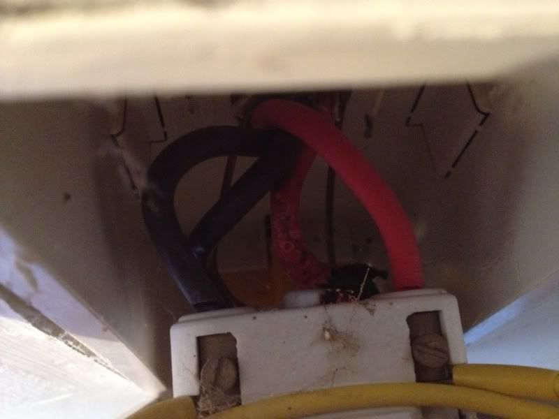

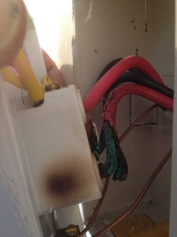

Shower isolator: (had been used that morning.)

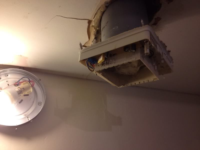

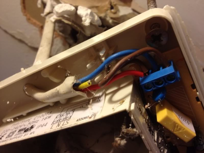

Fan in bathroom: (when the cover was removed water had pooled up and flooded out!)

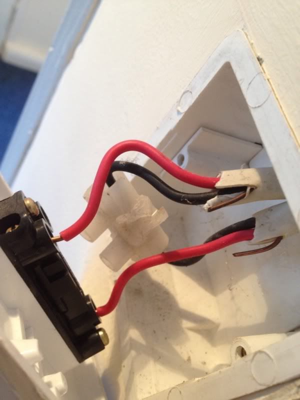

Lighting taken off ring main with no fusing down either.
