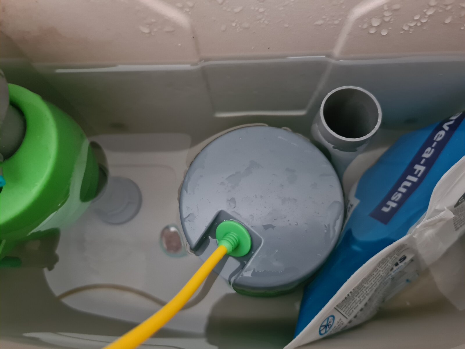

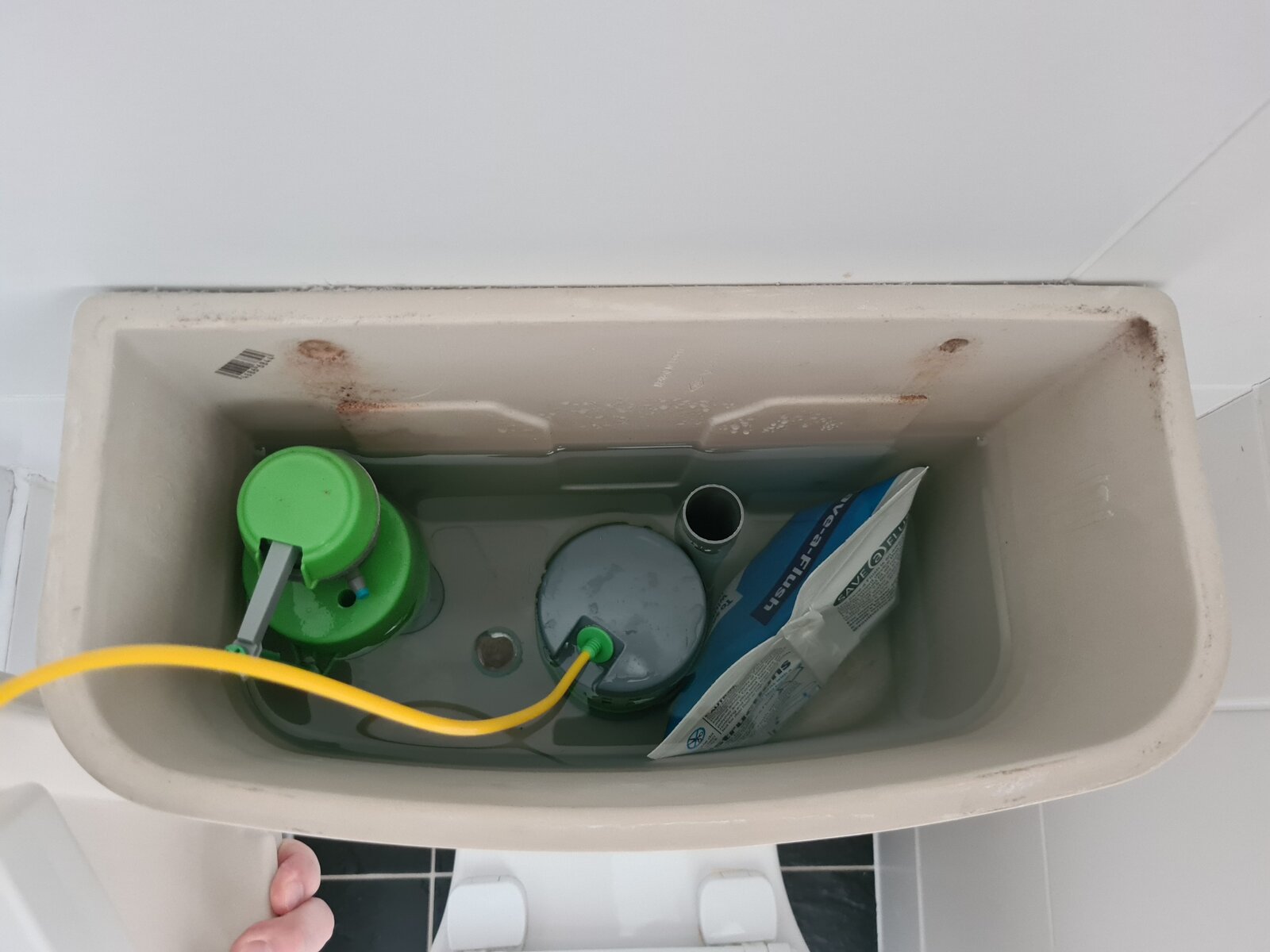

Toilet flowing without pressing flushing it
10 Oct 2014
201
3
Sussex
Hi expert DIY

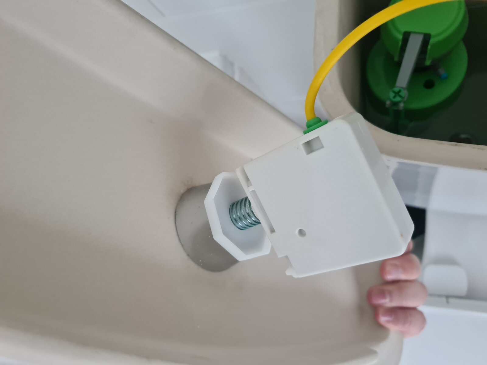

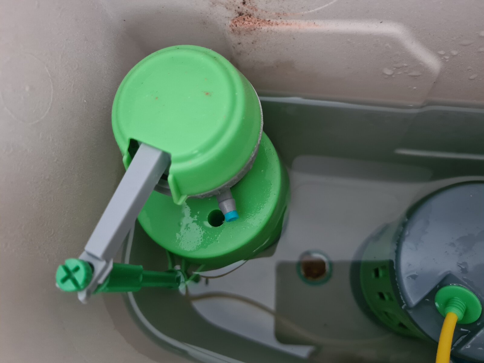

So every so often, when washing machine on, shower on or for no reason, the toilet start to overflow / leaked for no reason which over Xmas end up is quite a fair consumption when I was away.
See picture of current set up.
Anything that is going wrong there? or could be going wrong that I can fix myself?
Many thanks

Cheers thanks for the feedback
by changing the float valve, do you mean the unit to something new like:
Or do you just have to change any washer that is within the valve if any?
Many thanks
Change the complete valve ,either of the above and preferably one with a brass tail.
Plastic tails are prone to cross threading too easily.
You could try servicing Your existing valve ,but I would just fit a new one.
