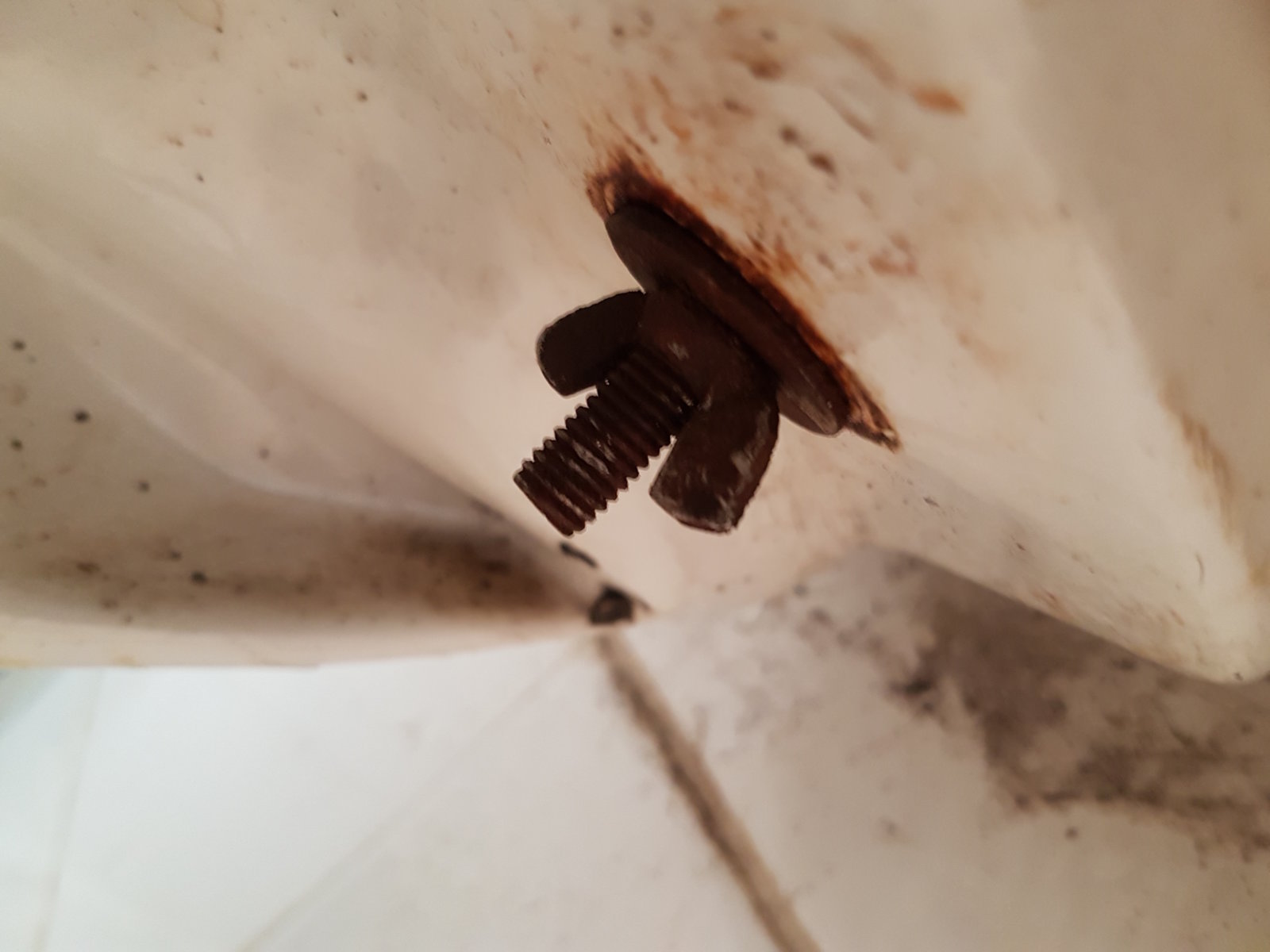

I managed to get the right part.. but have run into the problem of rusted nuts/bolts. I have to take the cistern/tank block off as it is attached to the toilet. I have tried spraying wd40 etc on it with no luck what else can i try?
and the public moan about how much plumbers charge per hour, welcome to their world
the thread does not look in too bad a condition , so with a suitable pair of grips and a liberal soaking of WD 40 it should undo. on some cisterns the head of the bolts are visible inside the cistern so you can try to loosen from above. others have the bolts concealed in between the cistern and the pan and are not visible .a last resort would be to use a hacksaw ,but its very awkward to do.
thanks but one of the bolts, the whole bolt actually turns when i grip it and try to turn the butterfly nut. Would getting hold of a angle grinder make it a easier task. the toilet is in a small area so limited area to get hands in and saw backwards and forward?
is the head of the bolt accessible inside cistern ? I wouldnt fancy using angle grinder ,but if you are confident you can do it safely ,without damaging WC ,or yourself ,you could try.
would trying a blow torch to heat the nut be safer or more likely to damage the toilet?
You can do it with a good quality blowtorch, but not if the flame spreads too much; I've never brocken a cistern, but have had to resort to the angle grinder if it's been too rusted.
