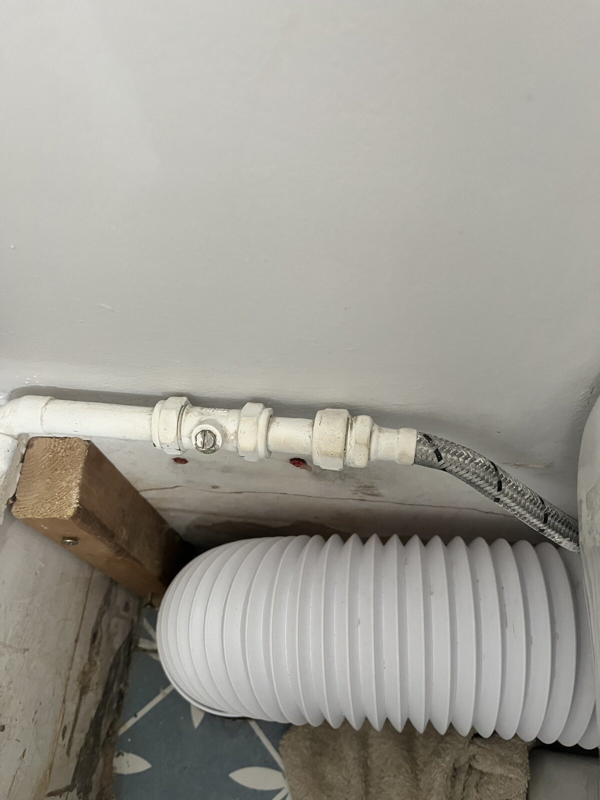

Sorry if stupid question.
How do I detach hose (see photo)?
It doesn’t seem to be a push fit fitting?
Turn the isolator off and unscrew the nut which someone has painted which might make it difficult to unscrew.
