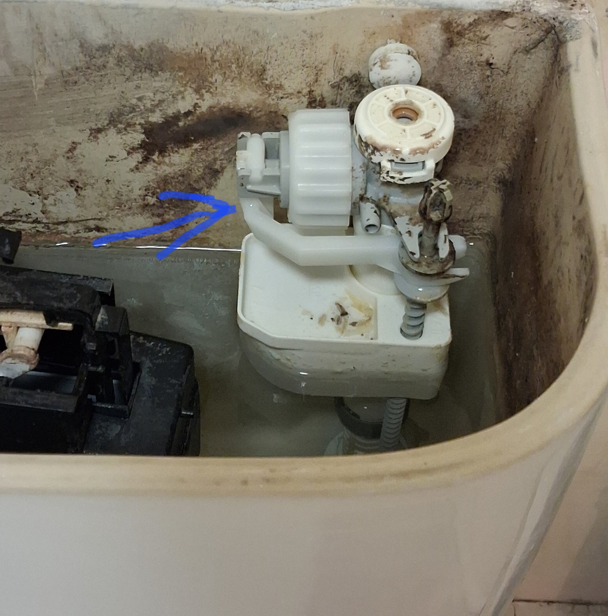

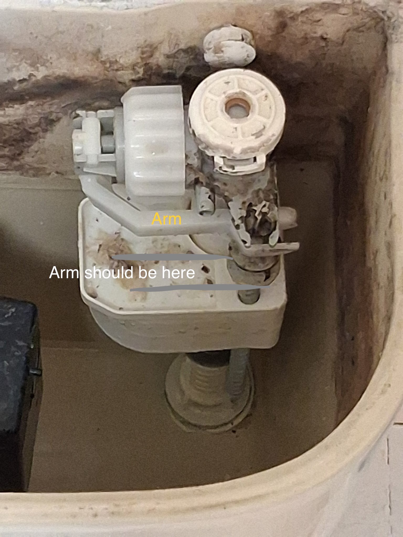

Hi, yes that’s the one. Apologies for not mentioning it. I used to come across this often, you have the prongs of the arm from where the washer is too high. Have a look at your original photo for clarity, but I’ve added a photo. Unclip from the lugs, feed arm into lower part to move the float up and down freely and refit lugs.Hi do you mean the fill valve?
