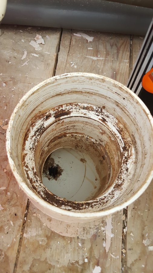

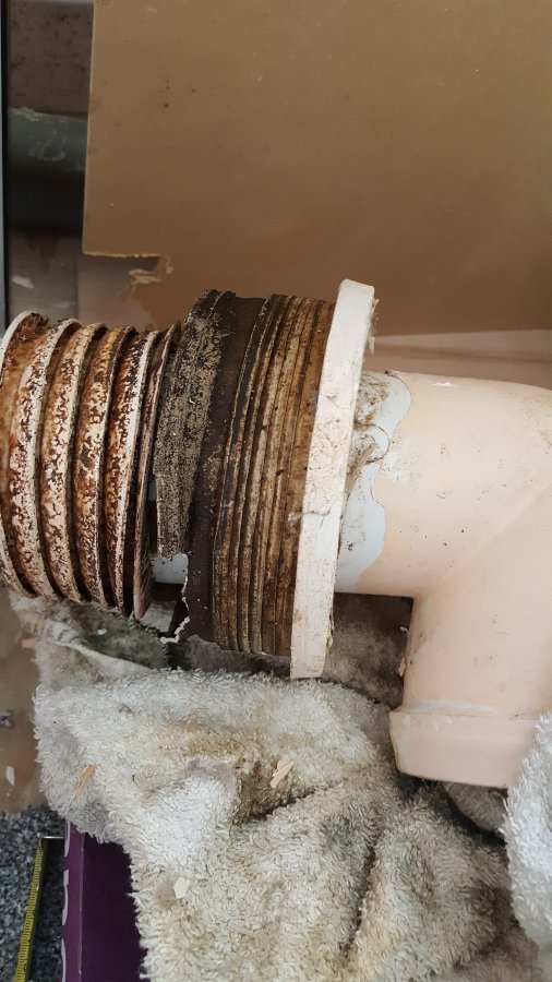

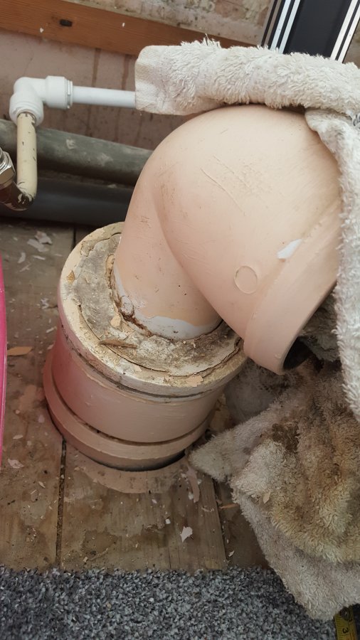

Hi everyone I was wondering if you can help me, do you know what type of pipe this is as I have bought a new toilet and I need to buy a pipe.

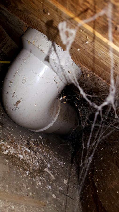

Underneath the floorboard
110mm plastic soil pipe. Standard size. I would replace from under the floor, fit a new bend to bring it up through the floor then new pan connector. Nothing you have there is salvageable.
I won't be able to take off the bend but could I just put the pipe down there
